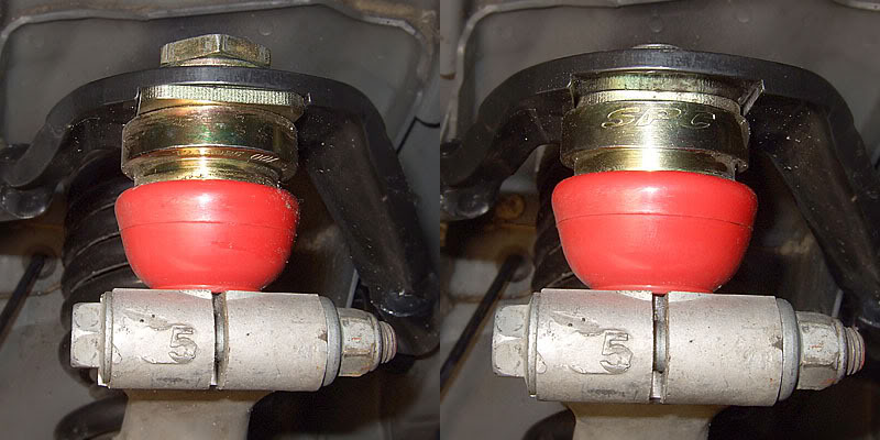

I showed this thread to my alignment shop guy and he said that beside camber is way too off i also have caster issue, which he said is not adjustable. he said that only two options can cause cambers to be negative, that is, the strut is bent or that side of car suffered accident, causing spindle to be like \ <--- this.
This WAS the vital piece to the puzzle^^^~
More than likely the coilover/camber kit installer either didn't read the instructions or just assumed the camber arm was OK as long as the ball joint was in it's cup and didn't think about the caster plate orientation.
It's been so long since I installed them I can't recall if they were already loosely assembled or all the parts were just in a bag
It would appear the right side caster was setup OK and the left was assembled w/ the caster plate already setup too negative.
Since the alignment guy didn't know the caster was adjustable he was right to assume damage to the suspension or body had occurred. Obviously they've never worked w/ SPC arms on Nissan/Infinitis or they didn't read the instructions either.
But this is good news OP
Also be sure your SPC stamp is showing like the pic on the right

blnewt you are always so thorough and helpful. Just want to clarify that positive caster is... FRONT / REAR. So it seems your driver strut is leaning more towards the rear, it will result you with more positive caster. And just wondering... if your car had offset frontal impact, shouldn't you get lesser caster like this l or even \ ?
Aside from the possible backward installation and assuming the A arms and coilovers are brand new, nothing to be bent and getting close to factory spec should not be an issue. If after rechecking everything and still have problem, then next thing to check would likely be your lower control arm. Also please note that if you got the rear toe kit, the bolt slot will need to be elongated for a wider range of adjustment.
Thanks blnewt !! i will show all these images to installer. i am pretty sure this will solve my issue completely.

Thanks blnewt, i am going back to this shop on monday so he can fix my caster. both of my casters should have same number right? say 4.5 on both sides?

Also like you showed up top about the spc logo showing outward, even after caster adjustment, wil it still show outward?
Yes, the SPC logo needs to be outward, it's just the position of the ball joint that will change in its' mount. Just get the caster close and as balanced as possible from left to right, even if it's at 5, as long as it's close to 5 on the other side that will be fine.
