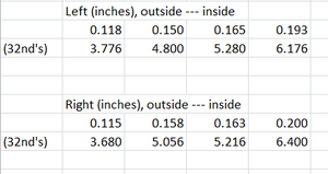

I recently swapped the summer tires back on and am noticing uneven tire wear on the rears.
The car was bought new, these tires now have ~13,5K miles on them. The outside's appear to be wearing faster than middle/inside. Don't feel any feathering on the tire surface. Wheels appear straight - albeit not sure I'd see it even if it was off by a degree.
The numbers are as follows; these were made using vernier calipers as I don't have an actual depth gauge here. I doubt doing an alignment now will arrest this wear, but definitely something to correct when new tires are installed.
From the wear/numbers, it seems like a positive camber issue. I suppose anything is possible, but I don't recall reading posts with this type of complaint on stock cars.
The fronts appear to wearing evenly and have quite a bit more tread left than rears. I don't do burn outs or slide around corners, but do take curves at fast speeds.
Thoughts/comments?

Here's the numbers.
Rear
Camber L/R, -.6°/-1.4° spec -1.4° to -.4°, -.90° nominal
Toe L/R, .15°/.05° spec 0.00° to .25°, .12° nominal
So looks like it's a combination of toe and camber misalignment that caused the wear. .8° is quite a difference in camber. Tires have been rotated side to side which probably helped even out the uneven wear

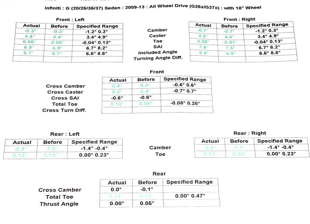

Had the alignment done today.
The initial numbers did look a bit different than those from april (esp camber). Two different shops were involved, both with the hunter dsp600 machine. Both ends (front/rear) required just a small tweak. Had to do the toe twice as the steering wheel was slightly off center for my liking. No frozen bolts in the rear. Car still seems to drive straight. Close exam of rears show a good 4-5/32's remaining, so I may put off new tires until late spring or summer next year.
