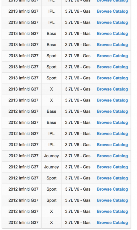

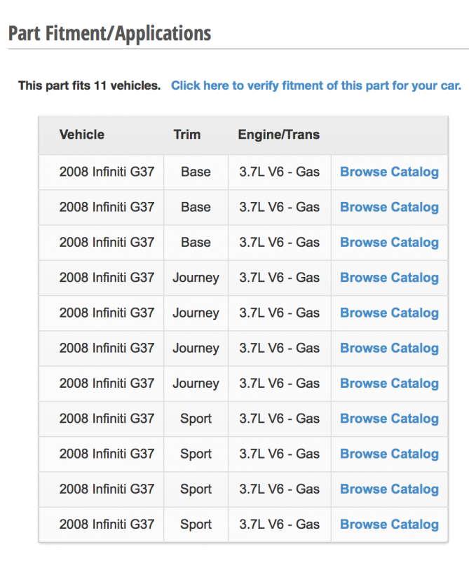

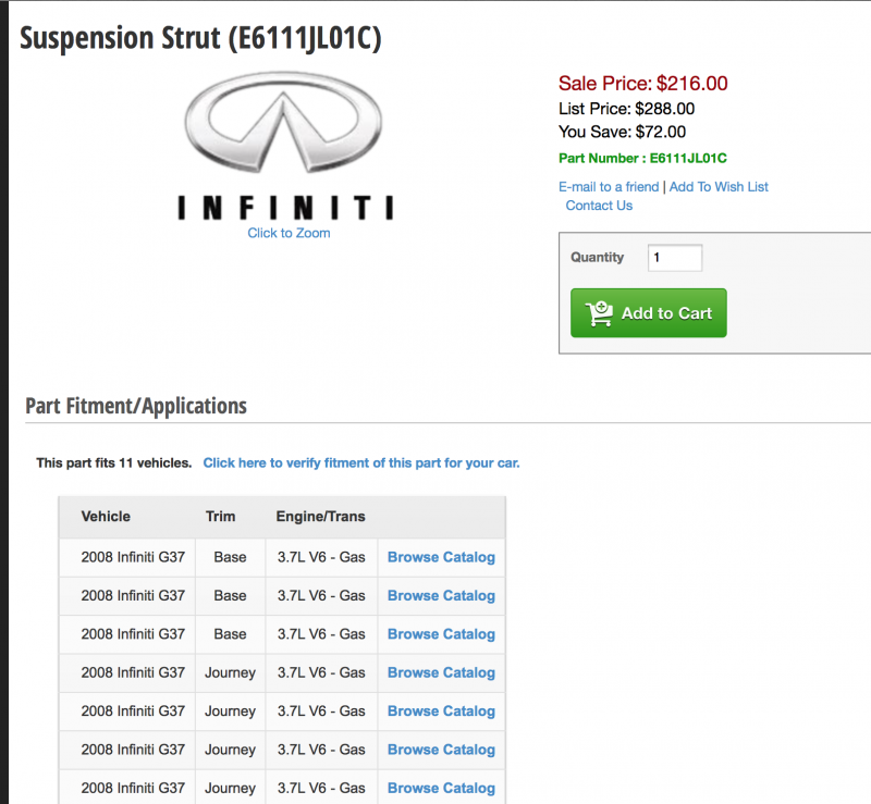

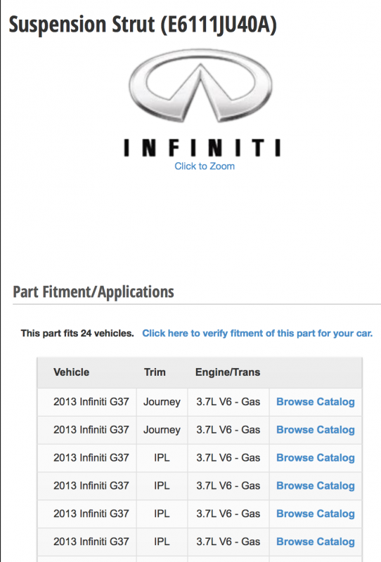

I have always thought that the struts are the same throughout models, and it is the sway bars that Infiniti gets their XX% more firm numbers. This would be why the ride heights are similar for sports and IPLs.
I looked into your part numbers and it seems that the part # you listed for the "sport", is a part # for 2008. This screenshot shows that this part fits basically every 08 trim.

The part # you listed as an "IPL" strut shows that it fits every model for 2012-2013.

I encountered this when I was doing the aluminum pedal swap. I would see the same accelerator pedal with 3 different part numbers. The only difference between the pedals were the year they were manufactured.
