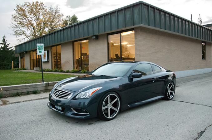

Im looking at getting the Stance SC5 20x10.5 all the way around and wanted to do 255/35-20 tires all the way around so I could still rotate. I've searched around and some say you need to go really low to pull it off and to make it look right with no rub in front?
This is my daily so was trying to be some what conservative with the drop.. starting out with springs. Would G35 Tein H-tech springs be enough?
Ive seen another members G37 dropped on eibachs with SC5 20x10, spacers all the way around (pic attached) and it looks really good and clean but trying to avoid spacers or a 285 rear.

Judging from the pic you posted....Looks like you can get away with 20x10.5 and 255/35 with the Eibach's.

His car is 20x10... wasn't sure if the 10.5 was enough to make it not work.
I was referring to this thread when i was talking about not being low enough and rub https://www.myg37.com/forums/wheels-...ant-drive.html
Seems like he's just referring to issues in the back with the fender bracket and not front rub.
