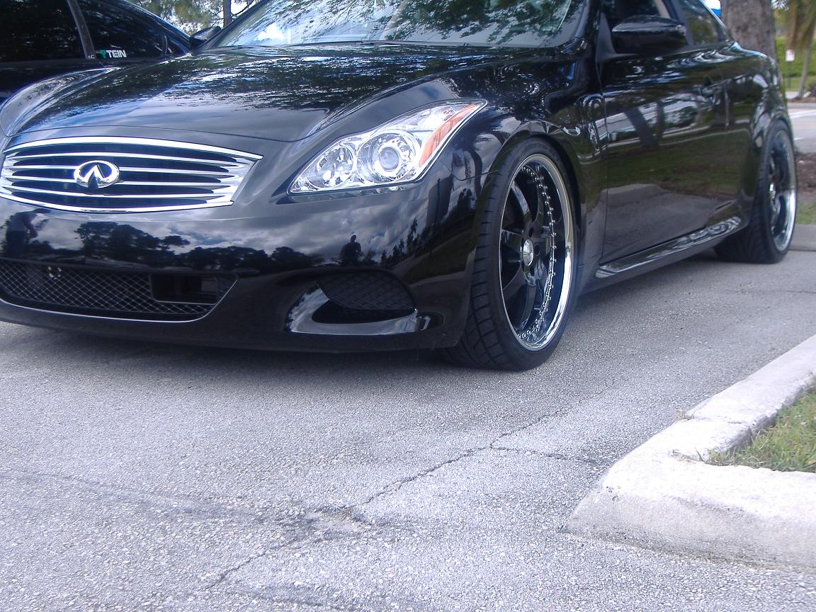

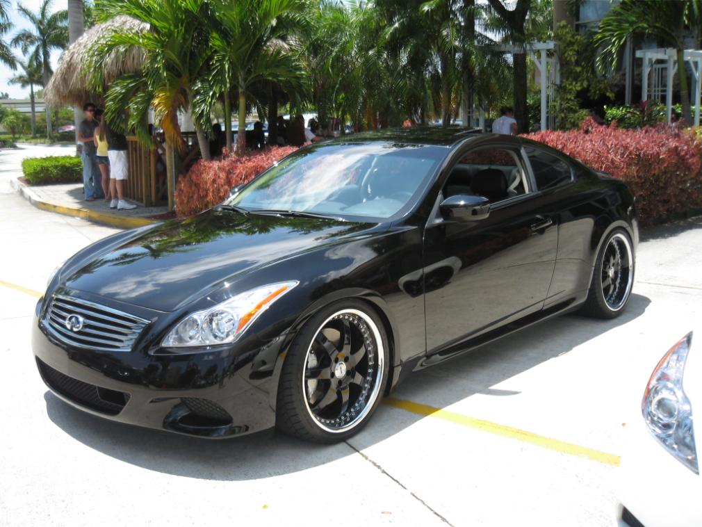

i got 10.5 rear its fine dependss on offset!!
Attached Thumbnails Can i fit 20x10 Rims in the rear?-picture-075.jpg   Can i fit 20x10 Rims in the rear?-img_0449-1-.jpg
Old Jun 3, 2008 | 11:02 AM
finagle69's Avatar
finagle69
Joined: May 2006
Posts: 2,929
From: Sacramento, CA
dude, i must've missed your thread with pics. those look great on your car! are those S7's?
