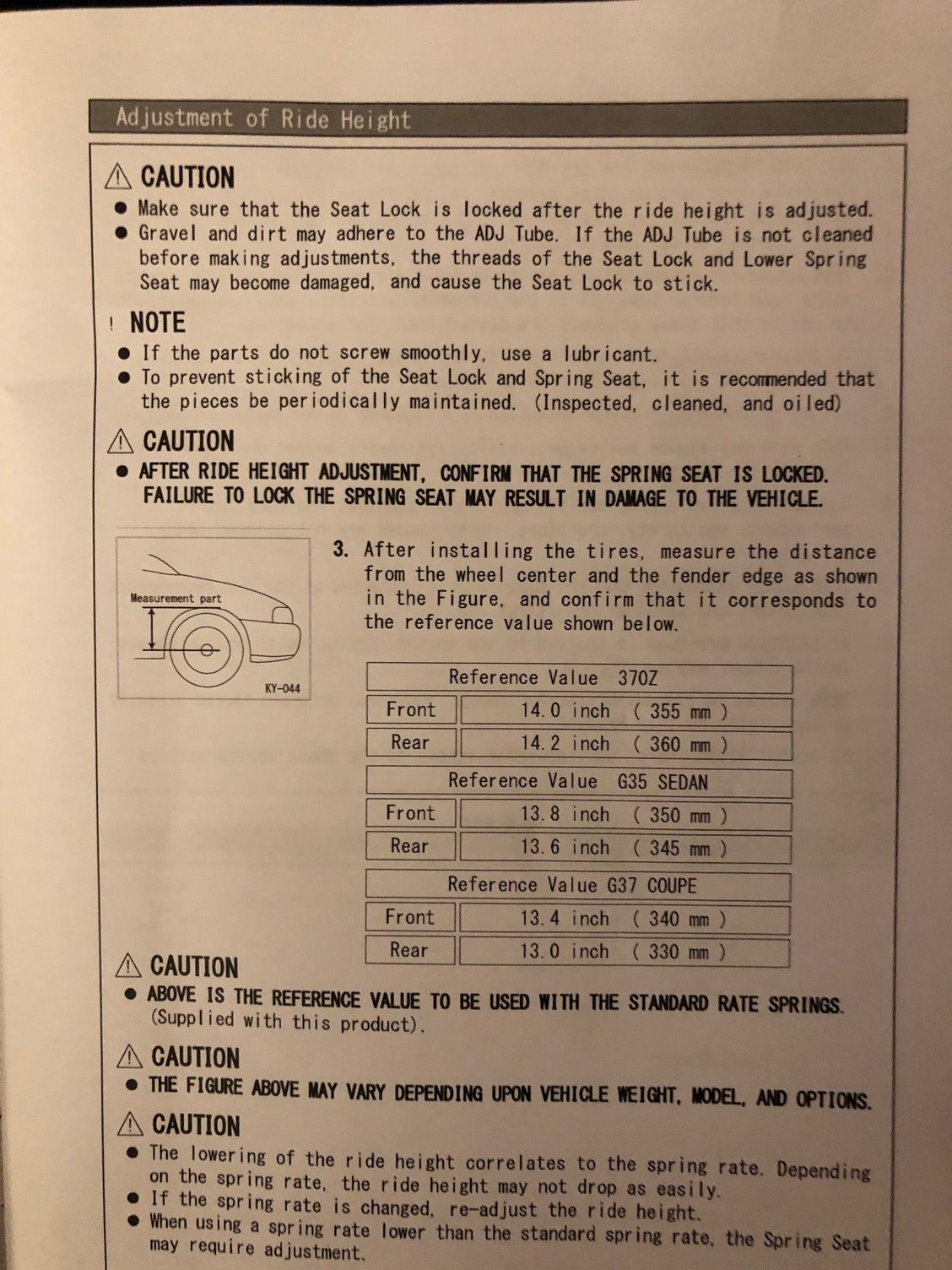

I finally got my Tein Street Basis Z coilovers installed on my coupe about a month ago now, with the help of a friend. The install was very straightforward and really wasn't too difficult once we had an impact wrench. I'll try to list out all of the tools we used below to help anyone else looking to install these, but will probably miss something so let me know if you have any q's at all about the install or the coils/ how they ride. I ordered them from ImportPartsPro (part # GSP92-8UAS2), along with some SPC Xaxis rear camber arms (Part #72262) that we installed at the same time; the pricing was fantastic and they did a great job with shipping it out ASAP w/ 2 day shipping. Great customer service even when I was a PIA and thought about returning them for the Street Advance Z, which I'm glad I didn't do at least for now bc of the roads here.
Install- I followed Tein's instructions and a couple DIY's here on the forum for the install. Started in the rears with a floor jack on the pumpkin, then used 2 jack stands also for safety and got everything loose with just a breaker bar, and it ended up taking maybe 3 hours for both sides with no power tools. We used your basic metric open ended and deep sockets, a ratchet, a torque wrench and a rubber mallet. Tein included some pretty good instructions for what they were, with plenty of reference information regarding proper heights, torque specs, and adjustments. The top nuts on the dampers were probably the most difficult to tighten properly, until I ordered a part for $25 from a Mustang website (Steeda, I'll attach a link below). That tool allows you to hold the damper rod with a vise grip (in the notches at the top of the threads) while you tighten the top nut down with a torque wrench. It made things much much easier for the new Tein dampers after we swapped out the OEM top hats. I also went ahead and eyeballed the settings of the factory camber arms and then matched them as close as I could to my new SPC arms. Once I got it buttoned up, we dropped the car and took in the amazing reverse raked look
On to the fronts and the finishing touches, the install was again very straightforward and simple, and this time we had an impact wrench so it took half the time. Jack stands are a must for safety for the fronts, please don't try this using the emergency stand that is in the trunk, all though we did use that as a backup jack in addition to my floor jack with the stands. One of the biggest takeaways I learned during the install was that you absolutely do NOT need a spring compressor for the OEM springs when you go to remove the top hats. I had read one or two mentions on the forum about not needing a spring compressor for the OEM top hat removal, so I decided to give it a shot without using the strut/spring compressor that I'd rented for free from autozone. It barely jumped an inch- perfectly safe. Keep in mind I was on the OEM Sport suspension though - if you are coming from aftermarket springs that won't be true or safe to attempt. We finished installing the new front Tein coils, dropped it and took it for quick spin. The difference was immediately noticeable for me- such improved steering response and it goes exactly where you point it now with no understeer. It really should have come like this from the factory. It did settle out a good bit over the next hour of driving and sitting, and it was so insanely out of spec it was very squirrely to drive. I let it settle a slight bit more over the next day, made some final height adjustments, corner balanced it, and then had an alignment done w/ one of the nicer Hunter alignment machines in town and got everything right at 2.1 in the front and 2.3 in the rear. I set it almost to the max of Tein's low recommendations, and will try to measure floor to fender again tonight if anyone is interested in those measurements. I'll try to find the alignment spec sheet also when I get home and upload that too, but the alignment fixed all of my issues and I even had no problem w/toe at all which is what I was mainly concerned about.

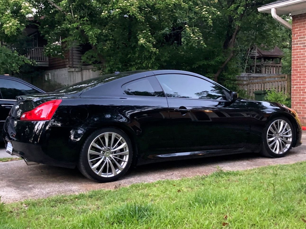

After the install without making any height adjustments yet.
Post install pictures, sorry they're awful. Better ones are below.
Current height. 26.25" ftg front, 26" ftg rear.

I've had that setup for around a month now and feel like I've gotten some good seat time with it. It is a little bouncey in the rear over bumpy/wavy newer roads in town, but no more than stock and is still a big improvement regardless considering the price and having the ability to adjust the height. The turn in is where it's made the biggest difference. There's hardly any understeer now I feel like, and it's all around more nimble with much less body roll. You'll feel much more confident driving through corners. If i had a bigger budget at the time, I would have paid up for some nicer fully adjustable coils but didn't want to get beat to death in my DD, so I played it safe for my first set of coils for the G. I was really considering the exact setup you're mentioning also but it was just a little too pricey for me with the SPC xAxis rear camber arms I have now. I've only heard good about that setup, and it seems like it gives a good even drop. I've heard the rears bouncing can be fixed slightly by raising the height a little which I might try, but I have the height set to where I'd like to keep it. I'm also curious to see what difference the Hotchkis sways will make when I get around to ordering those in the next month or two.

I measured it earlier this afternoon in my garage, and it's currently at 26.25" ftg in the front and 26" ftg in the rear, even on both sides. I'll probably raise the rears an 1/8" to a 1/4" when I install my Z1 20mm extended studs and spacers (along with some Z1 slotted rotors and SS brake lines) to avoid having any rubbing issues in the rear, but I'm really happy with the stance right now. I don't scrape too much, and it's pretty much just the plastic scrape guard under the lip and engine under tray. No damage to the lip so far! (knock on wood). The exhaust barely scrapes on occasion, but the good old angle over speed bumps and humps is the key. I'm still really happy with this setup for the street after about 2 months now. Here's some pictures I took today of the current drop.
