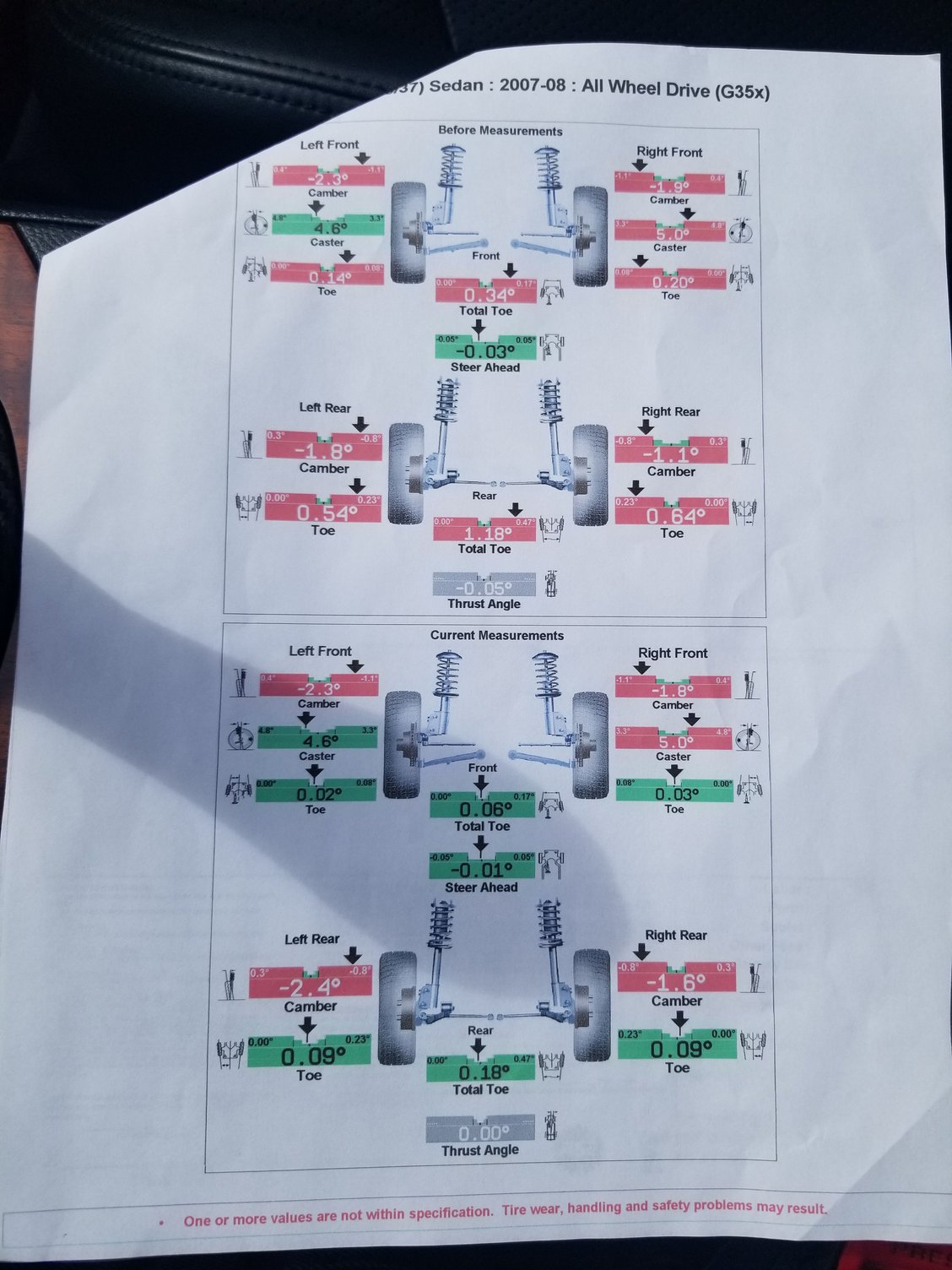

So i've just installed the SPC camber arms and larger toe bolts over the weekend and taken the car for alignment today. I got it back and they claim they were unable to get the camber in line because the toe was also adjusted when he changed it. This makes absolutely no sense to me because I had thought the entire point of the adjustable length arm was to be able to adjust camber independently. Am I wrong here? I had thought that was the entire point of the arms / bolts.
There's a visible difference in rear camber on each side. I was considering manually adjusting the camber arm myself, assuming it won't affect the toe as well...

Now I'm thinking i messed up? This isn't my pic but it shows both. I used the new bolt on the new arm. Didn't touch the circled part to the right on the spring bucket at all.
Actually, reading some more I think I did screw up.. I need to probably order another set of bolts and do the spring bucket correctly then...
Edit, but actually, maybe I should just leave it alone? They did get the toe back into correct spec regardless.
