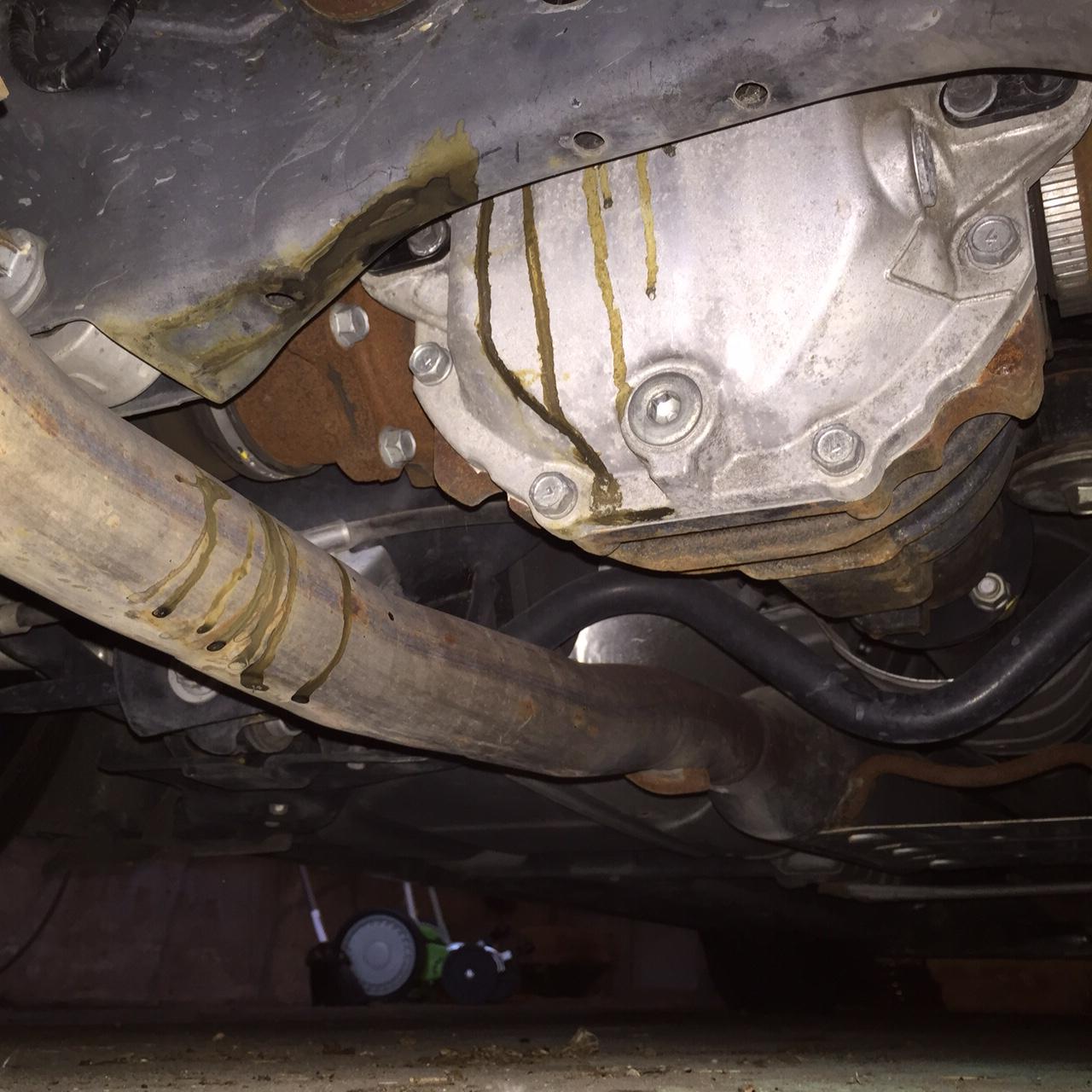

the leak will look somthing like this:

Thanks for the pic. I have a small stain below mine on the sub frame, but nothing even close to that.

Recently looked under again and found this:
It must have just started, it was just at the dealer and they would have noticed this.
Old Aug 1, 2019 | 12:13 AM
slartibartfast's Avatar
slartibartfast
Posts: 6,105
Likes: 842
From: Houston, Tx
Yep, it's leaking now.

It's that time of the month for your [car's] rear end. If you have a warranty let them fix it, otherwise, going after market should be somewhat cheaper. There's a few DIY's in the tech section.
Oh, and there's another fix involving filling it up with epoxy.

Quick rundown on dealership life. If your car is under warranty and I KNOW they saw it because you can’t miss it, 9/10 times is the Tech didn’t want to do it because it doesn’t pay well. Warranty work is severely underpaid compared to customer pay(when your car is out of warranty). If your mechanically inclined you can do it at home. It will take about 6 hours to do.
