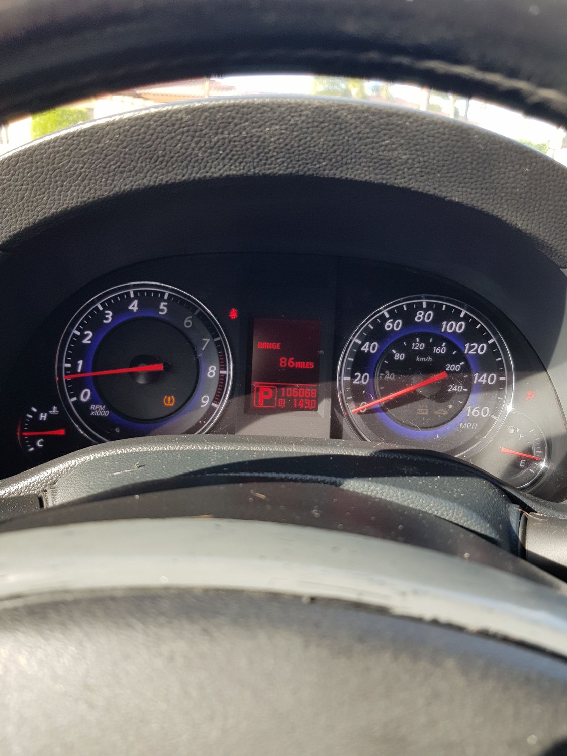

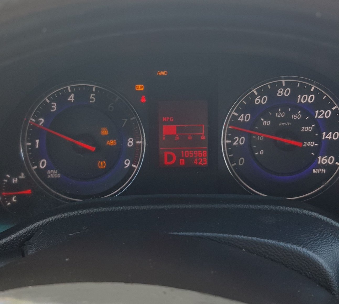

Hello so I bought a 2009 g37x. Its rebuilt title it has a bunch of lights on for different things. I know some of these go together but it does not make sense since there is no codes and there is no typical symptoms linking the lights. The car starts and runs smooth. I've checked tire pressure pressure and made sure all tires are the same size. The only issue it had was a bad wheel bearing which I already replaced. Any input would be great

You need a code reader that can retrieve abs codes.
you're not seeing any codes because your check engine light isn't on. Most cheap code readers only retrieve engine codes. There's multiple other systems that can store codes. Abs, srs, etc.
your tire light is most likely on due to a malfunctioning tpms sensor. It'll need to be replaced and reprogrammed

In addition to whats mentioned above, inspect your rear brakes and the brake fluid reservoir as the VDC and slip lights are linked to a low brake fluid sensor in the MC reservoir. TCS is also linked to the rear brakes and can cause the lights to go on and disable the system if the rear brake pad are too low

If his brake fluid level was low enough it would trigger a red BRAKE light. I don't see one in the picture

you can't assume there is a issue with the cluster and you can't fix each problem individually when you don't even have a clue why the lights are on.
go take it to a shop that has a scan tool that can scan for abs codes than start from there.

Quick update I ran the codes and the were no check engine codes. There were a bunch of air bag codes but it's irrelevant. 3 of my tpms sensors are bad and the front left speed sensor is bad which is the cause for the lights. Do you guys have any experience with cheap Chinese speed sensors?

Update on this issue. I bought a $10 Chinese speed sensor and all the lights when off. The transmission would also kick and that got resolved as well. Just installed springs and waiting on new wheels to come in next week to fix Tpms light. Thanks everyone for your help.
