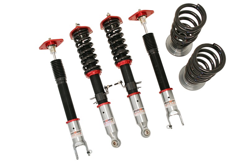

FWIW here's my rear coilover adjuster, just a **** just below the upper mount, real easy to adjust, just jack one side and you can easily reach up to turn it, then repeat for the other side. Too bad some of the higher end setups don't make it that easy
