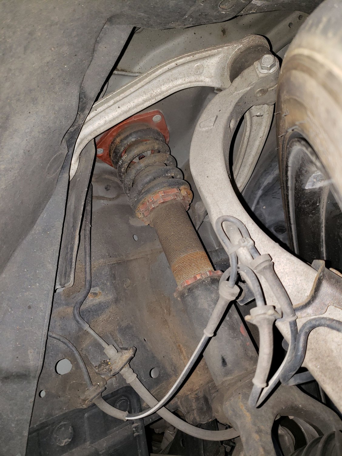

On the picture does it look like the coil is way too tight??? Because the car was adjusted to the softest dampening, and the ride is still crappy, so I think the coils are set up really badly.

I don't know what the uncompressed spring height is, but just looking at the photo makes it look like the spring has a ton of preload on it.
Also, looking at the pic don't be surprised if you have a hard time adjusting that by the looks of the corrosion.

those coils are in very bad condition and look weird. why are the collars so high

I'd agree w/ the last 2 replies, seems like the spring is very compressed, that pic should be what the coilover would look like if you just hit a big curb or pothole. Looks to be almost to the bumpstops.
I would remove the coilovers in front, set the preload which just needs to be 5mm, then reinstall them and adjust the height collars to get the height you want. Spray a bunch of PB blast or WD40 on the threads while you're at it. FWIW it may take quite a bit of force to get those collars loose, those springs are going to be putting a lot of force on them
If you have true coilovers in back (which I believe the Ksports only come that way) you'll need to do the same in back.
Once you get the preload back to normal I'd set the dampers at the halfway point (like 16 clicks up from fully soft) and go from there.
Here's what a typical front coilover should look like installed, notice the spring is under much less compression.

In that Condition I wouldn't rule out blown shocks
