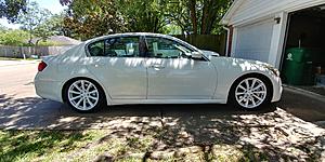

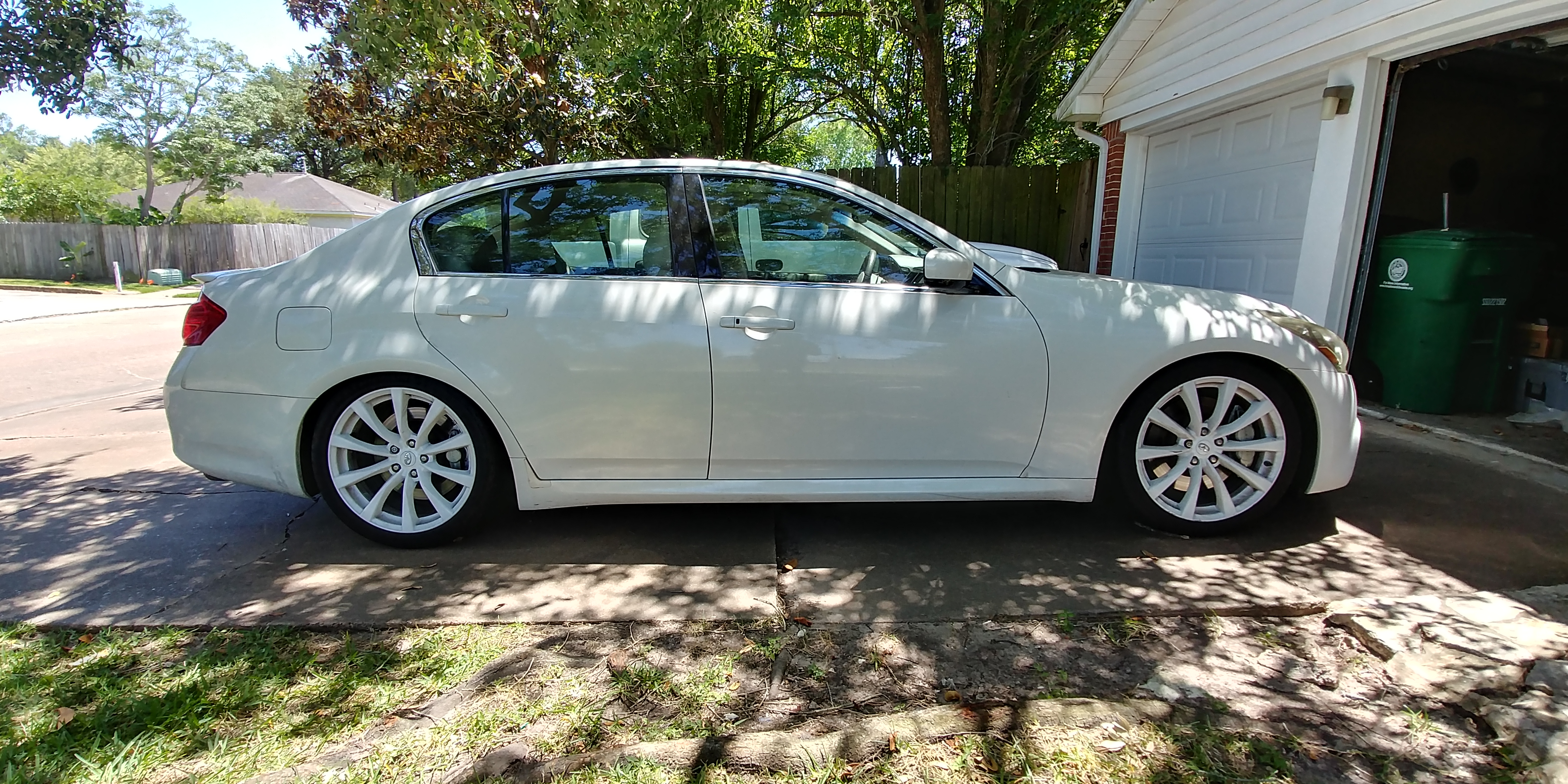

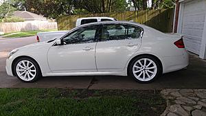

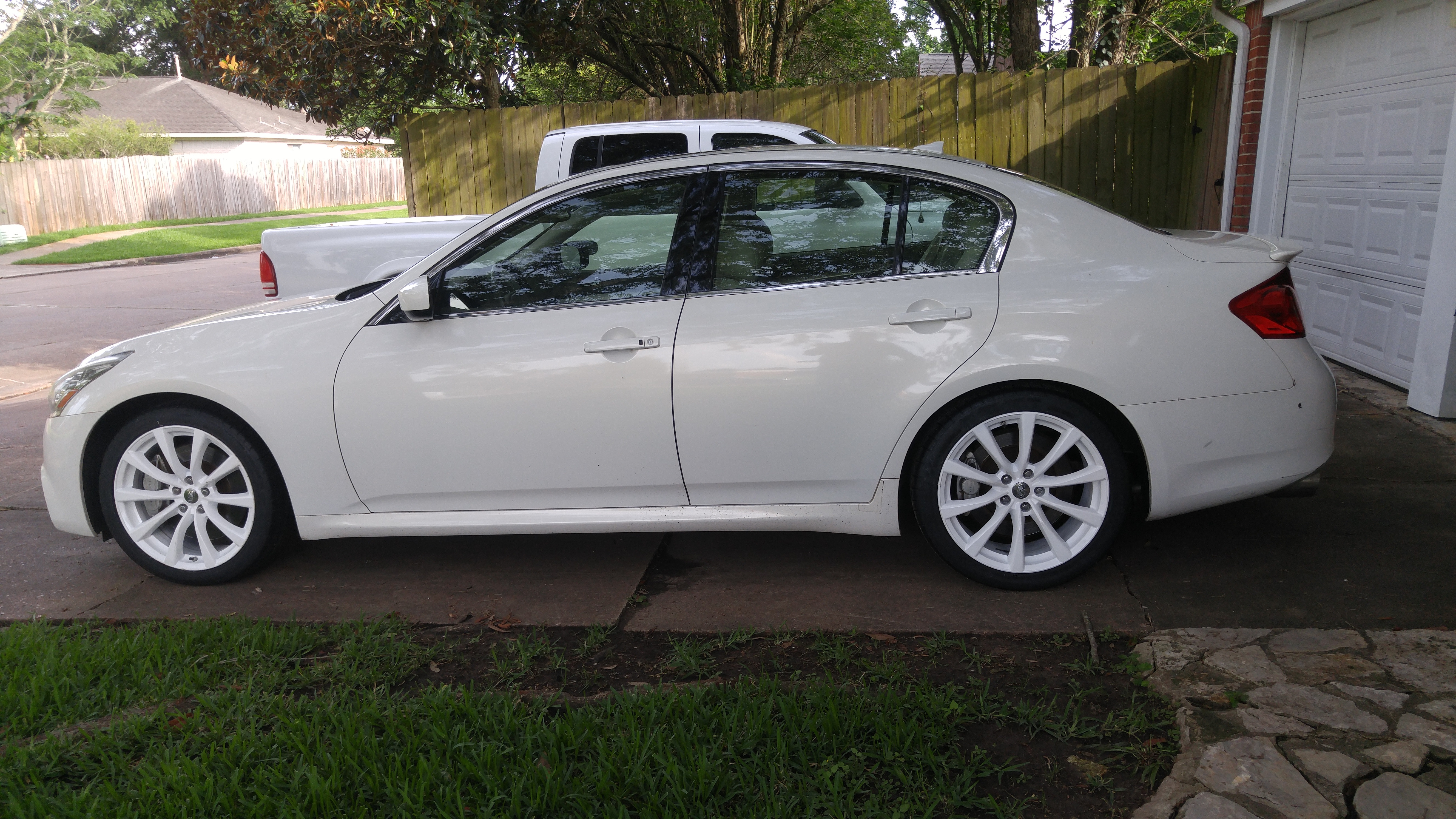

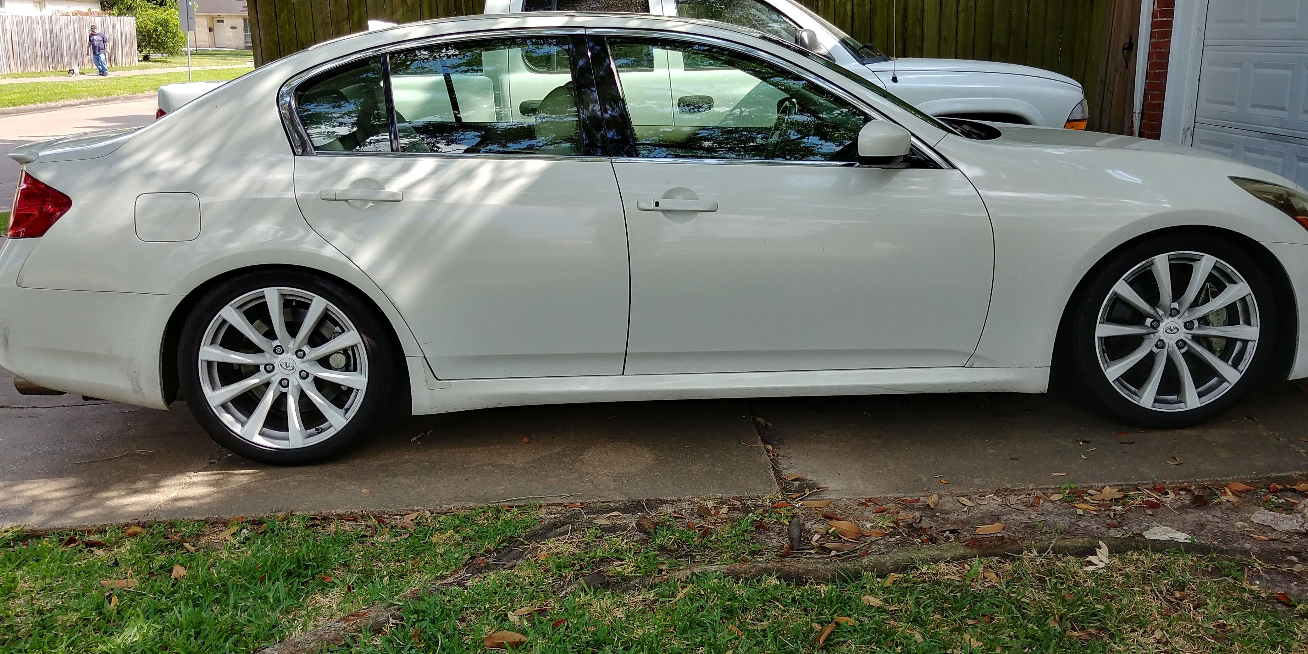

[Edit] Added photos. The first photo shows the rear remote adjuster sandwiched between the seat back and the rear cabin structure. Third photo shows the stock left rear spring/damper at 52k miles along side its replacement. Fourth photo is the car on stock suspension, the fifth after the install out-of-the-box and then the car after height adjustment. I raised the rear (to its upper limit) so my ARK tips would stop dragging the driveway as I transited. It also visually better matches the front.

Had to raise the rear to the max so that my ARK muffler tips would clear my driveway.
