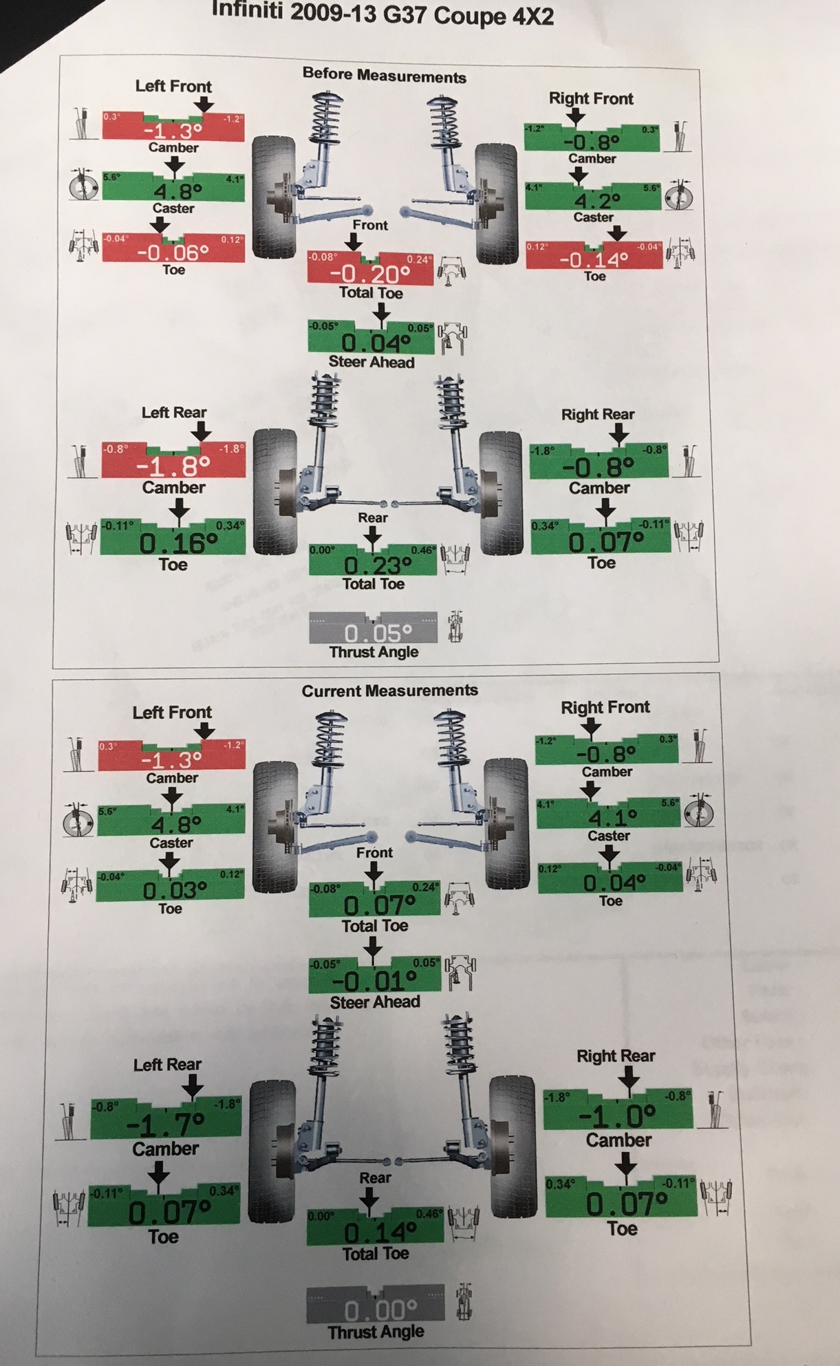

Just dropped my car off to get front only springs installed. I'll post a pic in this thread when I get it back to help out your decision. Will also see how good they are able to get the alignment without a camber kit.

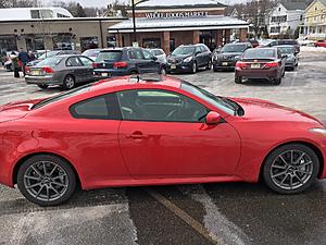

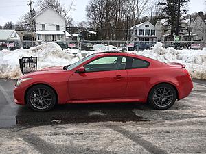

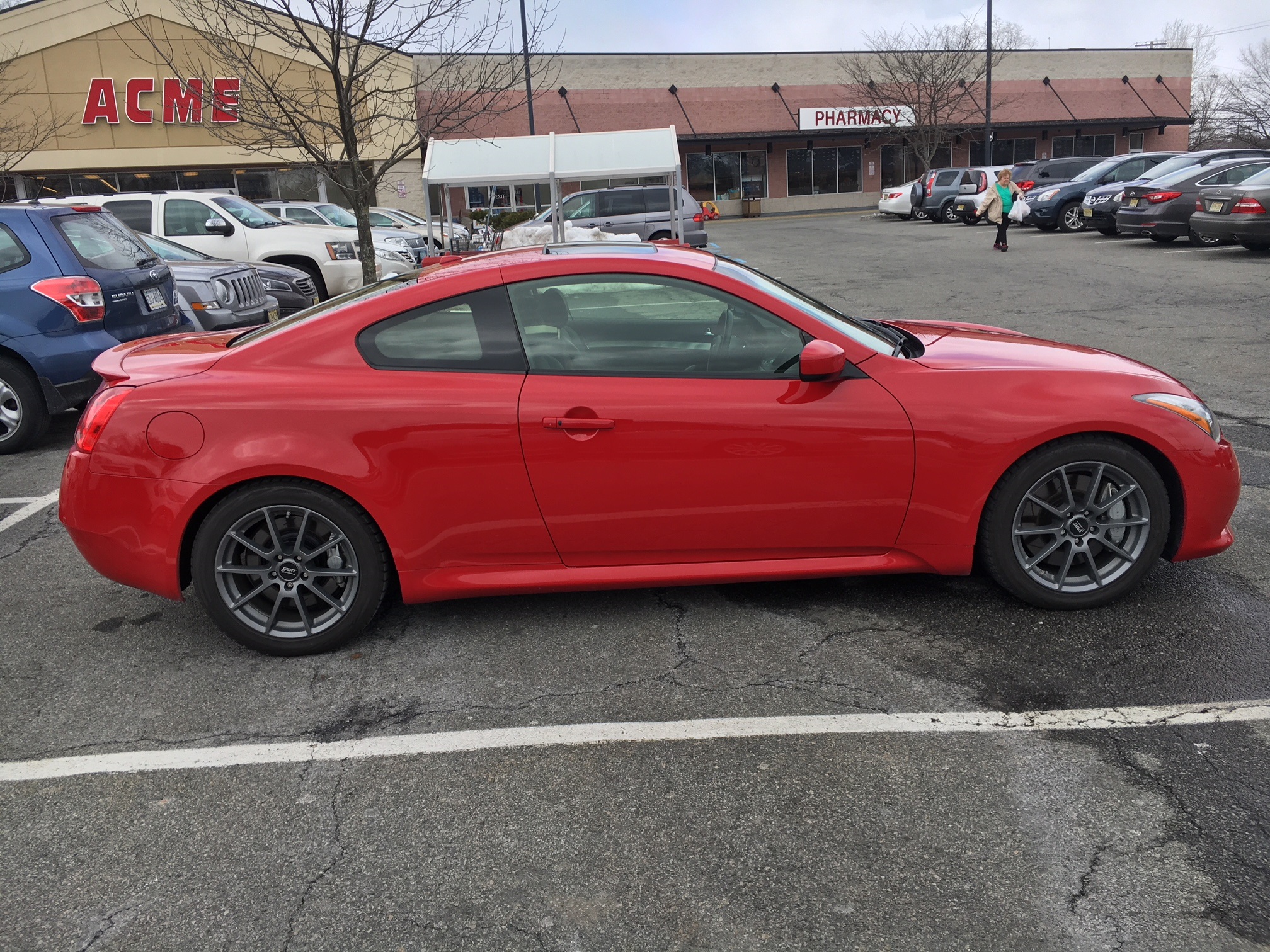

Here it is fresh from the shop. Not the best pics, need to get it cleaned up and on a perfectly level surface but it came out great. I did front only because I measured the the ground to fender height stock and it was exactly an inch higher in the front. Looks even now with just the front dropped.
Attached Thumbnails Tanabe nf210 springs & H&R spacers.-g-lowered-1.jpg   Tanabe nf210 springs & H&R spacers.-g-lowered-2.jpg   Tanabe nf210 springs & H&R spacers.-g-lowered-3.jpg   Tanabe nf210 springs & H&R spacers.-alignment.jpg

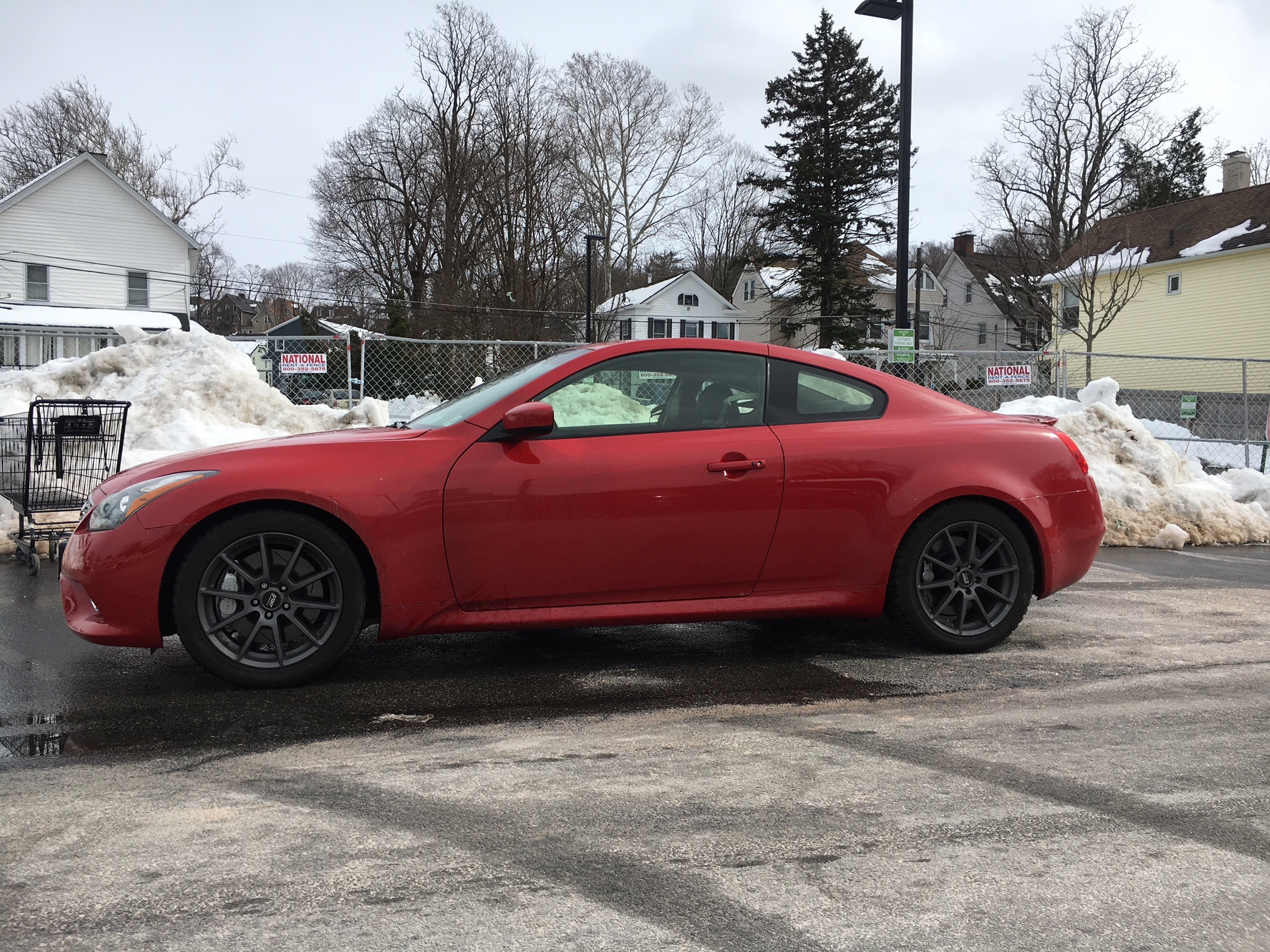

Also, here's a pic of mine after settling for a few days. Really love how it came out and the ride is the same as stock.
