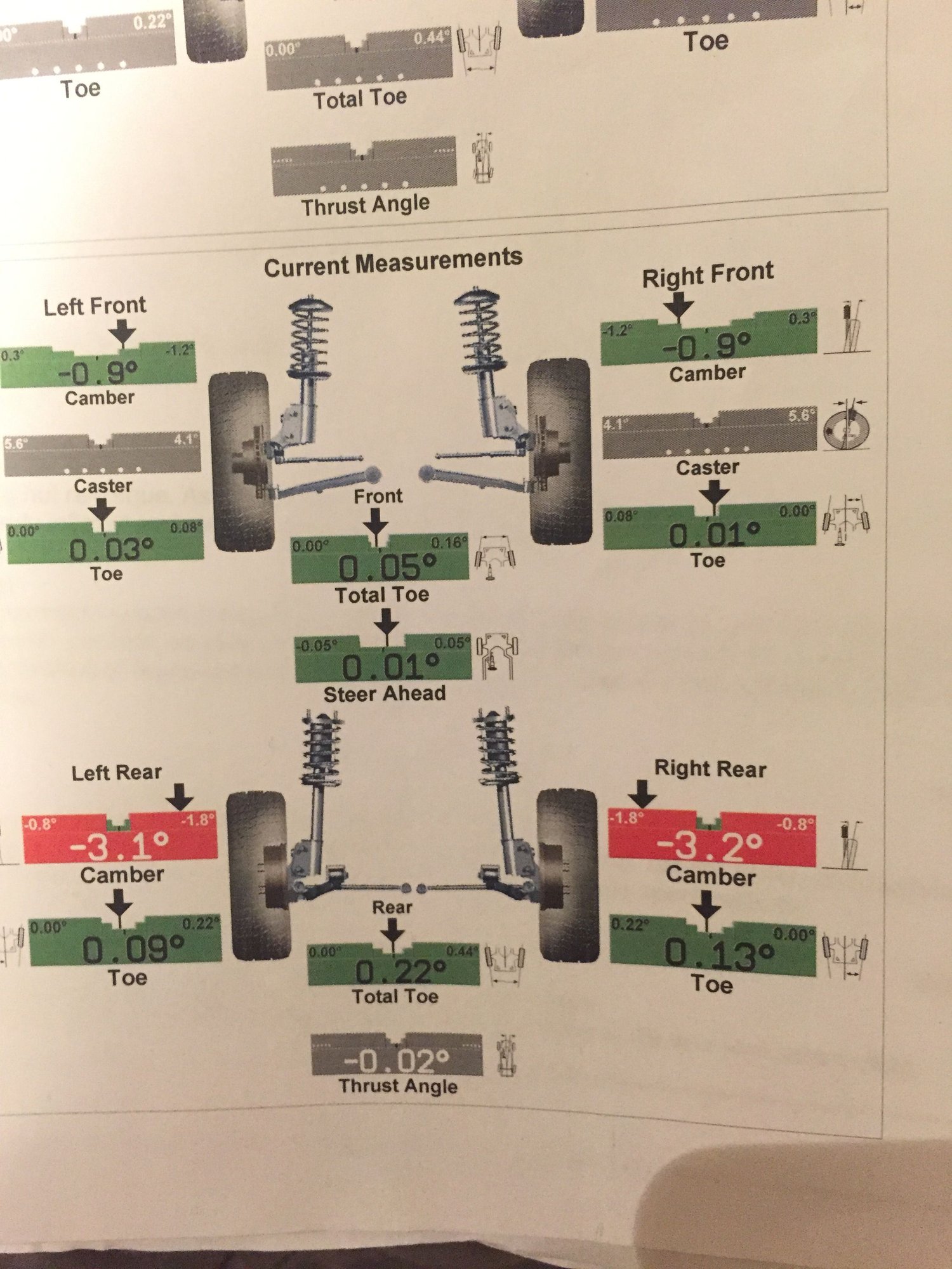

Here are my alignment results. I’m dropped on Tanabes. I just put on new Michelin PSS and hopefully that’ll be my last for a few years. My previous tires before the alignment had inside tire tread showing on the edges. Are the results good or could be better? I hate buying tires every year.

The numbers look good except I'd want the left rear camber reduced to match the right rear.

Looks pretty good compared to mine. I have oversized rears hence the increased negative camber.
Yeah the only thing is the rear camber difference but I am not sure what an acceptable difference between left - right is. Probably not concerning.

The side with more camber offers more grip on a turn.
