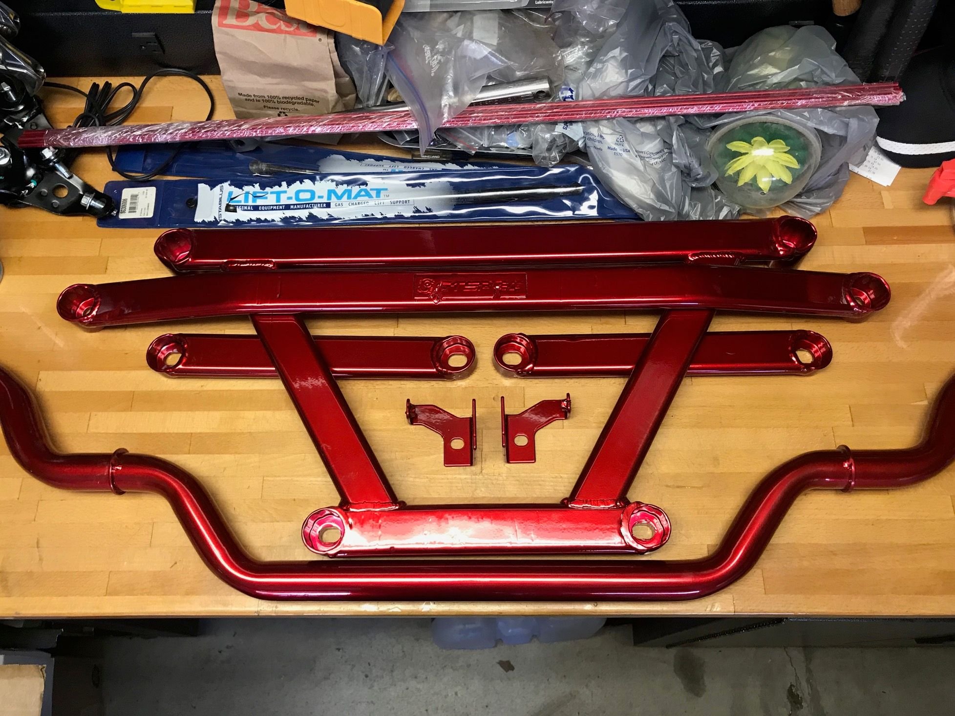

Glad to hear that you were able to solve your issue, Lego. The aftermarket sway bar bushings seem to need regular maintenance in order to stay quiet. I know if I don't lube the bushings on my Hotchkiss front sway bar every other year then they will start squeaking especially when it gets cold and/or wet... usually December/January out here in Southern CA is when it starts to show up. In fact I actually just replacement the front sway bar bushings last weekend while I had my front sway bar off for powder coating.

Man, you're killing me with that powdercoating. Fantastic color choice. I bet you've been pricing custom nut & bolt hardware for under the car, too. I'm thinking a satin finish on SS or Ti.
What is all that? Engine cradle braces, four-point frame brace, rear frame brace... and sways. The full rack of GT-Spec items. FSTB too, I'm guessing. Did you go ruby red metalic there too? What are those to tiny brackets? Do your springs match the same color?

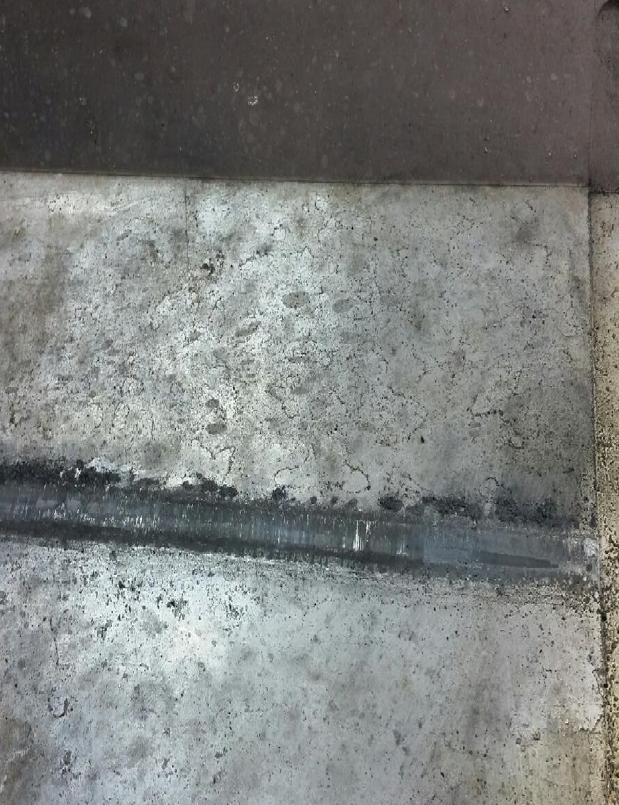

I had the same issue with mine two winters ago and was the same thing. Glad you fixed it also! However at some point not sure why my front sway bar starting rubbing my undercarriage shield :/
