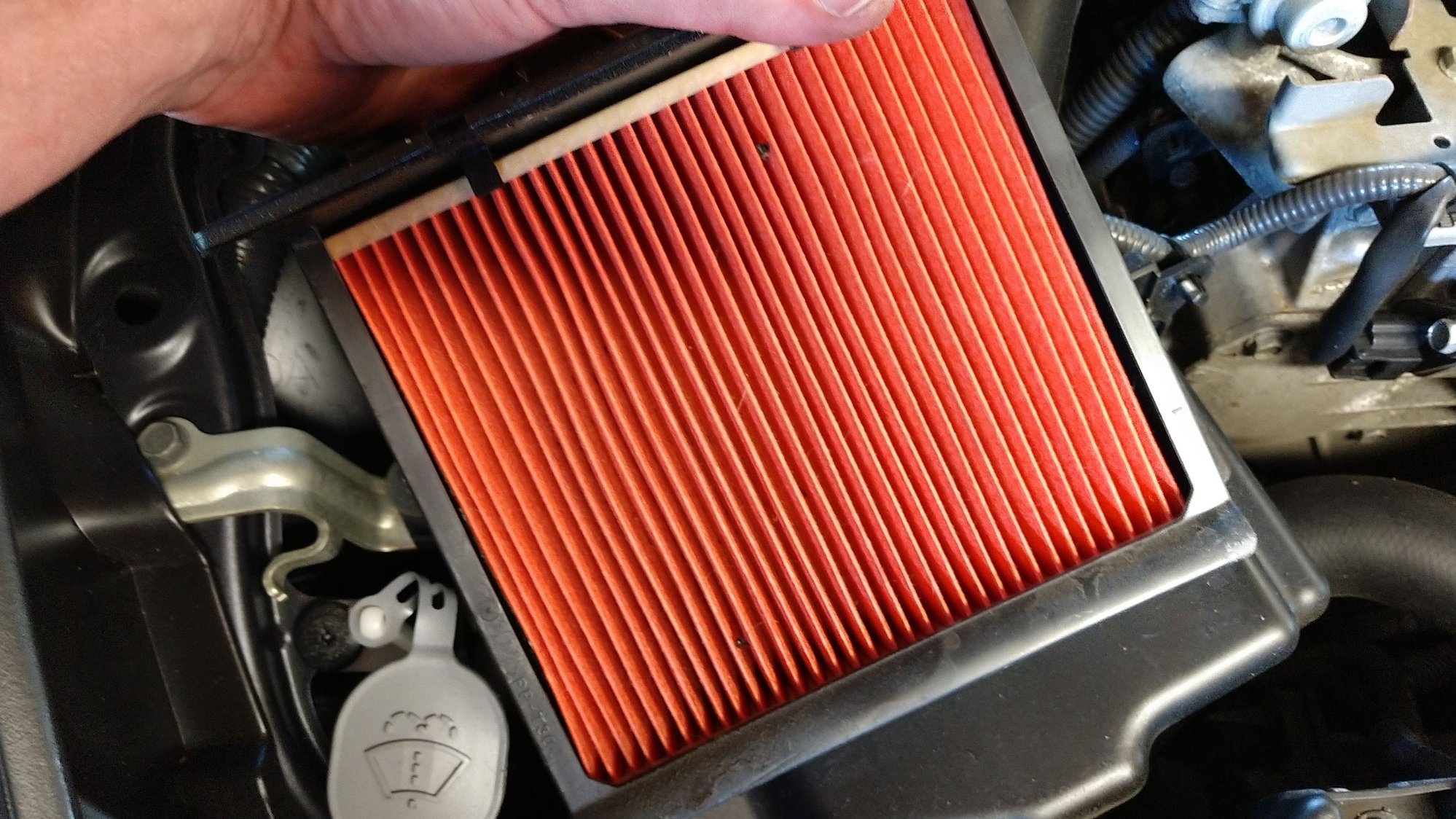

Prepped
Filters look like they're new

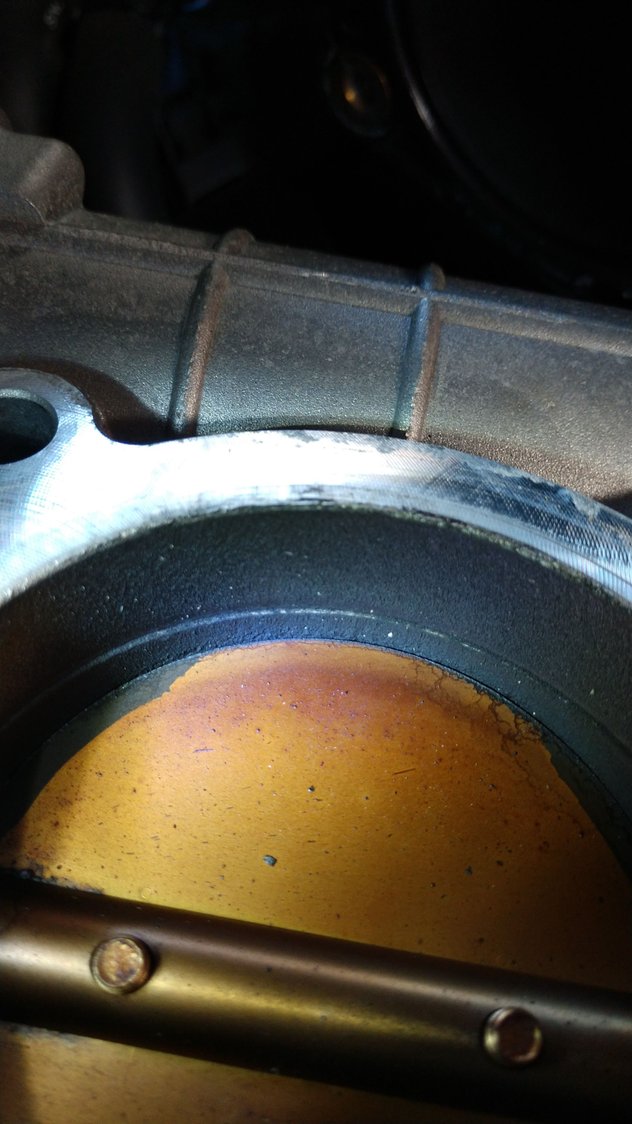

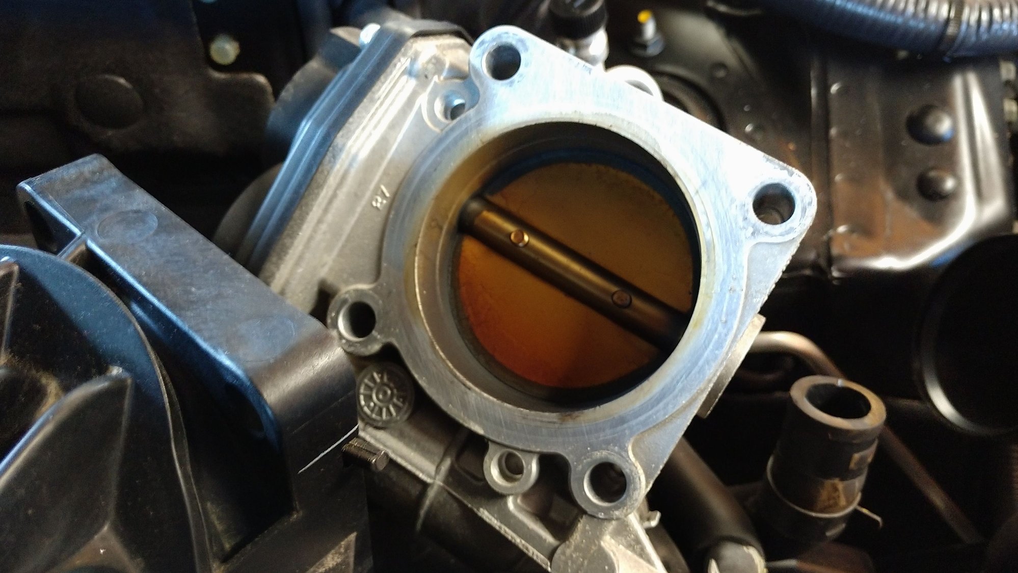

Makeshift equalizer for Allen wrenches
Driver's side before
Passenger side before

Eww!
It's texturized.
I'm no expert - but I experience lag in throttle response, periodic idle drops and strained idle for the first 30 seconds after cold start. Might be related...

Cleaned up well.
Much better!
As expected - it runs better.
