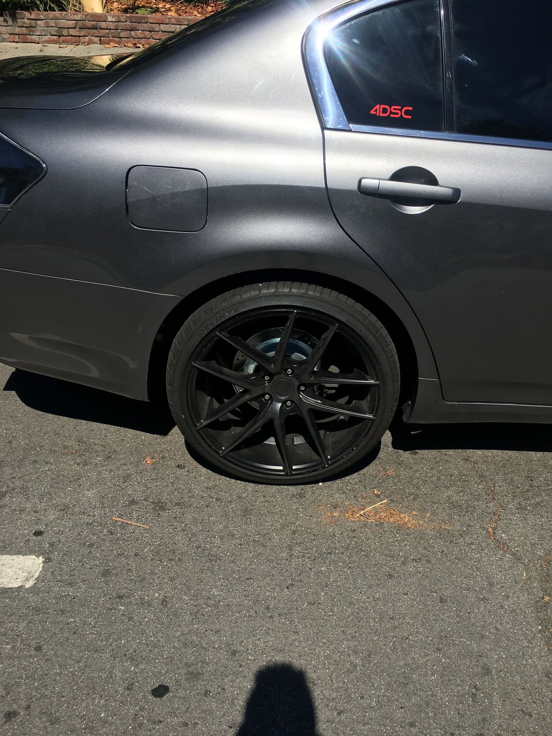

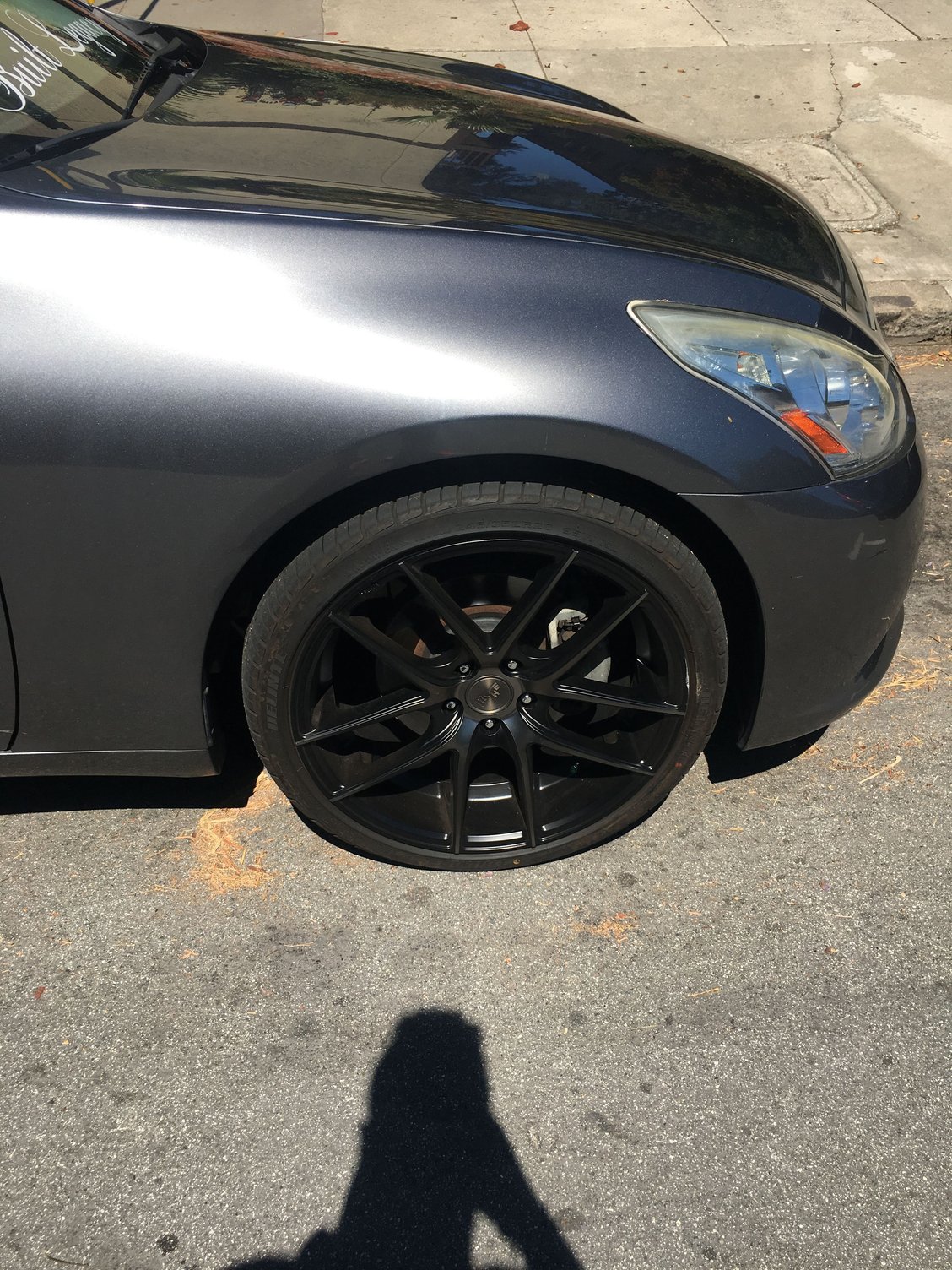

I have 20inch wheels and 20x10 in the rear and 20x8.5 in the front for a staggered setup. Stock suspension I want to lower it a little bit if I were to drop on Eibach springs, how would that look and feel.
That's what it looks like rn. I apologize in advance if anything I said was incorrect.

Eibachs will be 1.5" lower in front And 1.2 in back.
Swifts are 1.3 front And 0.8 in back
Do a google search for pics
Old Jul 6, 2017 | 08:15 PM
Eibachs will probably require more camber help vs. the Swifts, both are considered a mild spring drop though. I'd consider Tein Basis Z coilovers, only a couple hundred more than lowering springs and will be a cohesive system that can drop to the exact height you want.
