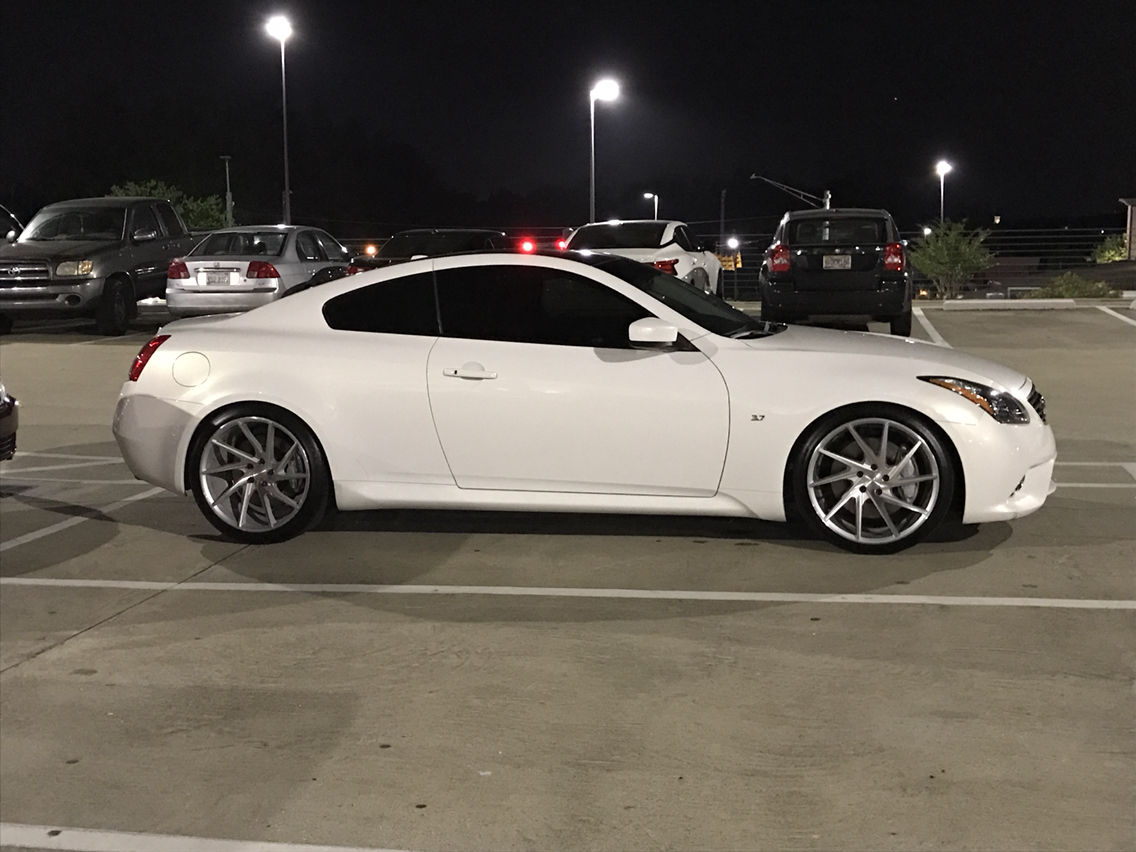

My eibachs have been perfect for maintaining daily drivability and getting rid of the stock wheel gap. I didn't do spacers or any of that. I got them installed at Z1 Motorsports on stock sport wheels and had no issues. I have since gone with aftermarket 20" wheels and still no rubbing issues at all.
Attached Thumbnails Best way to lower a 2014 Q60s/ g37. Coilovers or Springs?-photo48.jpg
Sick car! How long have you had your Eibachs?
Thanks, I've had them for about a year now. That was actually my first mod. Now I am on aftermarket wheels and I've put over 20k miles on my car. I don't have any issues with bouncing. I put the springs on my Q60s with about 19k miles on it and I havent experienced any decrease in ride quality. I'm at 43k miles now.
Attached Thumbnails Best way to lower a 2014 Q60s/ g37. Coilovers or Springs?-photo57.jpg
Damn man it sits nice! And no spacers? I know that it's a long shot but do you still have the link to which ones you bought?
I don't still have the link but it's the eibach pro-kit for the 2013 G37s coupe. They didn't list one for the Q60 or Q60s coupe when I was looking. And no spacers or anything else, just the springs. I drive it to work every day and I haven't had any uneven tire wear issues or rubbing issues. I got it aligned with the new wheels and haven't looked back
