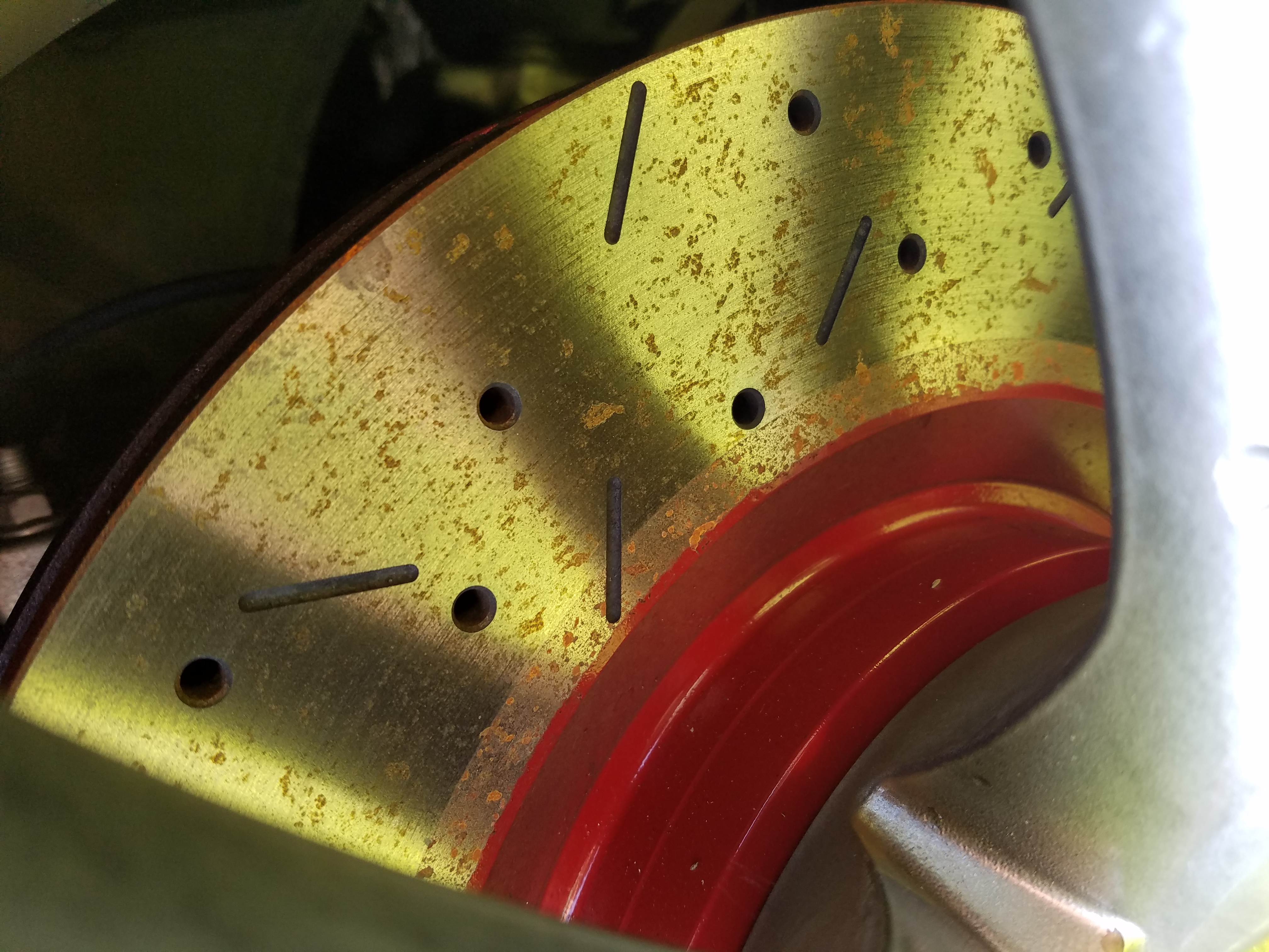

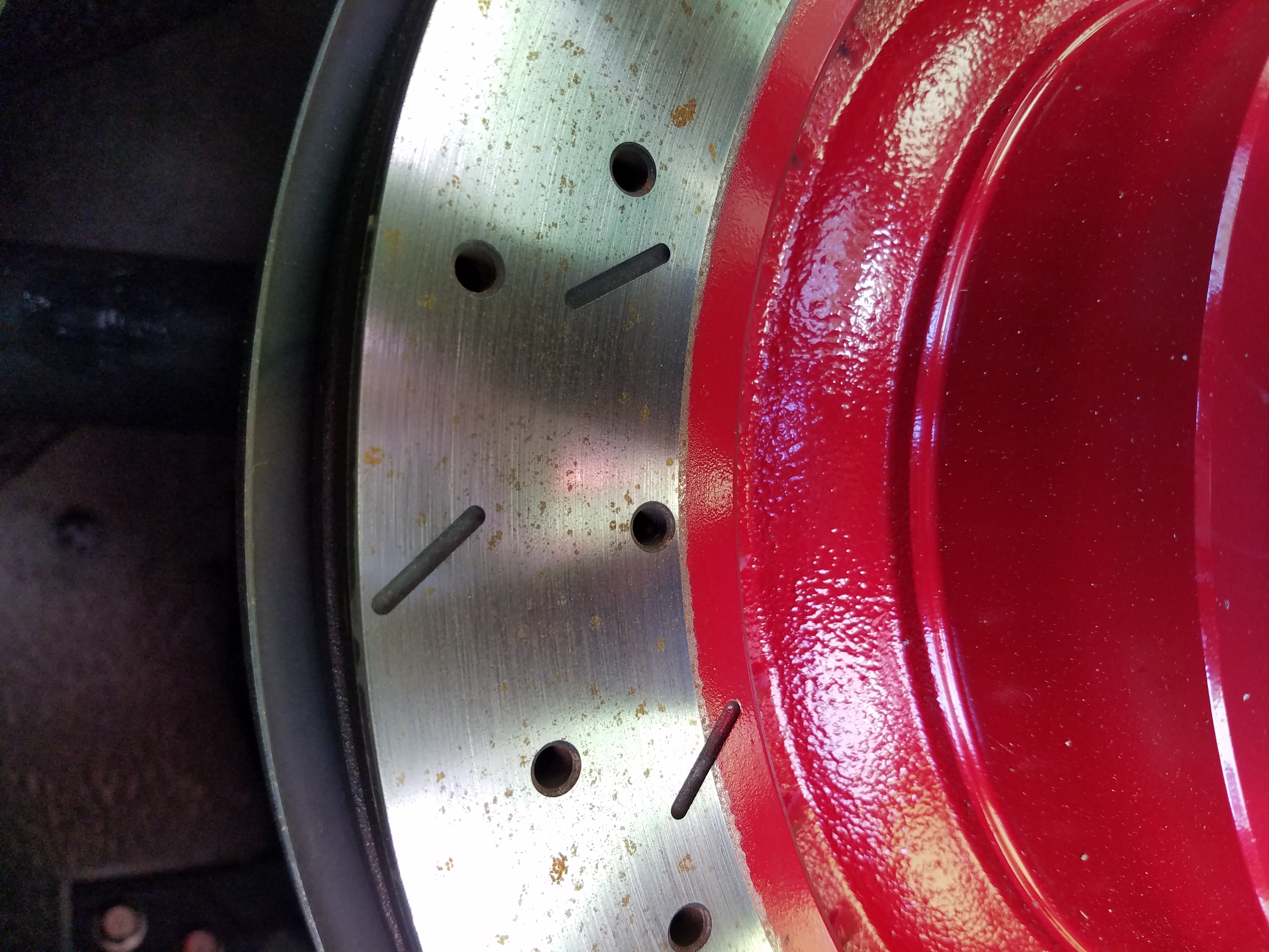

I took these this morning- please note these are the DBA XS 4000's and NOT the T3 4000's:
Right Rear:
Right Front:
Please excuse the surface rust. The car has been sitting for two weeks. Hopefully this will show a different perspective other than the typical stock photos plastered all over creation.

+1 for the centric premium blanks. a lot of the slotted/drilled options here are more for show, and a lot more dough. don't really offer improved performance.
