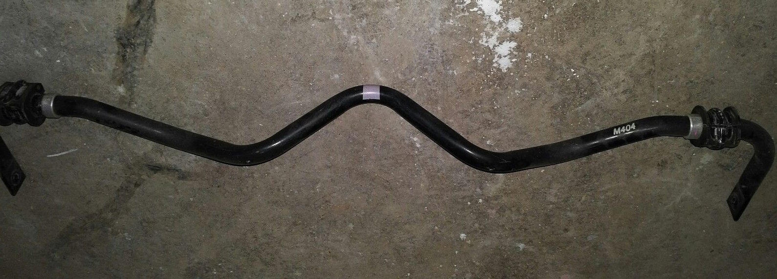

here's the RSB from a 2015 370Z I had installed on a 2010 G37x a week ago. Note the stock markings. I didn't measure it, but it was noticeably beefier than the stock X RSB.
