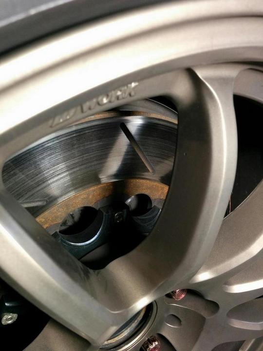

For what it's worth, my Z1 rotors look like this:
I got enough heat into them that the coating burned off. Lol.

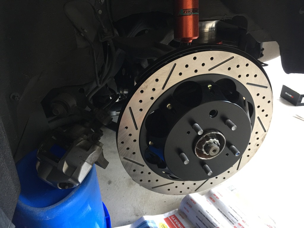

Shot of the left rear prior to getting the caliper back on.

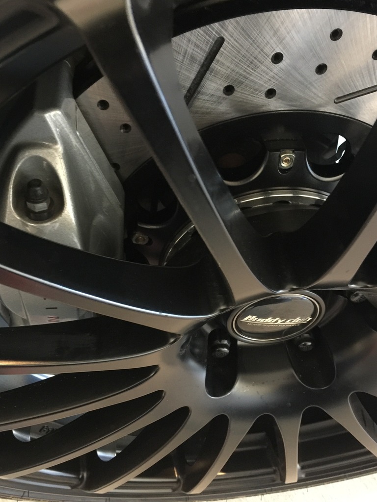

Fronts. They look fantastic behind the wheels.

Dumb question, but are they on the correct way?
The slots on mine run backwards is all, the top is the front edge, not the bottom

You know, I may have them on backwards...really depends on the internal vane configuration, slot direction doesn't matter. I need to find out. If I have them on backwards, I know what I'm doing next weekend. Grr.
Edit: Going by Z1's photos, they're curved vanes so they should sweep backwards. You'd have to feel inside the disk void to see which side is concave and which is convex..

I'm curious to know, I would expect the internal vane and exterior slotting to be in the same relative direction for the drilled and non-drilled versions of the rotors, but I suppose it's quite possible that they are not.
The internal vanes are on quite an angle, you can see the vane direction quite clearly when you look in to the rotor, simple when you have a wheel off.

Assuming they assembled my disks the same way, if you look at the photo on Z1's page, you can see the internal vanes are the opposite direction of the slots. From what Z1 was saying on the 370Z forum, unless you have brake ducts, it doesn't matter but the way I have them forces air through them from the outside in which is what they were saying to do. I think if you had brake ducts, you'd want them the other way.
I'm going to do a bit more research. I had an AP Racing big brake kit on another car and I do remember there was a left and right rotor (they were slotted) but it's been a while and I can't remember which way I had the vanes directed on them.
I'll ask Z1 directly as well.
Edit: Doing a bit more research, the curved vanes should point backwards on the outside of the disk. Slot direction doesn't matter. Looks like mine are on backwards.
That's the one. Sorry to be the bearer of bad news!
On a positive note, now you've done it once, swapping the rotors shouldn't take more than an hour car on the ground to car on the ground.
