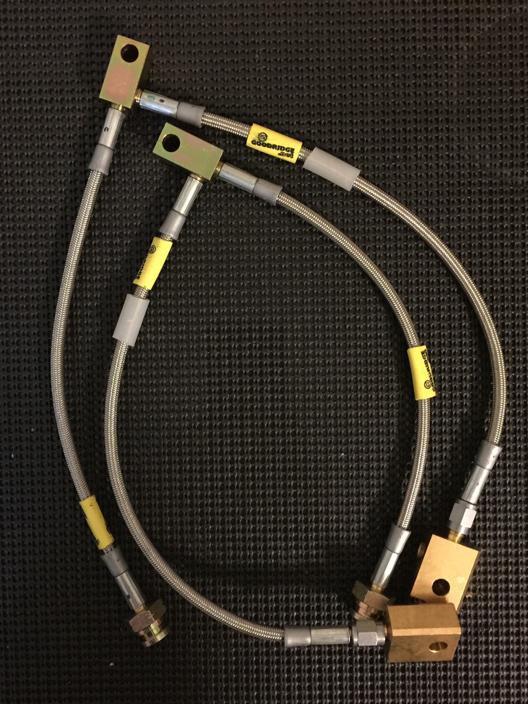

Ok lines made it to my mailbox despite USPS's best efforts not to deliver the items I order.
Rear lines:
Fronts are identical for all years so I know they'll work.
I will say this; they're heavy suckers. The package had a good deal of heft to it for a few hydraulic lines. Solidly made though and DOT approved. I won't have time to look at my rear brake lines until late in the weekend.
Rear lines:

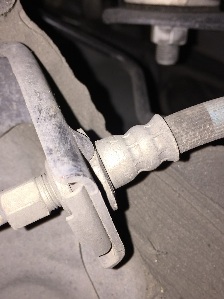

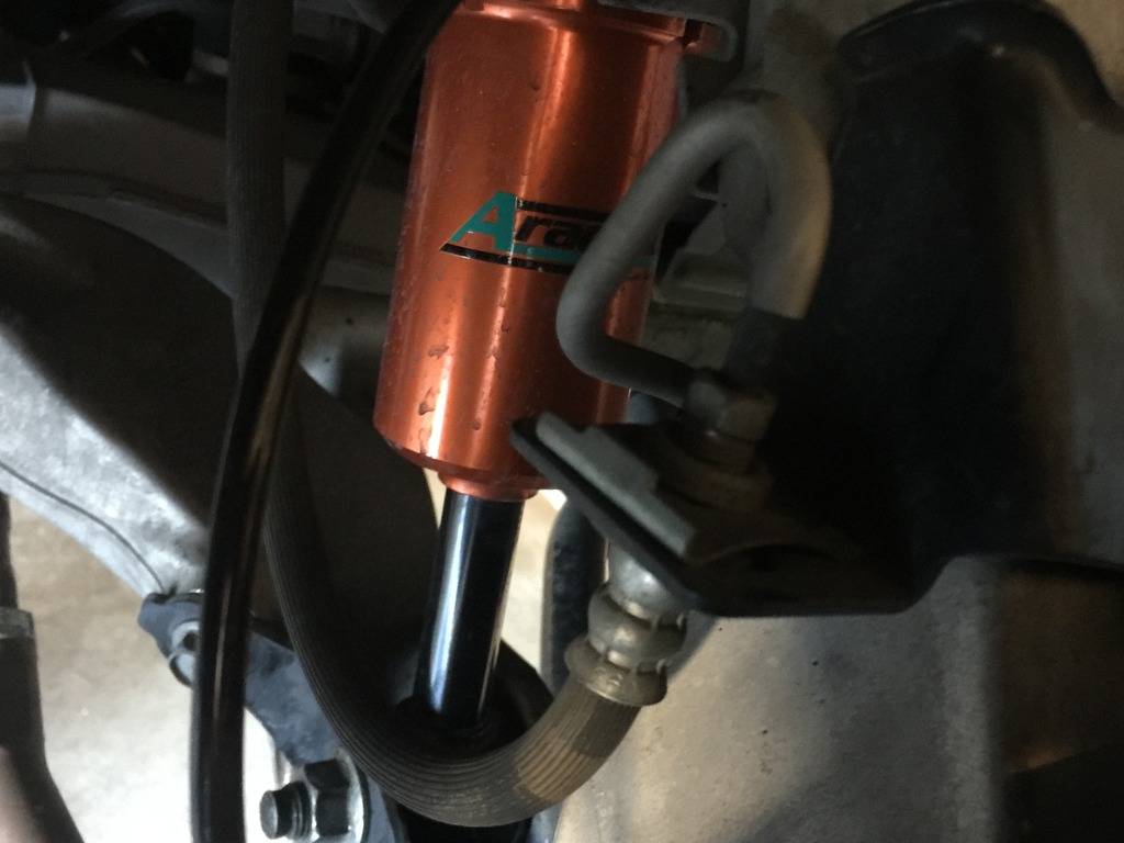

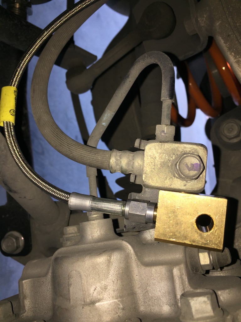

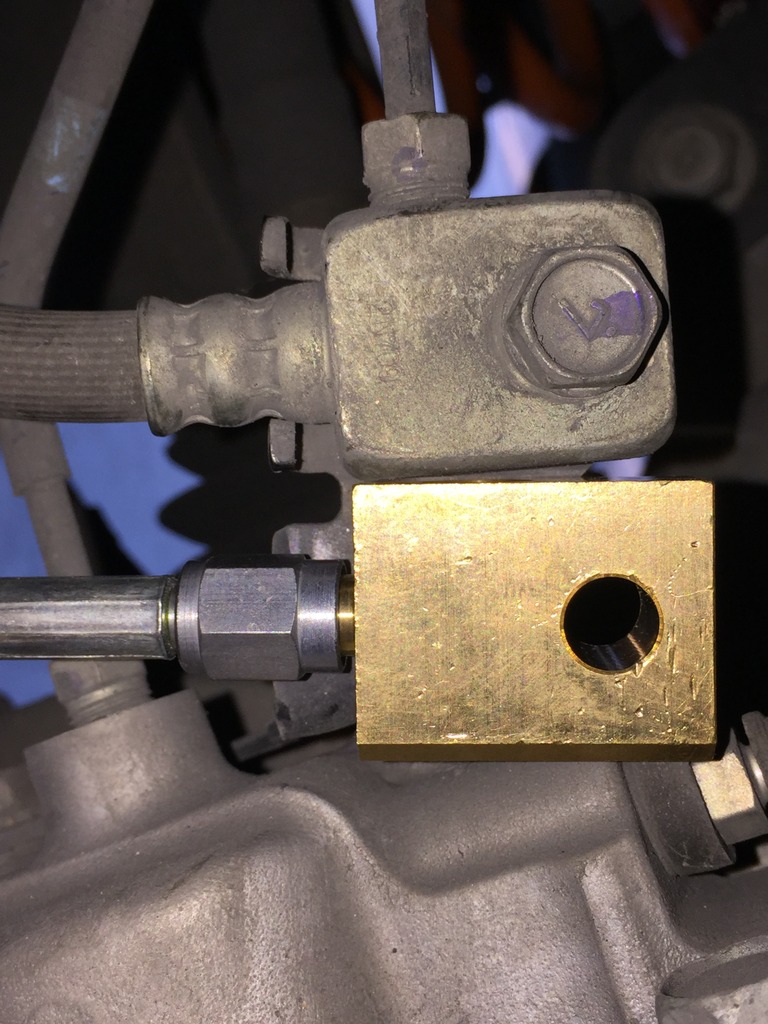

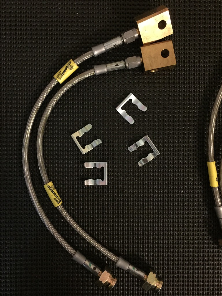

Ok took a look at the rear brakes on Sunday and did some comparison photos. I need to check my vehicle's build date but it is a 2013 and I would assume made in the fall or winter of 2012 at the earliest.
Here are pre-06/2012 rear braided lines from Goodrich.
Here's one end the stock brake line that'll be replaced showing the fitting which is identical to the Goodrich line on the same end.
Here's the brass block end of things, stock and the Goodrich line. Looks pretty much the same, right?
Now here's a closeup. Notice on the stock line, there's a U-shaped "clip" for lack of a better term which surrounds the hose end. But it doesn't actually clip in to anything. It looks like it's there to keep the assembly from rotating when tightened. This is a 2013 MY vehicle.
It looks like I'd be fine using the pre 06/2012 brake line here. Can anyone else see or think of a reason?

Another update, it's not the rears that changed, it's the front. I was going to pull a wheel tonight after work but I'm wiped. I'll get around to it sooner than later but Z1 told me one of the ends on the updated lines doesn't have the block.

Long overdue...here's the difference in brake lines pre and post 06/2012.
Pre-06/2012 Goodrich PN 24-5127
Post-06/2012 Goodrich PN 24-5117
I've only seen one shop that lists both part numbers and that's Welcome To Motorsport & The Z Store! Nissan-Datsun 240Z-260Z-280Z-280ZX-300ZX(Z31/Z32)-350Z-370Z Parts! I've searched high and low for a Goodrich catalog with part numbers and I've never found one.
I made the mistake of ordering the pre-06/2012 lines despite the fact I have a 2013 model year. I thought it was an error on the vendor's part. It's not.

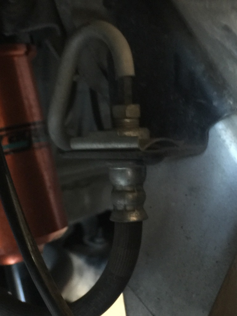

So what's different? The front lines have one fitting that's different.
Here's the pre-06/2012 front lines. If you look at the bottom right of the photo, you'll see the lines terminate in a brass block. On the later model years, it's a straight fitting and it eliminates the brass block.
Here's a photo of that portion of the brake line on my car:
