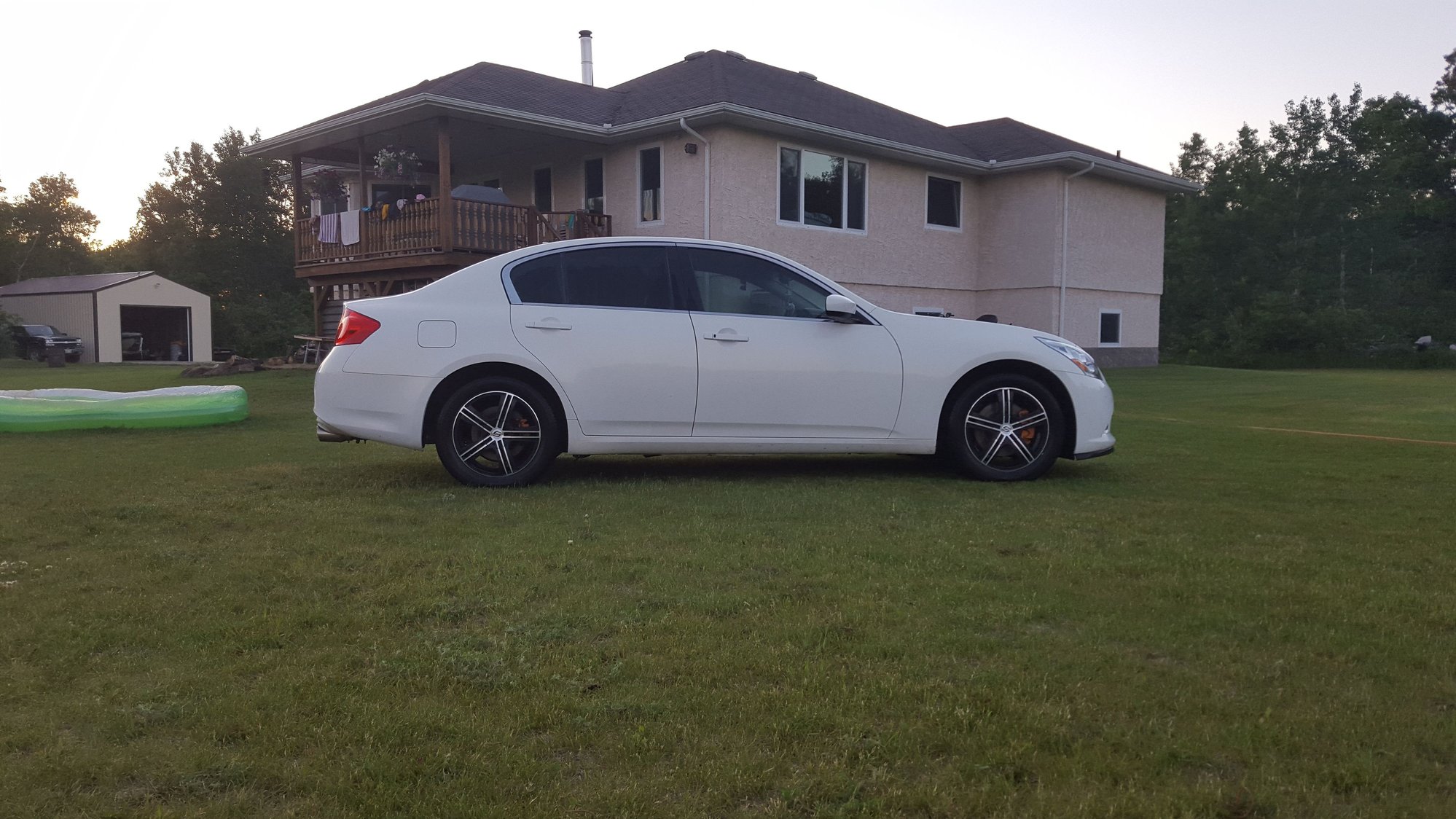

Originally Posted by Swen94
If I drive on the highway or in the city I never scrape. The only time I scrape is on high speed bumps but it only scrapes on the bottom plastic cover that sits very low
Looks good. my plastic cover ended up being scratched to ****, I replaced it with the z1 motorsports aluminum engine undershroud one, I feel so much safer, even though it sounds sketch when you scrape. Highly recommend it.
Although, I agree with you completely. I hate how the plastic cover, as well as the sway bars sit really low, especially my hotchkiss ones, although they are protected by the undershroud now. I wish I could figure out how to make it higher, so the risk of scraping was less, but nothing I can do. I can't go any lower anyway and be okay with the driving, as my tires would rub on turns, which I don't want.
Here's a pic of the shroud, and a side shot. (P.S, I'm on Coils)
