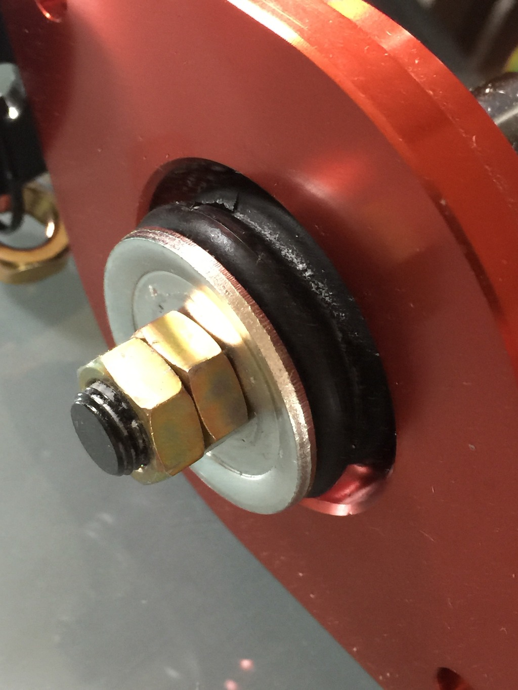

-Aluminum top plates (non-adjustable) with rubber bushings instead of the solid pillow ball.

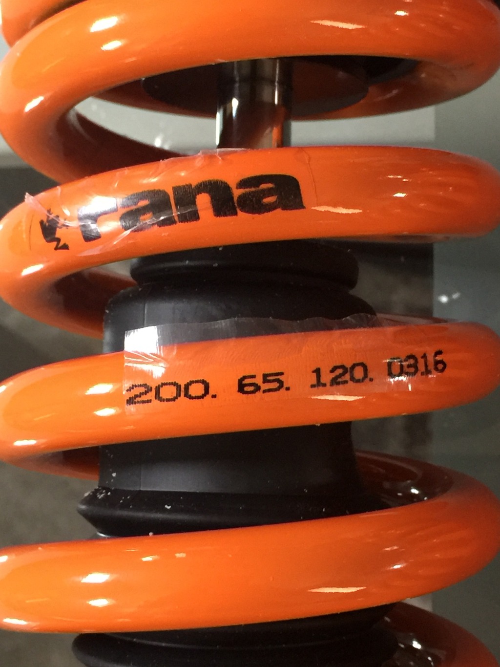

-Rana springs, silicone chrome, cold forged, extremely linear and fade resistant.

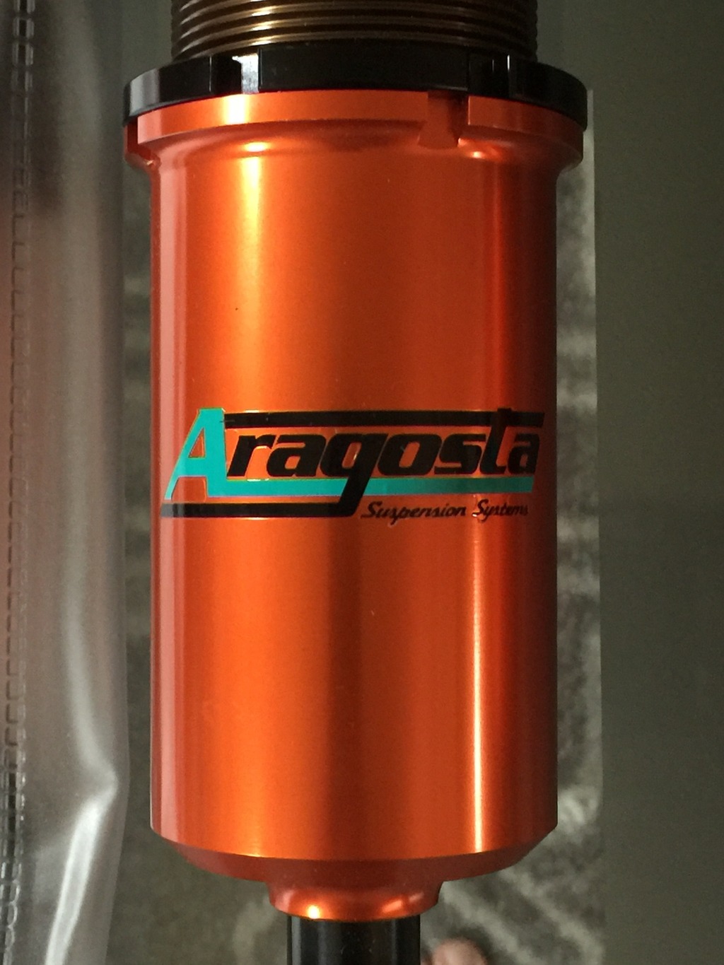

-Forged aluminum cylinder with Kashima coating (molybdenum disulfide applied in an aluminum anodizing process from what I gather to reduce friction and increase durability with a hardness rating of Hv400)

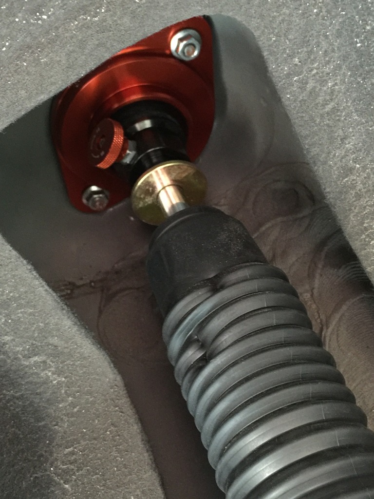

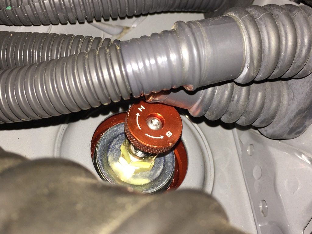

-Rear damper adjustment on the side of the shock body near the top mount. You're able to adjust damping while the shock is still on the car. Extenders are available

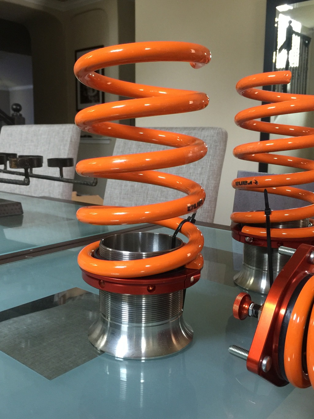

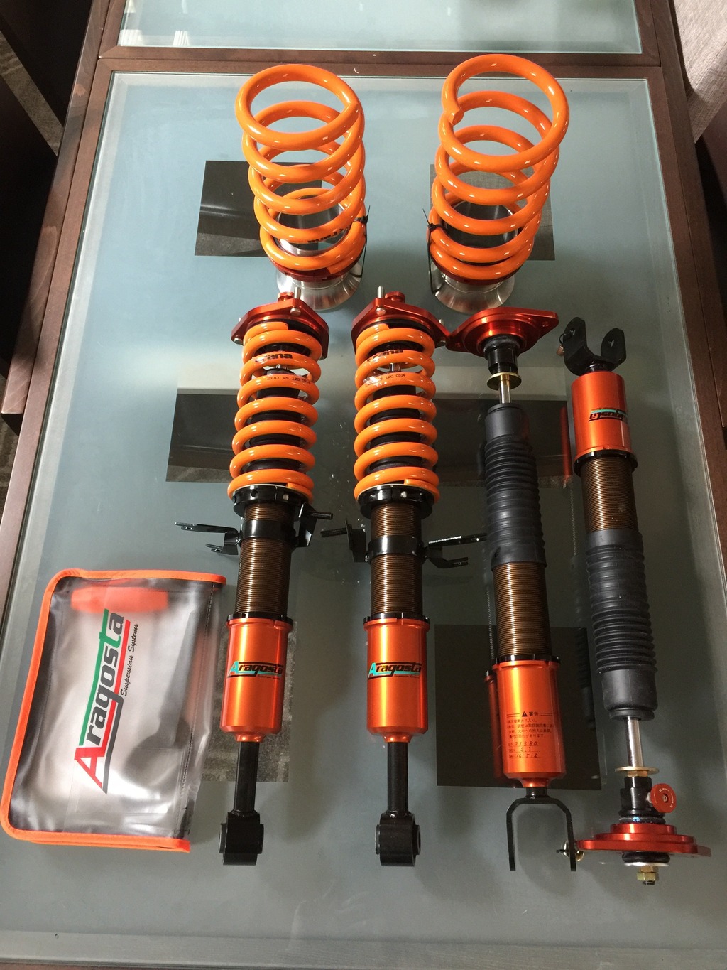

Here's what you get with the kit:

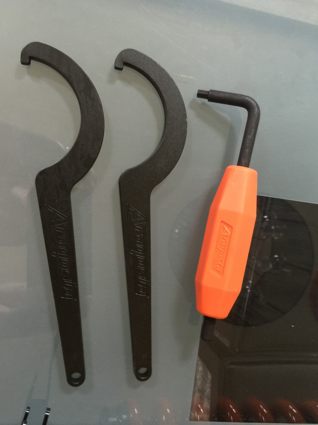

You'll get the four dampers as well as a clear plastic case with two adjustment wrenches as well as a hex wrench, instructions, specs (in Japanese) and blueprints with measurements. You'll also get two black and two gray Aragosta decals.
In this price range, everything is machined perfection and you'll not find a flaw on them. They come with a serial number and a build date.

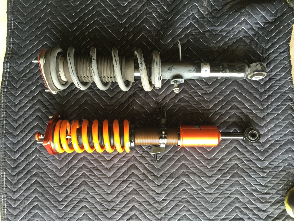

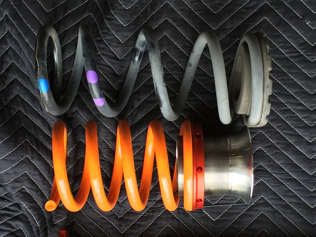

The front dampers are 5 pounds lighter per side than the stock dampers. That's 10 pounds off the front end.
The rear Aragosta is about a pound lighter than the stock Tokico but the rear spring assembly, with it's extra height adjustment hardware, makes up the difference so I broke even out back.

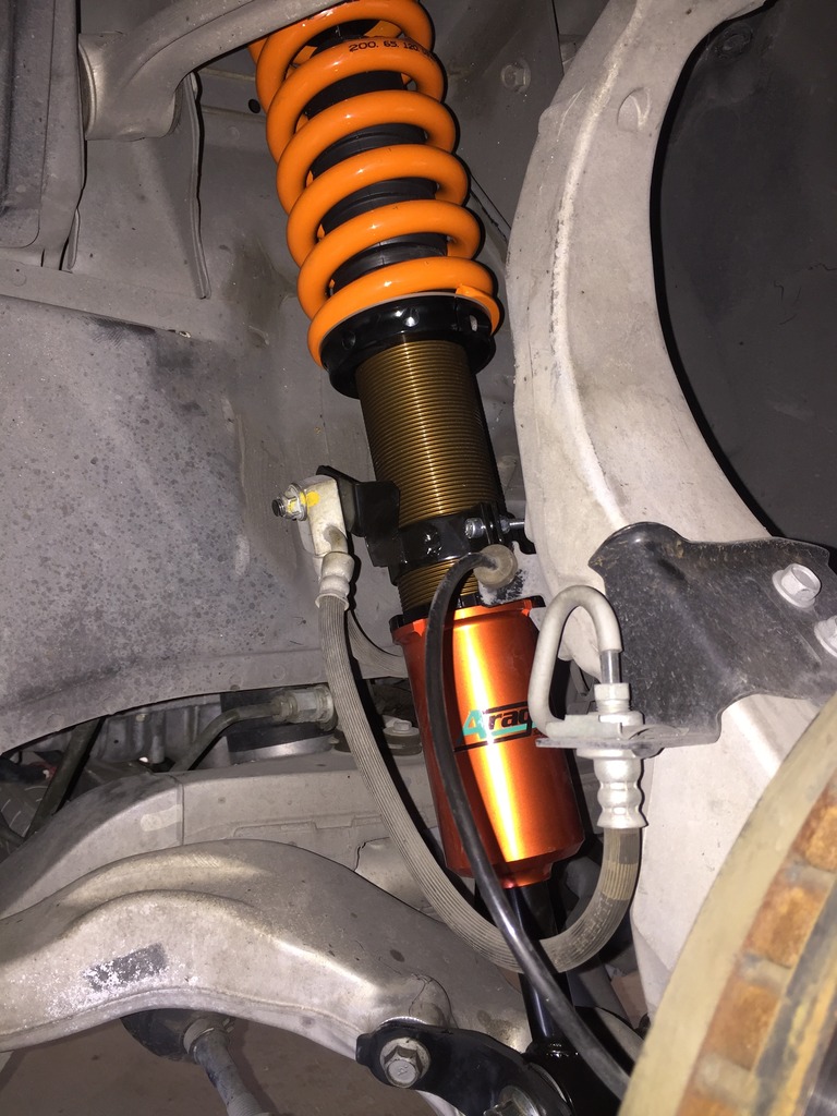

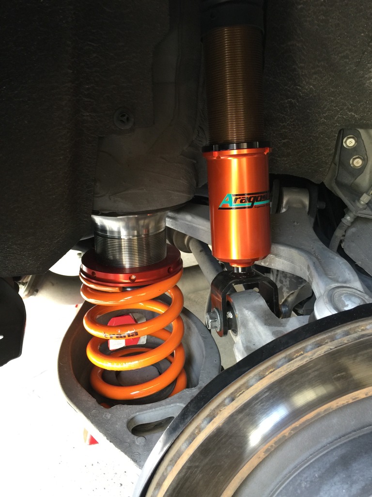

Installation is just like any other coil-over kit and the fronts were already set at the correct ride height and preload. I had to adjust the rears as the stock rubber upper mount was reused and I ended up at the stock ride height. I lowered everything 25mm and run 10mm of preload on the rears.
There were no gotcha moments and everything was very precise and easy to install. The rear height adjustment collar is machined from billet and it looks to be stainless steel. All the collars are machined aluminum and are as light as air.

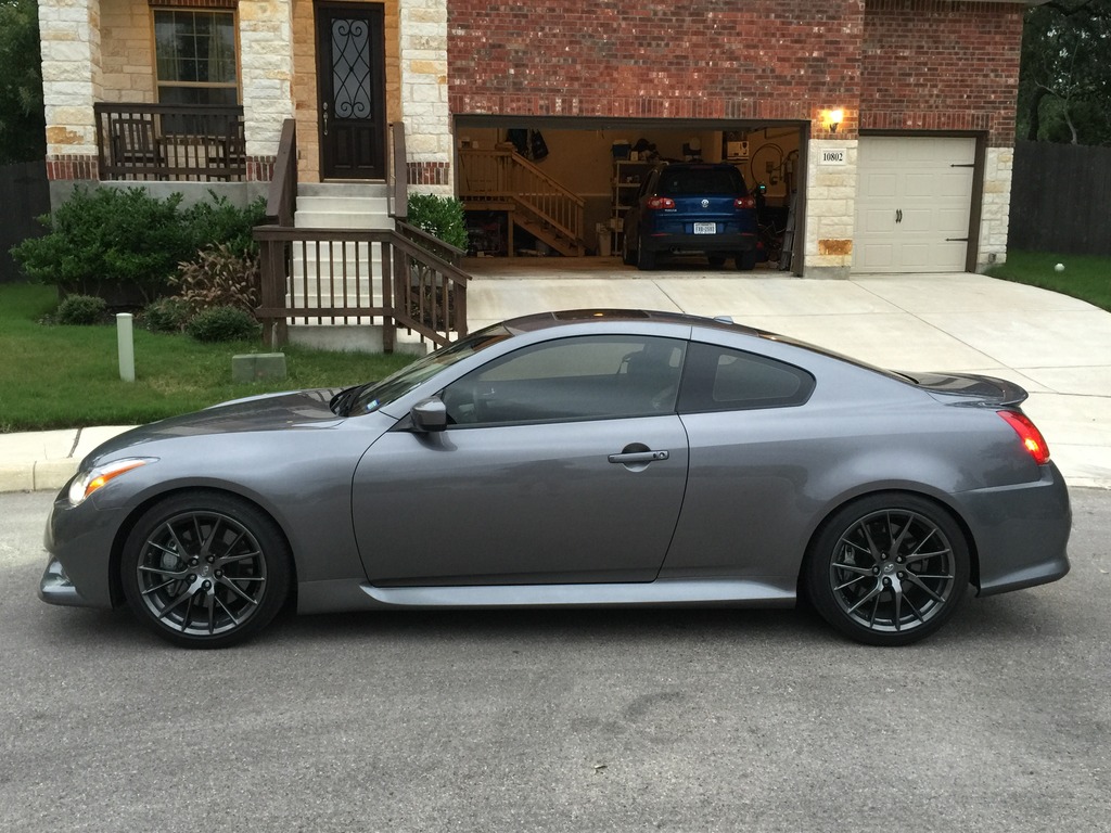

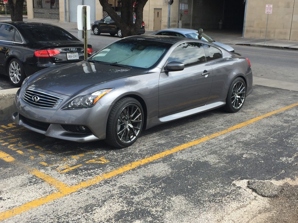

I don't have side by side before and after photos taken at the same angle unfortunately but I'm very happy with the ride height and the stance looks far, far better than stock. I'm into performance improvement and not really interested in being slammed. Plus I have a steep driveway and bad roads to deal with on a daily basis.
Aragostas installed:
Stock ride height:

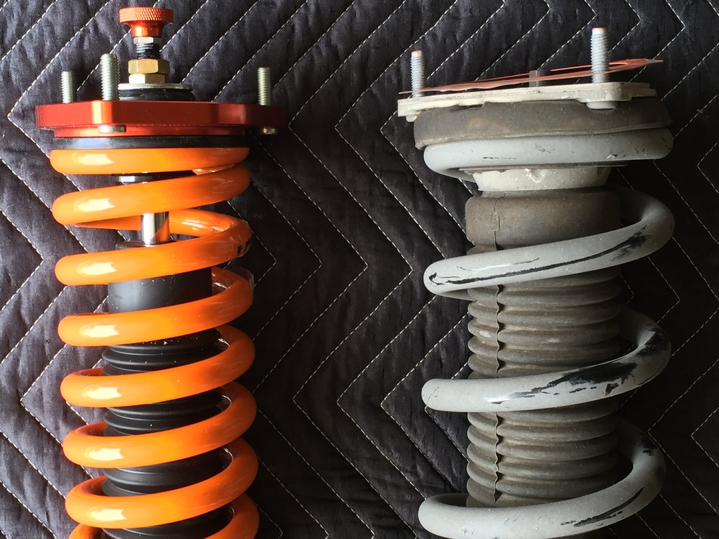

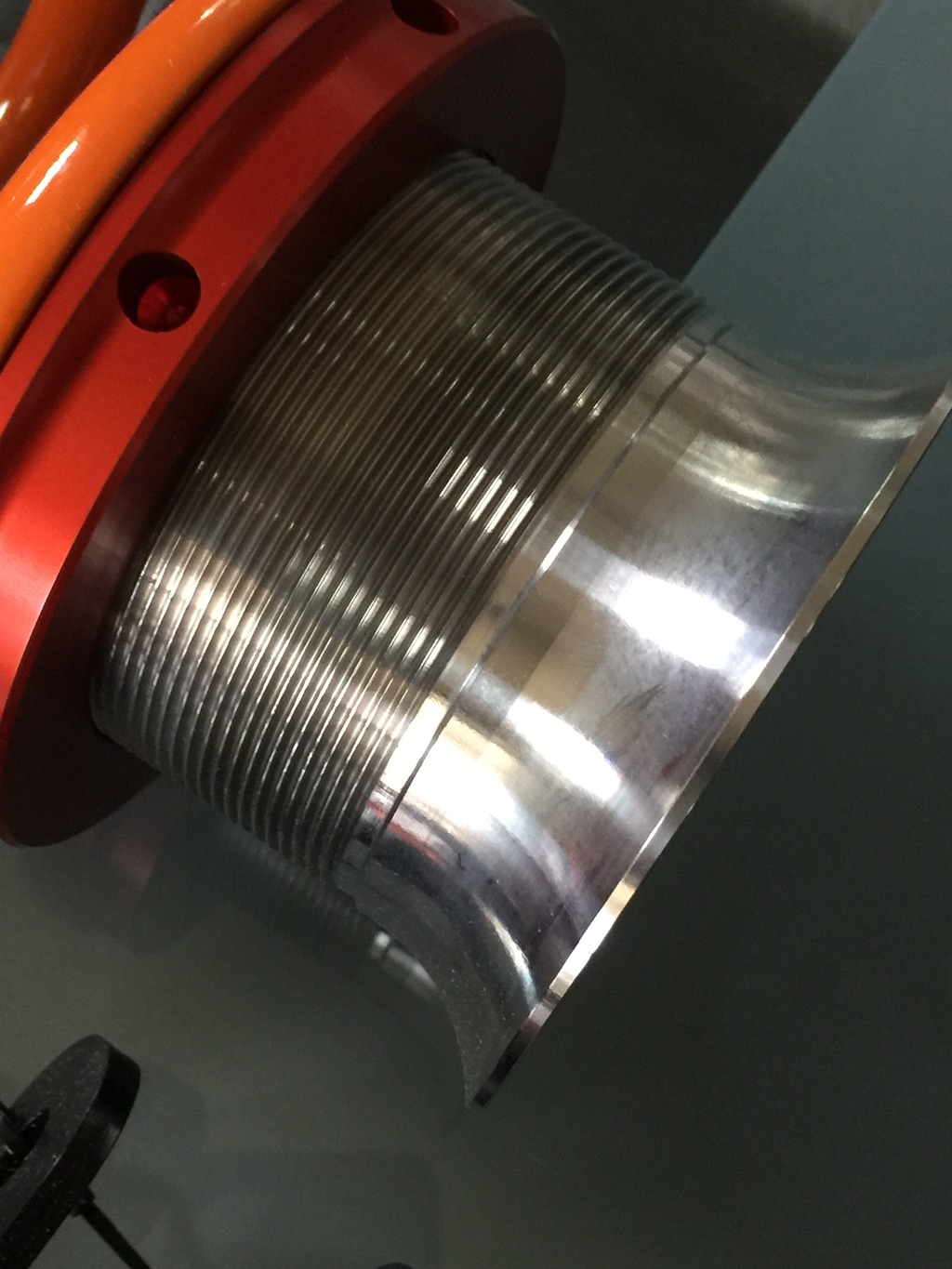

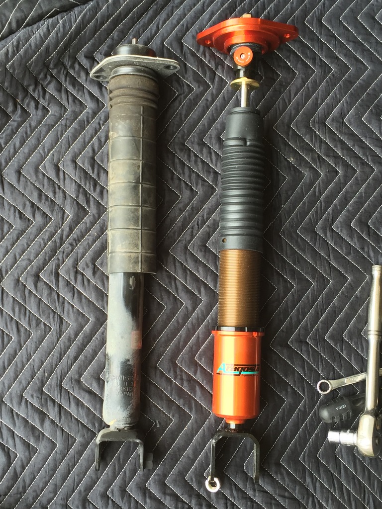

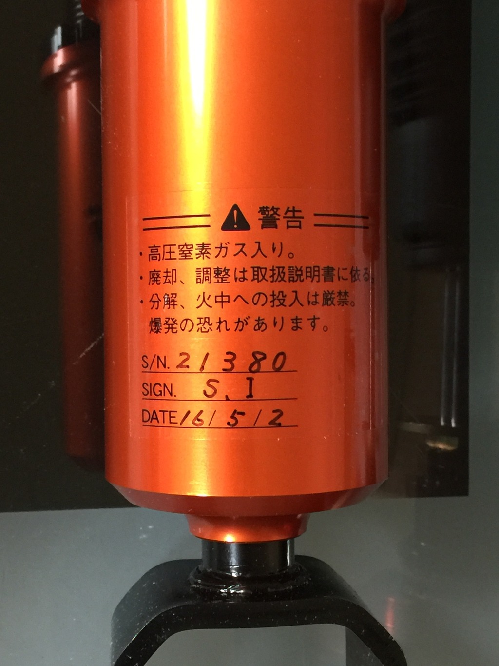

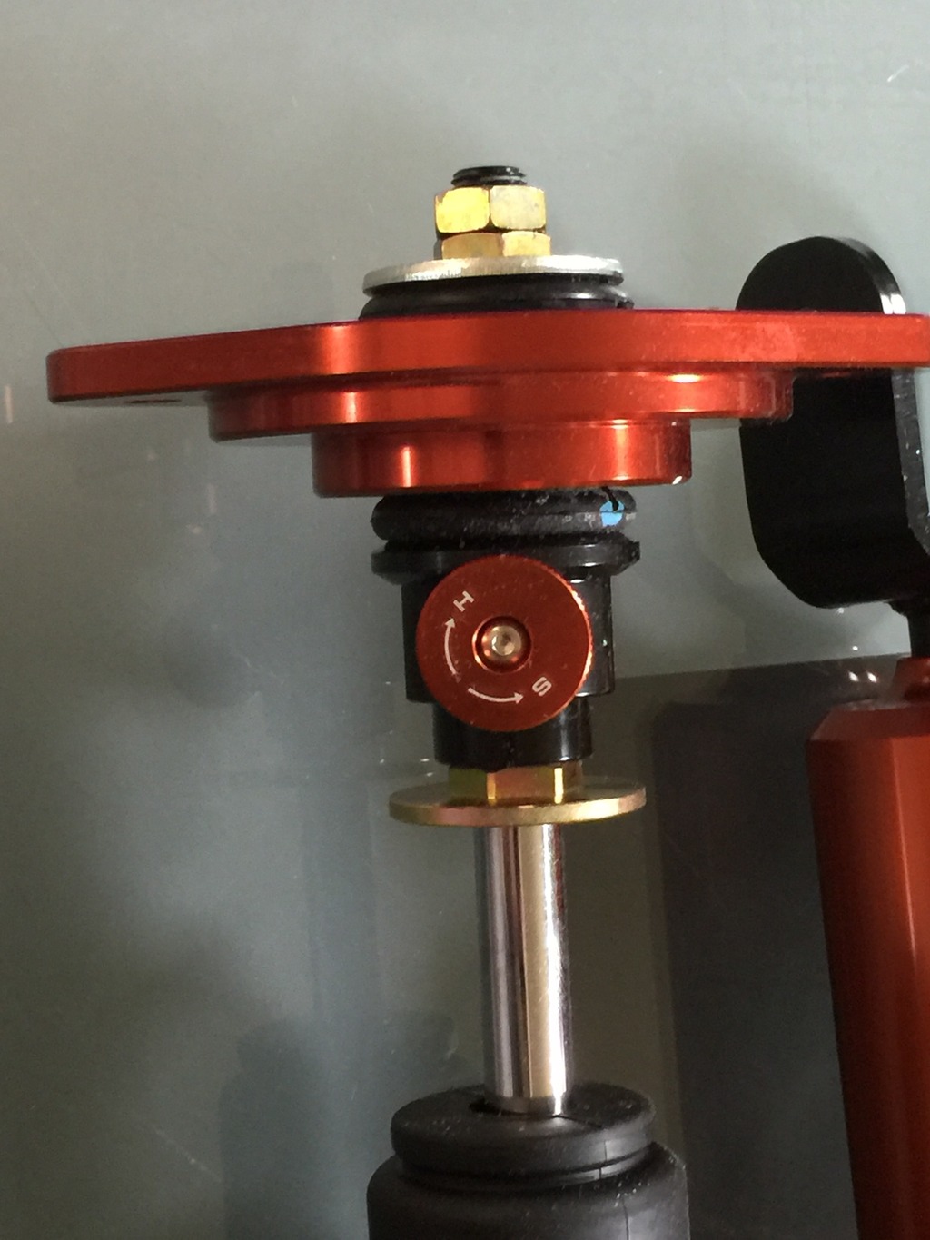

More shots of the dampers before and after installation:

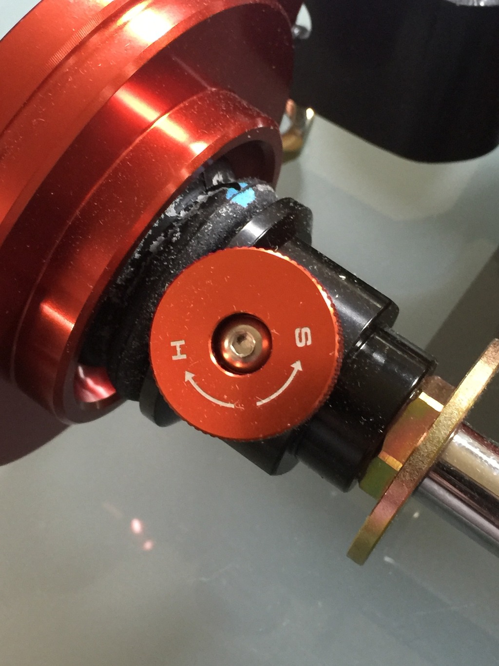

Rear adjustment ****. You do have to jack the car up but it's easy to reach. Plus I have a low profile aluminum racing jack so it's super quick and easy:

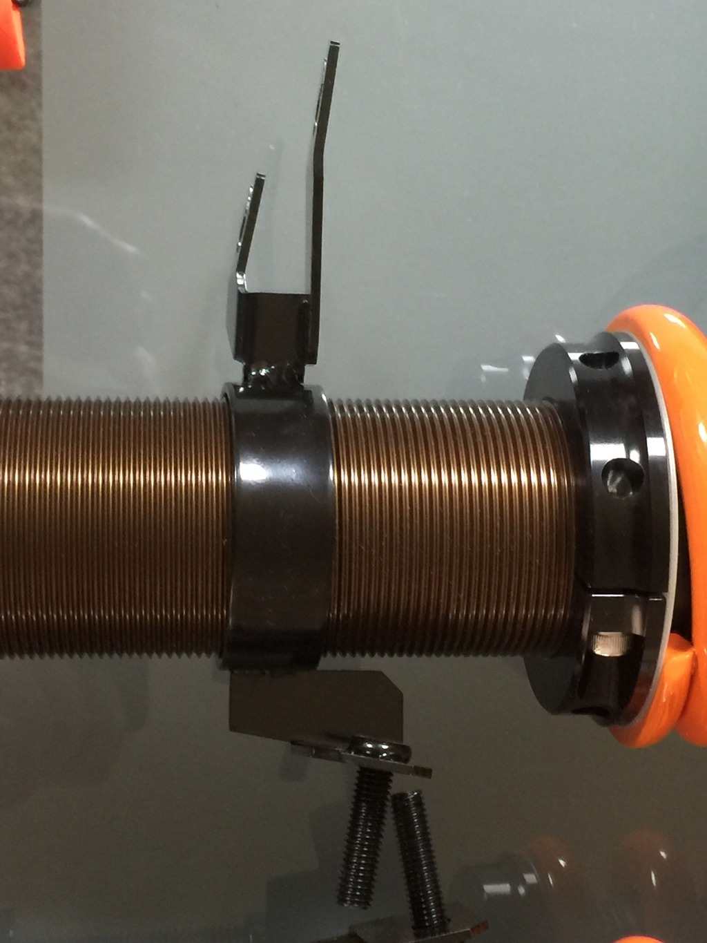

There's an adjustable bracket for the ABS/ and brake line.
Rear spring perch/height adjuster:

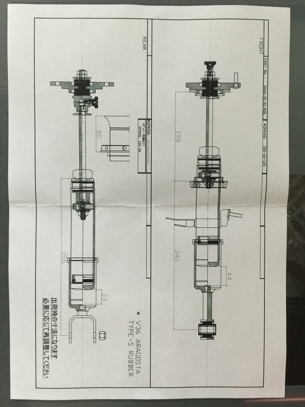

Adjustment tools:
Supplied documents:
Stock ride height:

Adjustment tools:

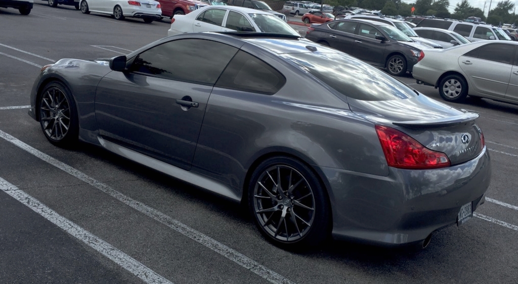

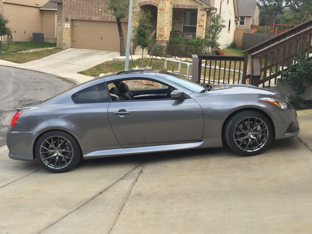

I did stick to Aragosta's ride height recommendations, I actually didn't adjust the fronts at all and did the rears by mistake (but quickly put them back). The driver's side was about 1/16th higher which I figure would even out once I was in the car.
No complaints with these at all. I feel like the mechanical grip went up pretty significantly. The car is just glued in the corners and I don't have large sway bars tying up the independent suspension.
iPhone shot today while out grocery shopping. The fronts look higher than they really are, the top of the tires is actually tucked into the wheel well.
What a sexy looking beast. Those spacers did a good job pushing the wheels out. They look just right. 10mm?
