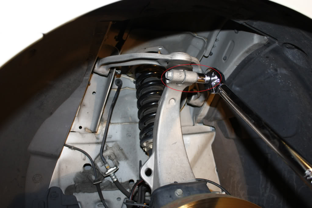

Alright so about 2 weeks ago I went to a shop to make them install my Tanabe NF210 springs.
Got the car, back and everything seemed fine but then today when I swapped out my winter tires for summer ones, I had a little surprise.
As I took out my front left wheel, the upper arm separated itself from the "knuckle". So upon further inspection, It looks like the knuckle bolt wasn't tightened after the spring installation, because I don't have one anymore.
Reference picture for the bolt I'm talking about (from a DIY thread)
So my question to you guys are:
1- Do you know the specs of this bolt and nuts and where I could buy them
2- Can I still drive my car to whatever part store or do I risk killing myself
Thanks!

You're saying that the bolt that's circled in the photo is not currently on your car??? Wow. No, do NOT drive it anywhere. Replace it immediately. Or better yet, call the "mechanic" who "worked on" your car and curse his mother for not drowning him at birth and have him provide the bolt and fasten it properly.

Wow, have you been driving your car w/o that bolt? I wouldn't go anywhere without fixing it, I would think one wrong bump, turn, etc. could leave you with much much bigger problems. I'm not sure on the bolt specs but perhaps take the other side out and take it to a local hardware store to match it up or if you have an Infinity dealer close by give them a call to see if they have one in stock.

I have no clue why your mechanic needed to remove the bolt for a simple spring installation. Are you missing both sides or just one side?
This^^^^ Or were aftermarket camber arms added at the same time??
Just 1 side, and no aftermarket camber kit was installed

there was no need for the mechanic to even remove that bolt from the upper control arm to spindle. the coil over can be removed without taking out that bolt you hav circled in the picture.

Most likely the nut was OVERTIGHTENED, and broke.
The FSM recommends replacing that nut and bolt whenever its removed.
Cheap insurance.
Go to a Nissan dealer, and get a pair from a 370Z.
Torque to 41ft lbs

Got everything fixed now, still alive, amen
