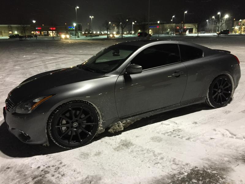

Here is my car with my old wheels and Eibach springs.
This snow plow is brought to you by Continental DWS tires, Forgestar Wheels, Eibach springs, and AWD:
