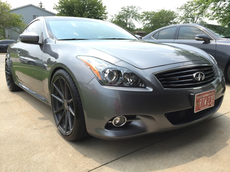

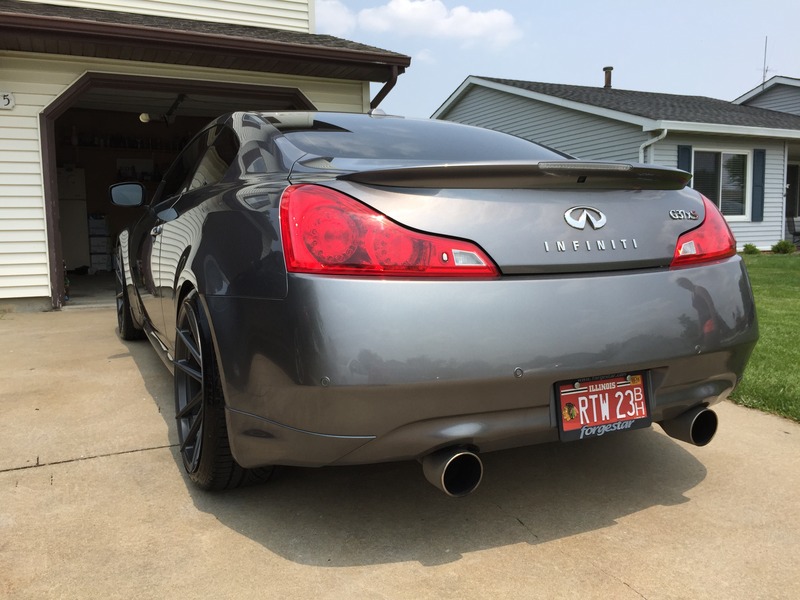

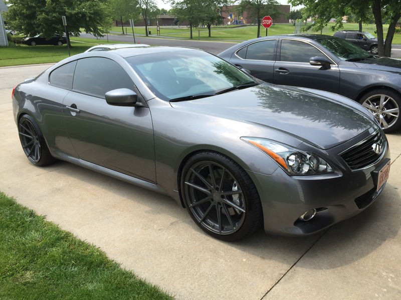

Yes, you can lower an AWD as much as you want, there are several sets of coilovers available, including the newest being Fortune 500, which has a Swift spring option. I went the Eibach lowering spring route and have been very pleased. A lot lower than stock but never scrapes. Fender to ground measurement settled at about 26.75" all around. Ride quality is not far off from stock and I've had the setup for a while now.

Just keep in mind you have a transfer case to deal with which you really don't want to have slamming on concrete. Ryne has a nice stance w/ his and should be pretty easy to get around daily obstacles. I wouldn't drop much more than 1.75" w/ the AWD, but I'm an old geezer, so there's that.......

I want my car to look just like that, no noticeable gap like there is now. Just worried about ride quality, but you say it is close. I'm not sure what close means, is it harsher over bumps? What about riding along a nice road, is it still smooth and quiet? Thanks.
