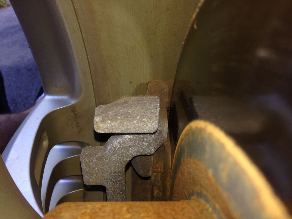

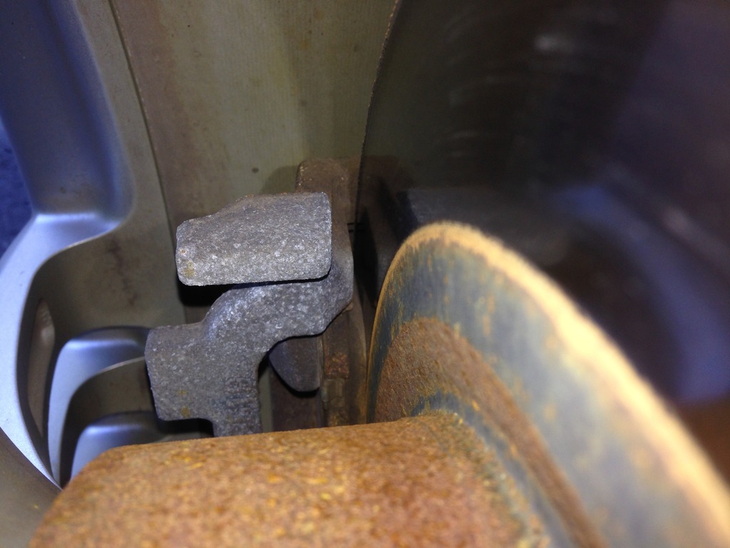

I got the car with 18K miles on it. From the 18K mile mark to now (33K miles) I have driven it on the highway 90% of the time (going against traffic, cruise control, minimal if any braking). Before I got the car at 18K miles I don't know how it was driven.
That all said I drive very passively, light on the breaks, cruising to stops. So yes replacing the brakes on this RWD car at 33K seemed a bit early to me too.
Without taking the wheels off here is a quick pic of the rear drivers hand side outer pad
They look 'ok' to me, I will try and measure now. Thoughts?

Doesn't look like you even need to mess with em.

If you only have 4 more months to own that car don't do anything to the brakes. Plenty of miles lift in those pads.
Ditto. They still have a lot of meat left. Not sure why you need to replace.

Those rears have about 40% pad material left.
You need to inspect the fronts. Front pads wear out faster than rears.
Also you don't need to buy new rotors. All independent shops will always tell you that you need new rotors for the brake job but they are only trying to get money out of you. Trust me I used to work at a shop for 2 years.
Yeah there are a few cars that came in that really did need rotors because the pad material worn completely and it was metal on metal contact and screwed the rotor surface up, but in your case with only 30k miles a rotor replacement is not necessary.
I have a 08 Acura TL with 94,000 miles. Still on factory front and rear rotors. Front pads have been changed twice. Rear pads changed once.
I don't know how true the posts regarding rear brakes wearing faster than the fronts are especially under light braking due to the VDC applying heavier on the rears to help maintain level braking. But there have been more than a few claiming rears going out much faster than the fronts. Especially with the OEM setup.
