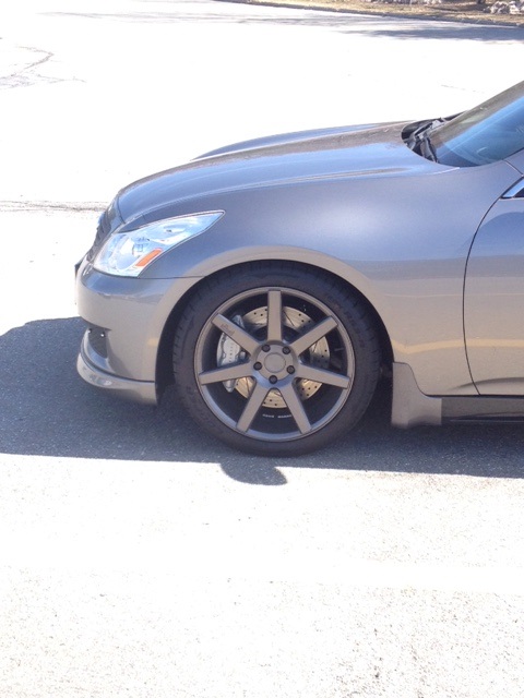

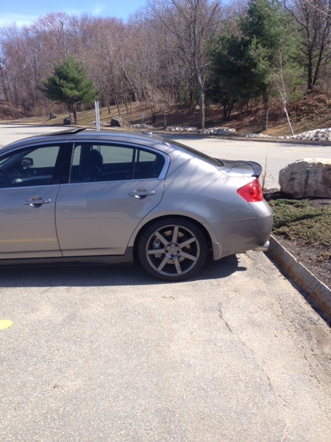

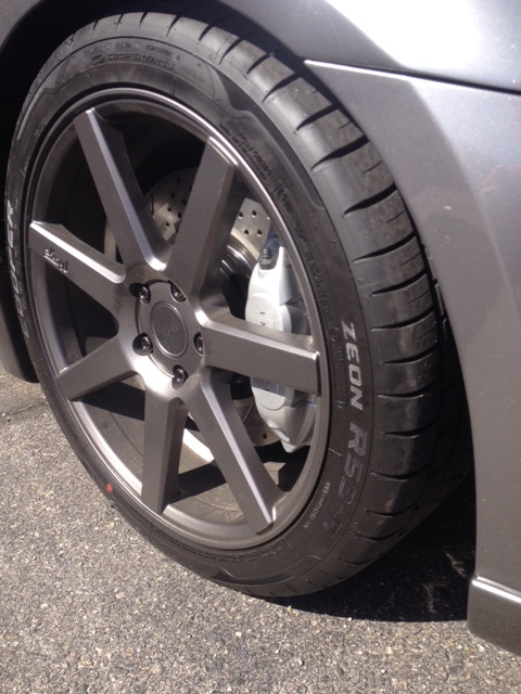

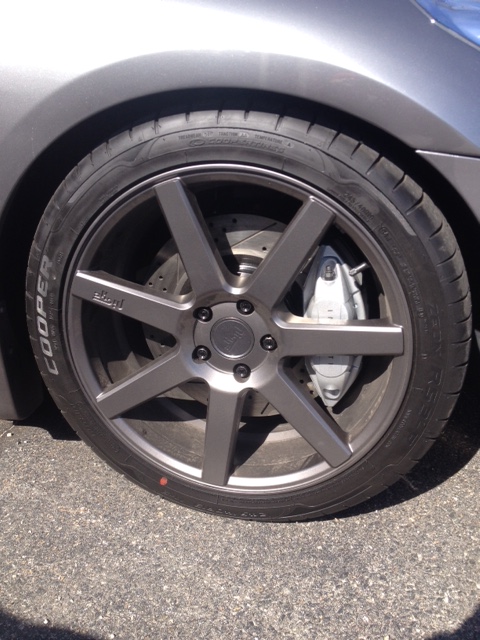

Install went smooth, No issues with clearing the wheels and looks awesome!! Some quick shots when I got back to the office

might want to check your rear caliper as i think it is installed the wrong way... some of these rotors are directional and your rears are the opposite from your fronts...
i put stoptech on mine and had L and R stamped on them... it has something to do with the cooling chambers in the rotors...

Run that by me again, the caliper or the rotor? The caliper is in the stock location .Not sure how it could be installed wrong, and the caller boxes had left and right on them.

I don't think he meant the caliper location but rather the direction of the slots on the rotors. Could be the pics but the direction of the slots seem to not match. Great upgrade as I'm thinking of the same package myself.

yeah i meant the direction of the rotors, the direction of the slots does depend on manufacturer but your fronts and backs are not same direction so i figured one of them may be on the wrong side.
i put on stop tech rotors on mine and i know they face forward.....
it doesnt affect stopping power, but does affect the rotor life as they are not cooling as efficient as they should.

Actually, you know I didn't notice it the first two times I looked but yes, that rear driver rotor looks like the slot is backwards. The front driver looks fine. Might be good to just double check that with the folks that installed it for you. It was very hard to see it as it is a small photo and not a close up. Good catch, tbulsara....

Damn lol you guys have better eyes than me lol, I never noticed it till now . I'll ask the guys at Z1 also . Thank you !

Thanx again guys , Checked with Z1 and the direction is fine. There are " backwards" the rears but not issue at all cause the rotors are 1 peice , wth I had 2 peice or a race application it be a issue. I just have them flipped next time I'm at the shop. Caus now I noitice it ! Lol thanx
