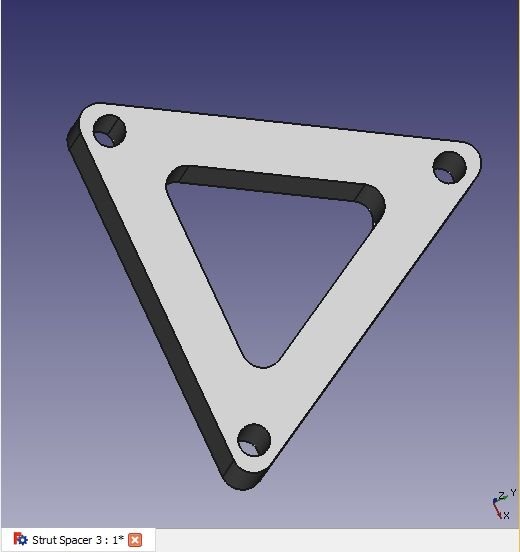

Or as an alternative, can you post up measurements or a schematic and then it would be easy for people to go to a local machine shop and have a set made?

Well, I found a local machine shop, took some measurements, generated a CAD file and I'm about to have a set made for myself. If anyone else wants some spacers, let me know what thickness and I'll let you know the cost and get them done for you along with my pair.
The spacers will be pretty close in design to the ones in this thread, but not identical. they will look like the attached model.

All done here. If anyone wants to have their local machine shop make a set, PM me for the DXF CAD file and I'll gladly send it to you.

Would you need longer strut top mount bolts to account for that additional 1/4" spacer?

I did an inch thick spacer and with that I did need longer bolts.

Cool, did you just find similar thread/pitch bolts at like Ace Hardware or....?
