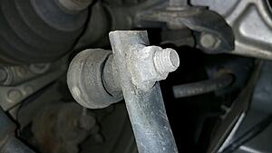

Where's the pics of the bolts on the end links? Those are the ones I'd be concerned about.
Mine is a rwd, so the front bar was 10 minute job (more or less). At the time, I still had the stock exhaust. Had to angle the bar in different directions as it got worked around the exhaust.
If you're going to mess with the exhaust, dropping the mufflers is pretty easy. Don't lose the small gasket between the midpipe and muffler flange.

The end link bolts looked good compared to the exhaust. I have a few pictures, and this looks like the worst of the bunch. All bolts and nuts were hit with pb blaster this weekend. I'll hit them again before I start.
