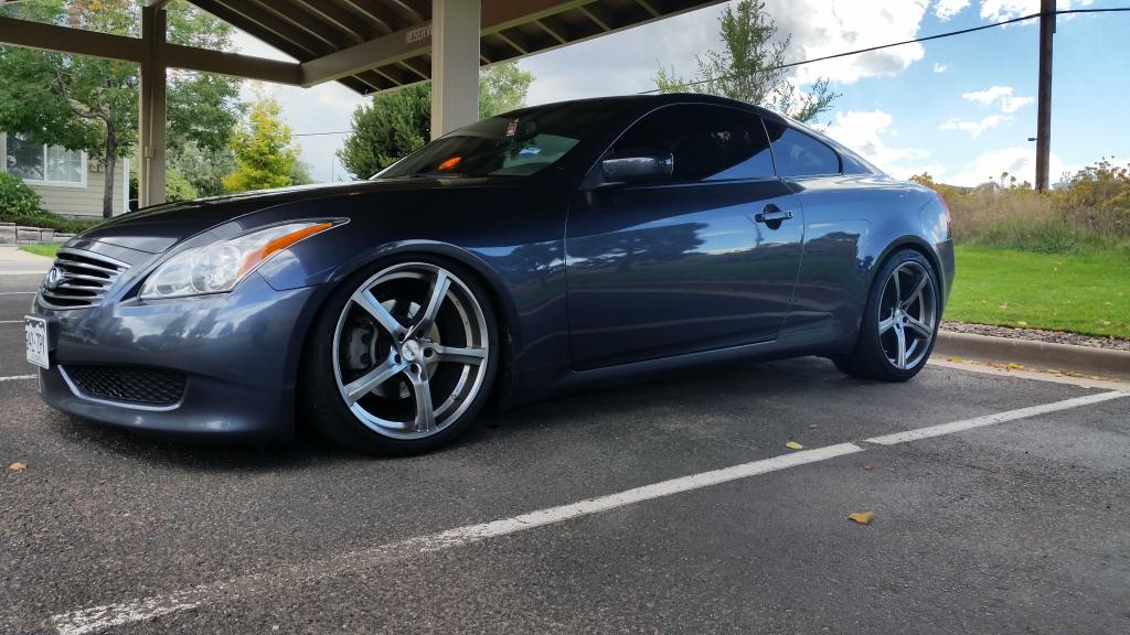

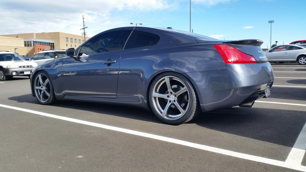

Ride Height:
So I initially didn’t tamper with the height of the shocks and got a rather interesting combination F/R ride height. My front was sitting at around 25.6” ground to fender while the rear was at 28”. At this point, my undershroud was scraping so hard you can see everyone looking at the car like it’s broke. I got the undershroud fixed within a week and it was only scraping on bumps. At that height, there was no clunking noise whatsoever from the rear and I could finally drive in peace for the first time in a year. I love the adjustability range on these. The front could go even lower and can go to about stock height, while the rear tops out at about stock height but could go a lot lower than you would ever need.

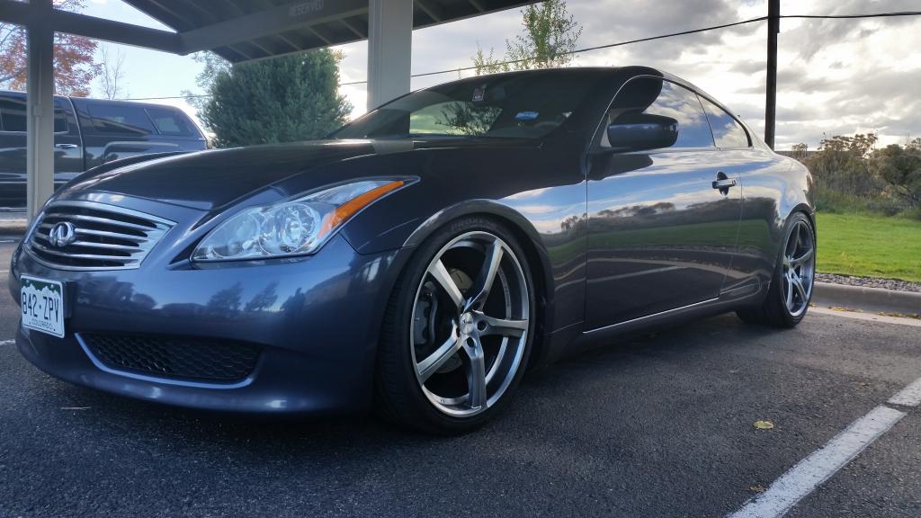

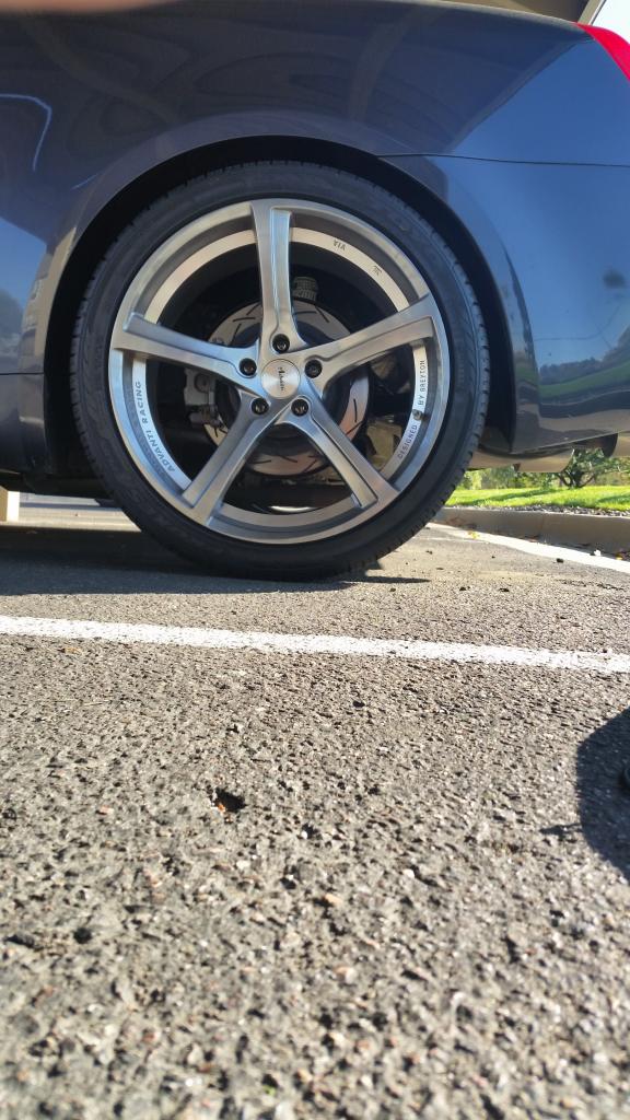

After about 2 weeks, I decided to adjust the height and got them to around 26.5” all around. The car, as you can see below, looks really nice. At this point, the rear started clunking faintly but persistently. Over the course of 4 weeks, the clunking had reached around the level of BC Racing. Disappointing, I know, but I am too tired and busy to actively try and fix this.

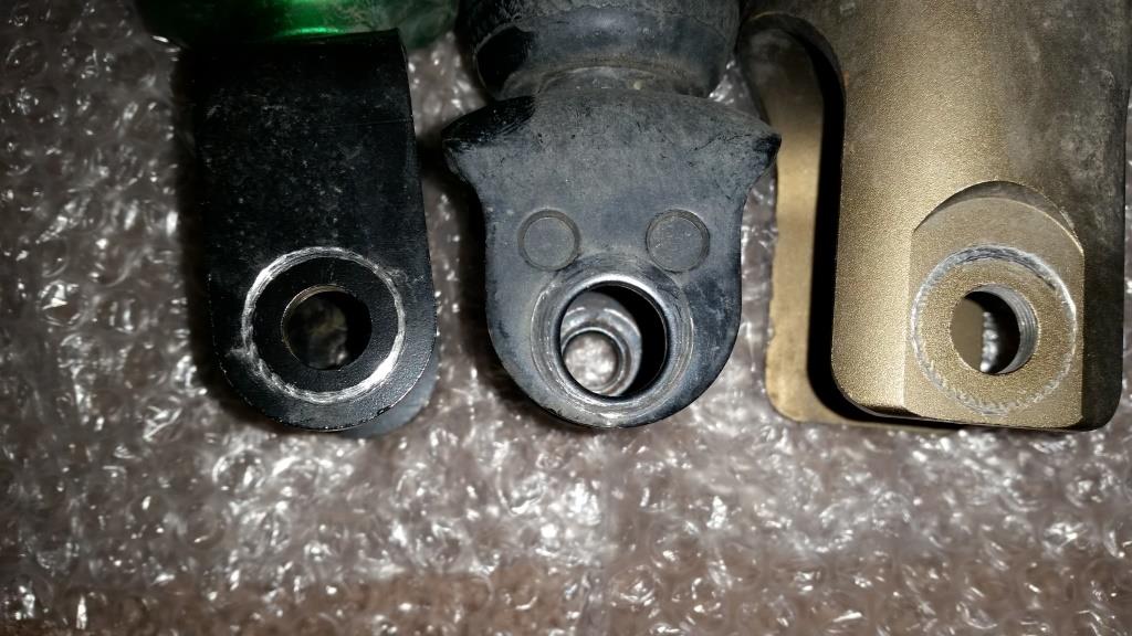

A few days ago I talked to Fortune Auto about the noise and they told me to send the shocks back to them for inspection. While removing the right side I noticed that the shock was not aligned with the control arm and the bolt would not install/remove easily, but with the stock shock, the assembly was lined up perfectly and the bolt could easily pass through the shock and the control arm.
I noticed two things, the stock shock has a larger hole at the lower mount as in the first picture (Left to right: Fortune Auto, Stock, AMR) and the stock top hat can slightly swivel to allow alignment while the other ones did not allow that.
I will probably send the shocks back on Monday and ask Fortune Auto to install pillow-ball bearing top hats along with widening the lower bolt hole. Does anyone know if pillow-ball bearing cause more noise?

I don't but I really look forward to your update on this.
