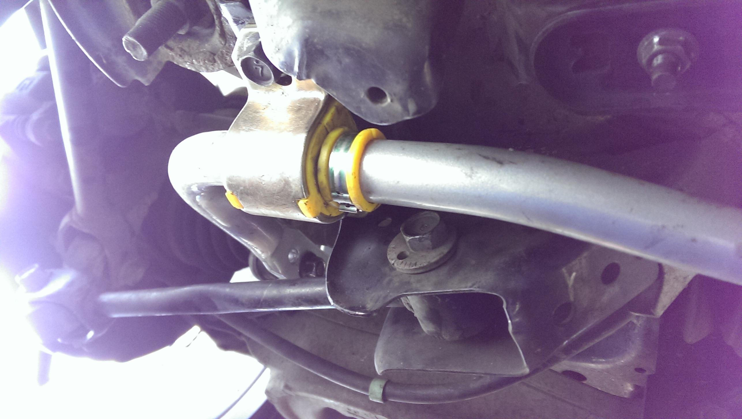

Just installed Whiteline rear sway bar on my x & Wow it feels alot better. I def. feel more confident going into turn at higher speeds. Alot less body roll thats for sure. Took me about 2 hrs to replace... had to drop the Exhaust a little, to make it easier.

That's pretty sweet! How much did you get it for? How thick is it?

$200 shipped, 24mm
