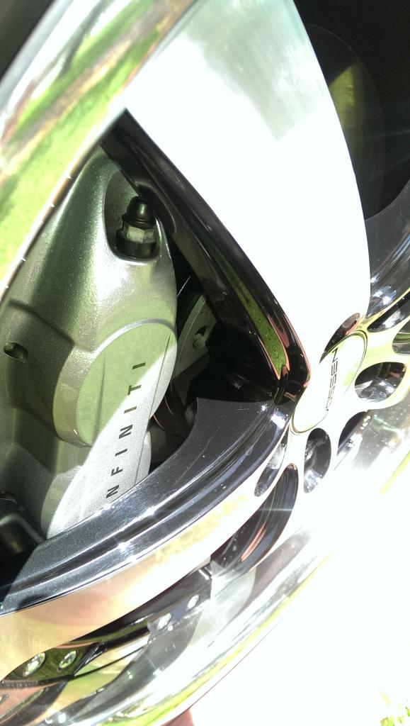

Originally Posted by AUR11
It might be the style of your wheels, the oem GTR wheels clear them and they are +45. But yes he knows a lot about that stuff.
Here is a picture of my fitment. It may just be my wheels. I'm no expert on fitment. LOL
