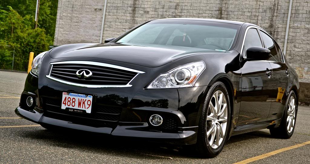

I'm 50 yrs old, and I just lowered my 6MT on Swift Springs. And if you knew anything of what I've written or said over the last decade, you would be rolling your eyes in disbelief, or just laughing straight in my face, deservedly so.
Never say never, man.
Like John, I too am 50 yrs old...later this year that is.
I've been modifying my cars ever since 1994...I've never owned a "stock" vehicle.
I do lower my vehicles for both performance/handling & appearance.
There is nothing "wrong" with lowering your vehicle as long as it's done correctly and safely.
The choice is always up to the owner's discretion.
