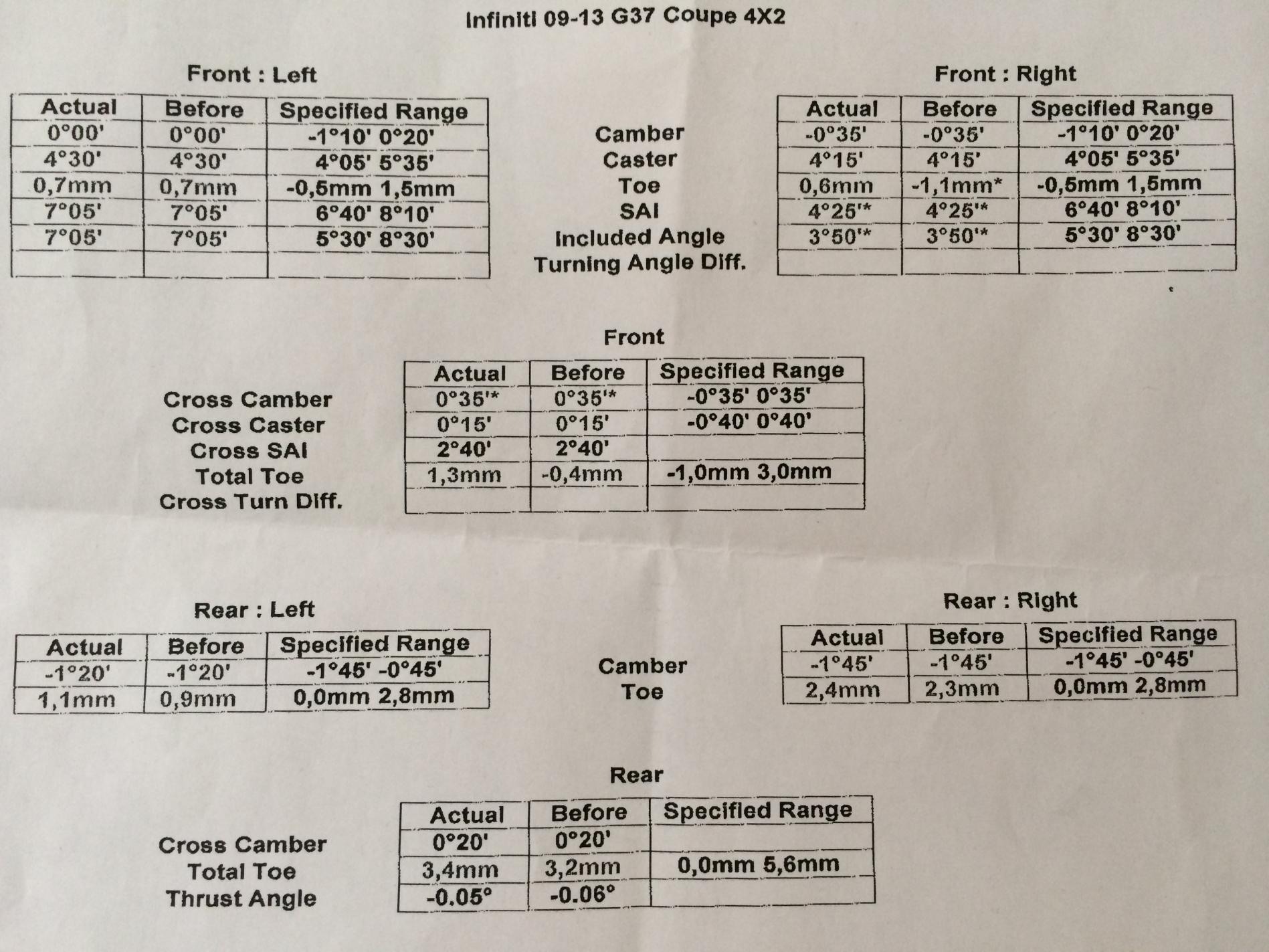

I got an alignment recently and noticed that my right SAI and Included Angle are out of spec. Camber/Caster/Toe are in spec. Car does not pull. The tech said everything looks normal. I had another body shop tech look at the printout and was told it would be difficult to determine the reason given the rest of the alignment specs. I did bump/roll up on a curb in a parking lot (going 5mph or less) with the front right tire at about 45 degrees 6-7 months ago. Had an alignment then to fix the steering wheel being off-center. Currently waiting to get a copy of the specs to see what the SAI and IA were back then. I am thinking that either something is damaged or there was operational/calibration error with this machine. My question is...if there is damage what could it possibly be given that all other specs are ok?
I am planning to get coil overs and aftermarket arms soon but wanted to address this issue before I start swapping parts.
Right now I am thinking about taking the car to a body shop and having them take the necessary measurement to try and identify the problem (if there is one).
