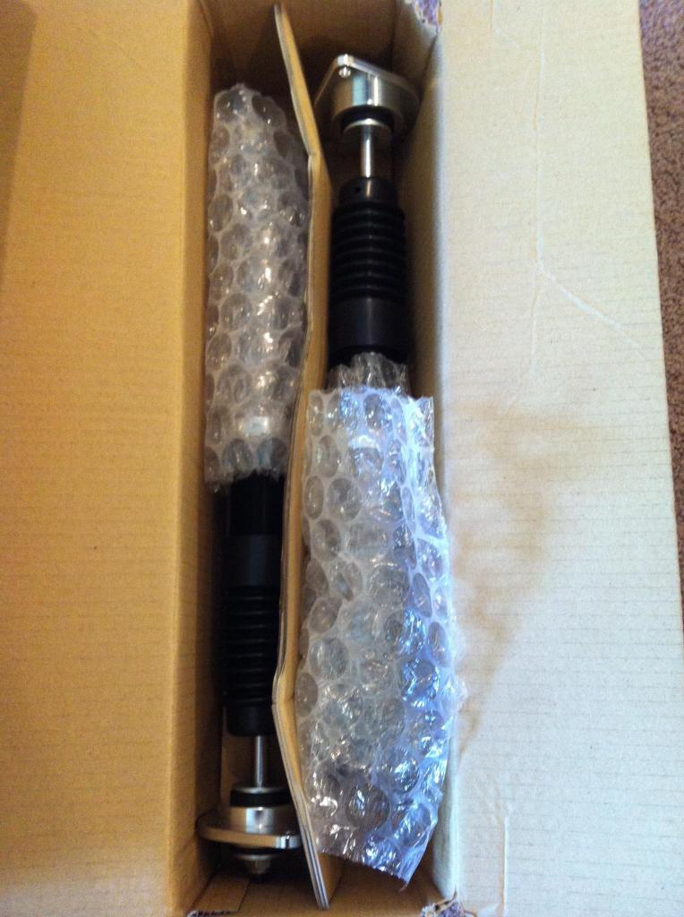

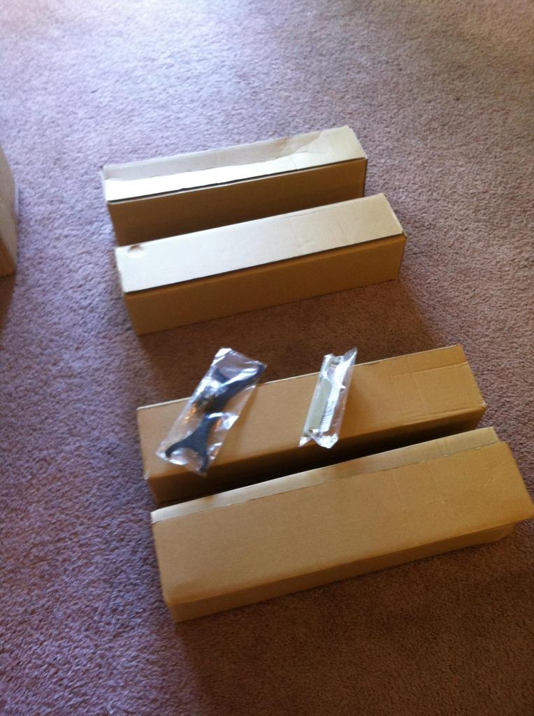

Packaging:
Excellent packaging in my opinion. The coilovers came in double boxed and bubble wrapped for protection, which really helped protecting the coilovers from the USPS’ bad handling. Package weighed 40lb.

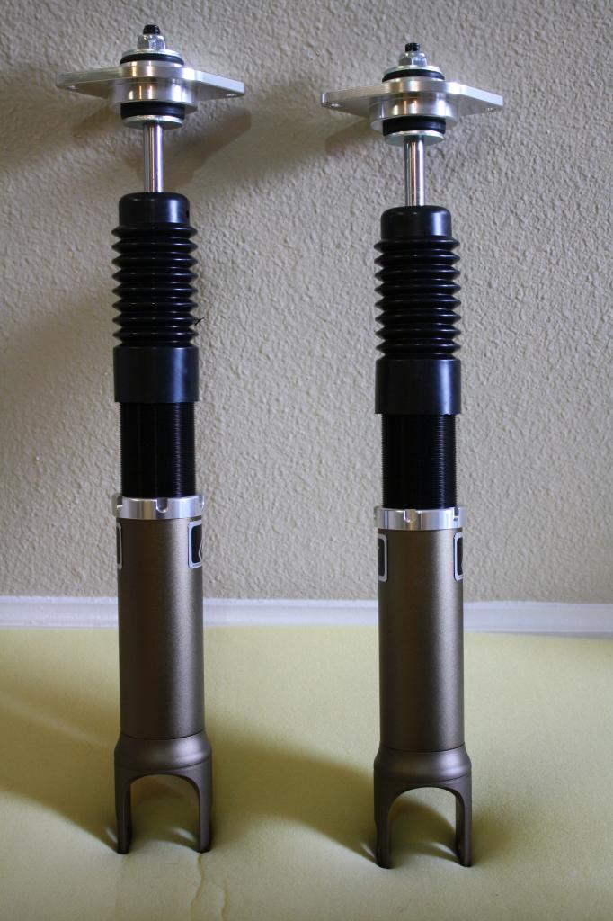

Machining:
These coilovers are machined with stunning precision. I have to say, hands down, the best machining I have ever seen. All the edges are sharp and flow incredibly smooth. I actually spent hours just looking at the machine work and trying to find flaws but could not. AMR Engineering uses Hyperco springs with spring stiffness according to your need. Mine were 650 F/450 R.
Enjoy the eye candy below!

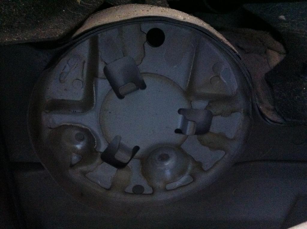

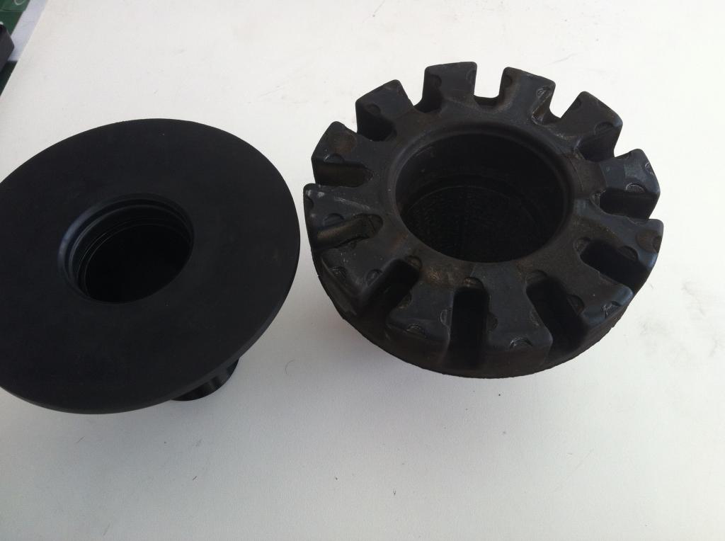

The install took about half a day because we ran into a problem. The rear spring top isolator did not sit in the spring mount as there are three tabs to hold the oem isolator and the top isolator is too small. see below:
I talked to Andy at AMR Eng. about the problem but he did not have a solution at that time. Later next day, Andy told me there was supposed to be a cutout template for the top isolator supplied with the package, which I did not receive. We decided to hammer those tabs and install the rear spring. I feel really disappointed that the top isolator did not come precut. I thought this product was specifically designed for the G37x. How can such problem not be accounted for?
Other than that, the installation was a direct fit.

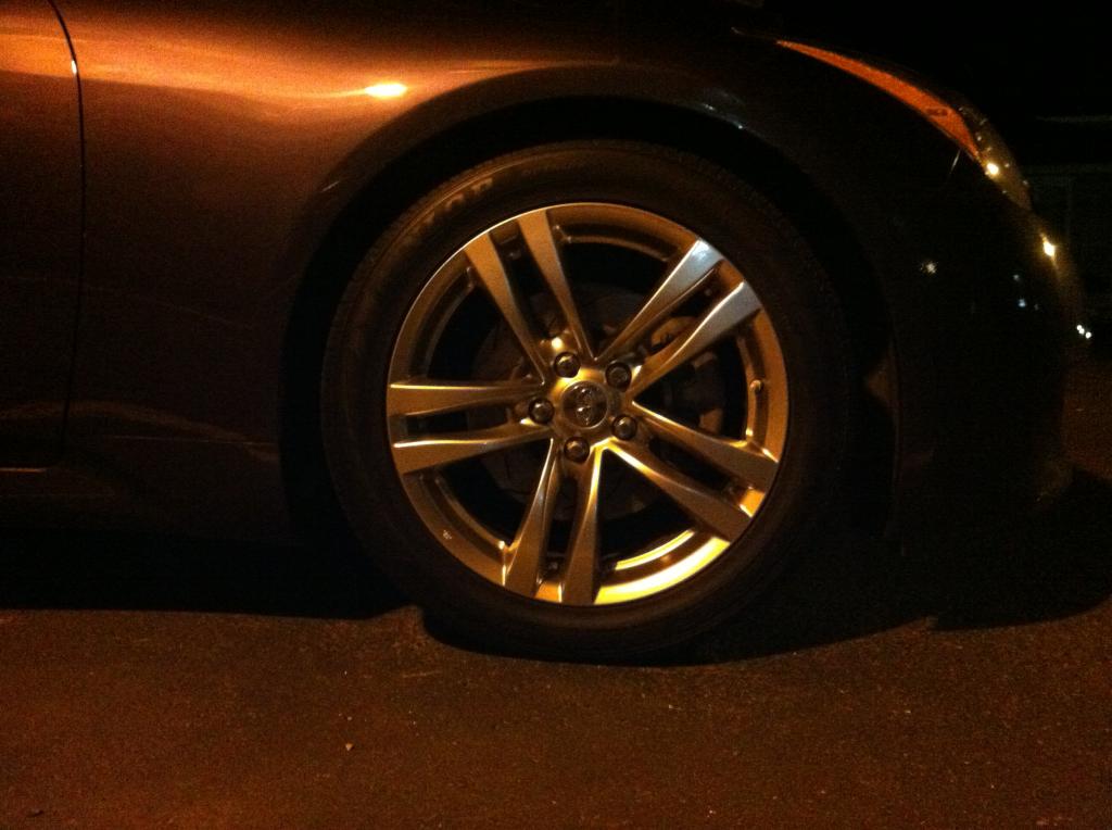

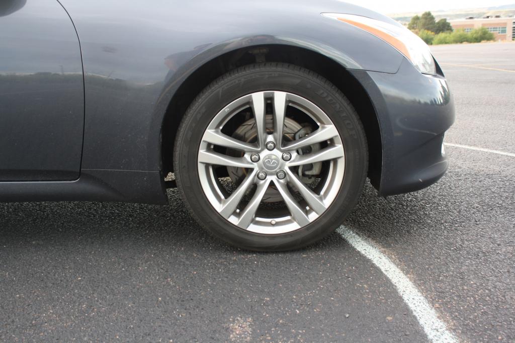

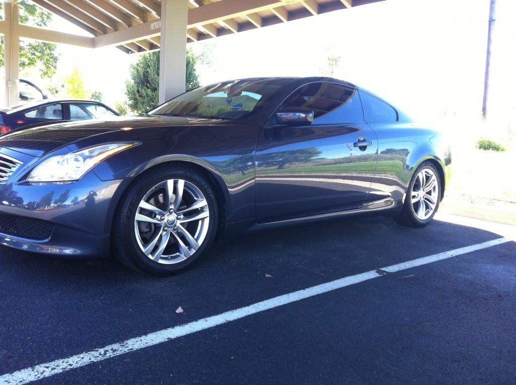

Ride Height:
I chose to lower the car only minimally as I need my car to be drivable at heavy snow conditions. Originally, the ride height from the ground to the top of the fender was 28.75” but now I stand at 27.5” which is 1.25” lower than stock height. This is a mild drop yet the car looked more aggressive. My friends were able to notice the drop. It is more prominent in person than in pictures. This is probably the least drop you can get from the coilovers, the most would be an extra 2.5” drop, which should completely get rid of the wheel gap.
Before:
After:

Good news and bad news. The good news is I got my SPC front and rear cambers kits installed and everything is spec with current ride height at 26.8" all around. Bad news is that even after cutting out the top isolator and bending the tabs back to the way they were the sound in the rear did not disappear. I am now sure that the metal to metal contact between the spring and the height adjustor is causing the noise. I will try and get some bushings to reduce the noise. once I get them installed, I will update this post.

Packaging:

The X seems to have a different rear upper spring pad, mine didn't have those clips for the rubber spring cones. Too bad you had issues w/ the fit w/ those clips, I guess that's the price you pay for being one of th efirst to give these a shot.

Are you sure your suspension noise is not due to the rear spring top isolator issue? What did Andy say is the solution for that? I hope the next kits out will have that issue resolved.
