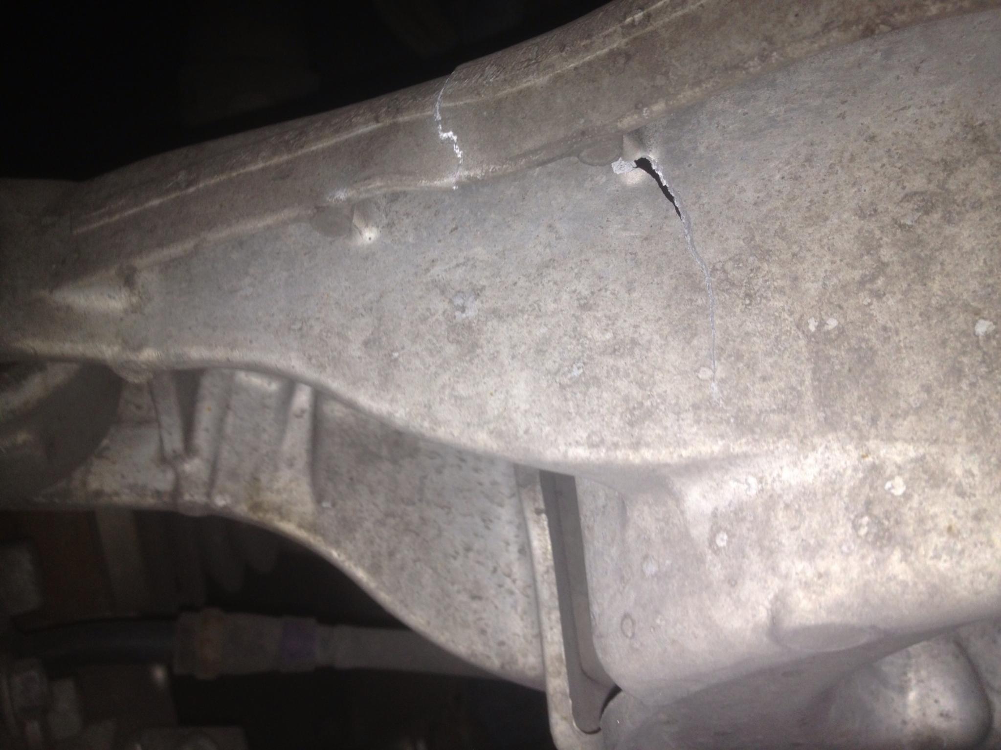

Hit a curb please help me figure out what part I broke
Old Jun 16, 2013 | 09:39 PM
Drewmoore29's Avatar
Drewmoore29
Posts: 3
From: Colorado
I slid into a curb ruined my wheel and tires and did a number on a part I'm not sure what it is. Kinda new to the mechanic thing.. Please help
Attached Thumbnails Hit a curb please help me figure out what part I broke-image.jpg

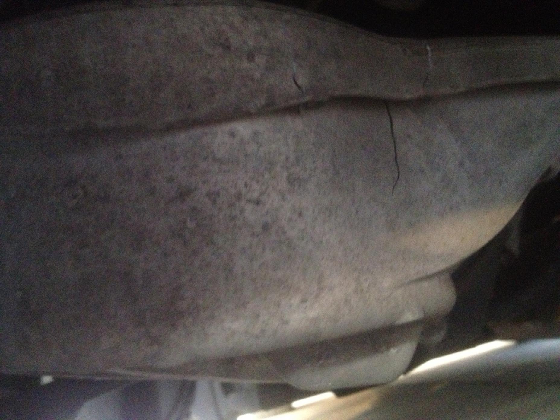

Another pic
Another pic

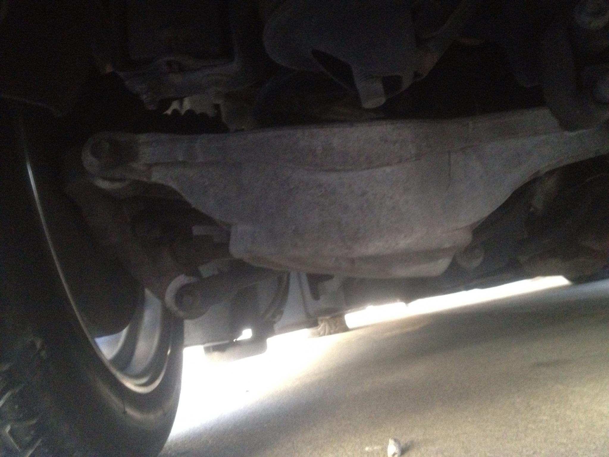

It's on my left rear tire
No luck googling part
Old Jun 16, 2013 | 10:08 PM
SmoovE's Avatar
SmoovE
Joined: Aug 2008
Posts: 58
From: Brooklyn, NY
That would be your drivers side lower control arm.
Old Jun 17, 2013 | 09:10 PM
Likes: 4,951
And that will be pretty expensive Those rear spring buckets are pretty tough, must've really smacked it good.
Actually cheaper than I thought, DicountInfinitiparts has it for $152, and luckily it's pretty simple to replace.
http://discountinfinitiparts.com/par...iagram=3846475

Look for lower control arm, spring perch. There's a bunch on ebay.

this perch also acts as the toe adjustment, make sure you dont drive it 'til you get it replaced and get an alignment after you get it replaced.
let your mech know what happened and he should be somewhat familiar with what to look out for. e.g., it's possible to damage your wheel bearings from curbing your car and he should be checking for 'play' in the suspension

OP, buy a used lower arm and replace it. Have it thoroughly checked out be someone experienced with suspension to make sure nothing else is damaged, it very well could be. Consider it a lesson learned.

I've repaired a problem like this, mostly replacing the camber arm, toe arm and spring bucket should fix 95% of it
