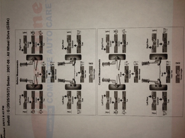

It has been a few months since i have installed the springs 2nd alignment i had done and this is the results (camber kit needed for the fronts at least)

Did you have a camber kit done for the rear?

none i figure i just need to find a good kit for the front but idk what is good price for a front kit.

You have got a bit of toe in the rear. A little bit of camber is fine, however toe is not good for tires.

Assuming the X uses the same camber setup the RWD front set is about $325-350, rear toe kit about $30, rear arms about $150.
Got my F&R w/ toe from THMotorsports (vendor on this site) for about $520
a while back.
Agree about the toe being more of a concern. Even the front camber being out like it is shouldn't cause crazy wear compared to your rear toe where it is now. If you were to do one thing right now I'd get the rear toe kit if you can't swing the whole set right now.

Boywdr, take this for what it's worth.
If the Swift on an X drops an equal amount from OEM as does the Swift for RWD, then you should be able to get that toe in spec.
Reason i say that is when i had the BCs, the drop was equivalent to an Eibach drop, which itself is lower than Swift's drop. My alignment shop was able to get toe back in spec with camber hovering in the -1.9 to -2.2 range. Never experienced any type of odd tire wear. All OEM adjustments.
For the rears, especially, ask them to add more camber, that'll reduce the toe. Camber doesn't hurt, toe does.

you are 100 right i am going to find out how much more camber i am going to have to do to get it right and that should buy me some time to get a good deal on a full toe and camber kit.... did you have to get either with your BC's??

On an Eibach-like drop? The toe was within spec, camber could not be coaxed. I eventually got the alignment kits for peace of mind but the downside to having much less camber also translates into a little less corner handling. Give and take.

well I had a great talk with a firestone manager last night and he asked my to bring it by his store (a different one) and will have one of this best workers look at it i am just trying to have them buy me some time to get my hands on a kit to i can get this out the way.

I wouldn't be surprised w/ the right tech doing the job they'd be able to get it in spec. Amazing how different an alignment can be going from shop to shop or even mechanic to mechanic within the same shop '
Good luck, it would sure be nice to use the $500 for something else.
