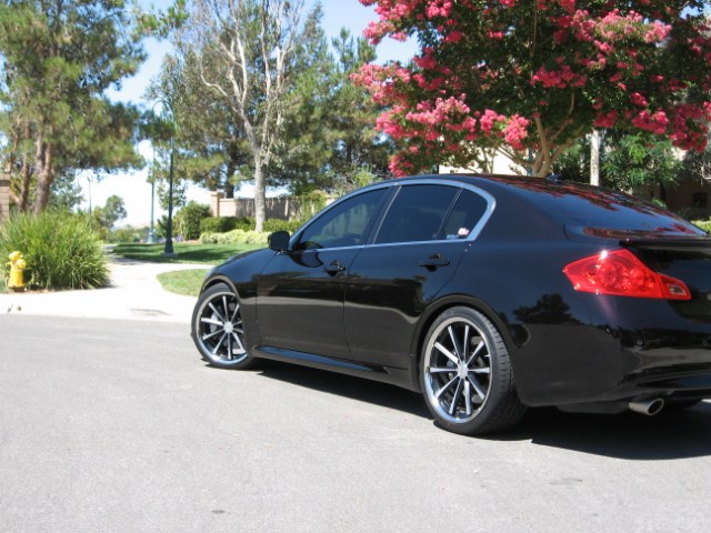

Originally Posted by jhenka
After getting coils you will most likely need to roll your fenders, get a camber kit (depending on how low you go).
Not so. I have KW's on my car with a conservative drop. No camber kit, and I didn't have to roll my fenders.
My camber is -1.8 all around and it only rubs slightly if I hit dips fast. After 8k miles the tires seem to be wearing well. YMMV.
