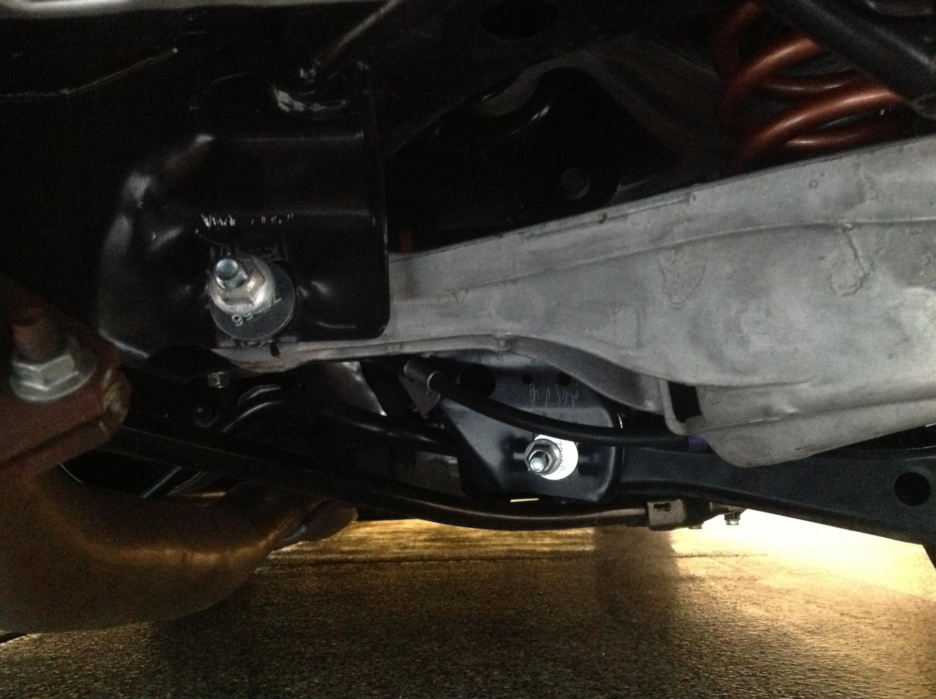

I installed the SPC camber and toe bolt kit.The part #72265 2007 & up G35.The rear is lowered around 1 3/4" from stock.With the bolts I gained +1.3 degrees with keeping the toe in spec.My rear camber before was at -2.1*,Now I am at -0.8*.I went through a set of tires in 8000 miles.I am waiting for a set of front camber arms,After I install then I will do another alignment and post the before and after alignment sheet.This is the only camber fix for us vert owners can do at this time and I am happy with the results.

Here are a few pics.I did the install at a friends tire shop.I used a air rotary file with a carbide filer bit.You have to remove the sway bar to get to the camber bolt hole.Total install took 3 hours.I would not even think about doing it on the ground.A lift is a must.

A couple more...
