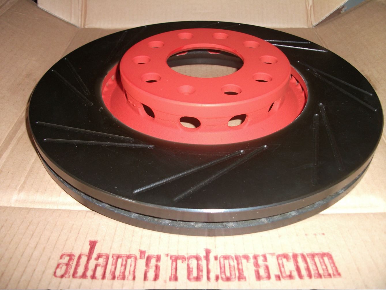

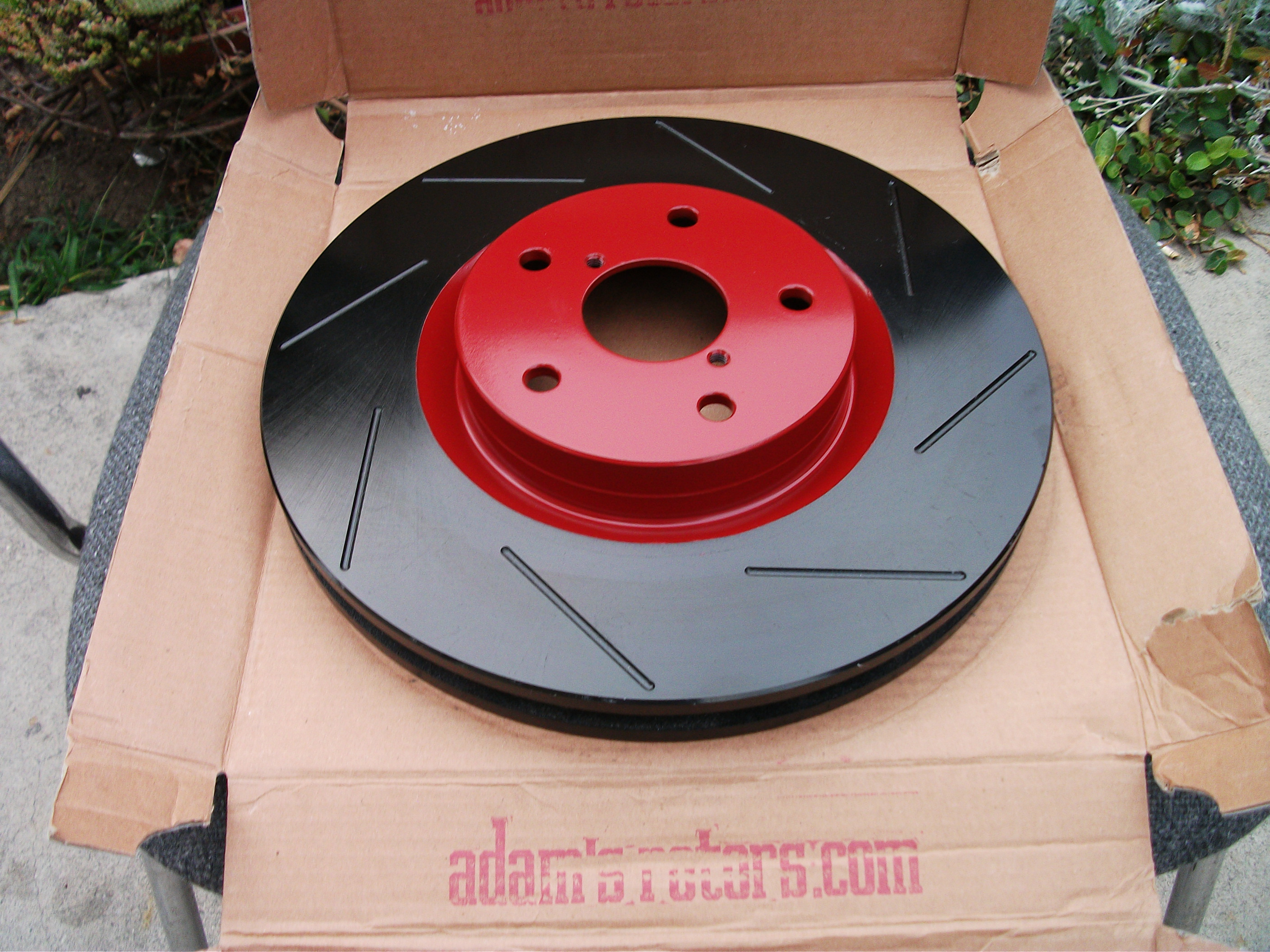

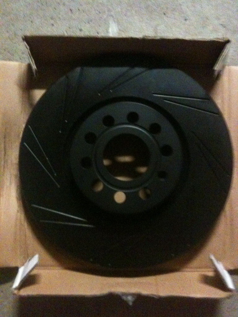

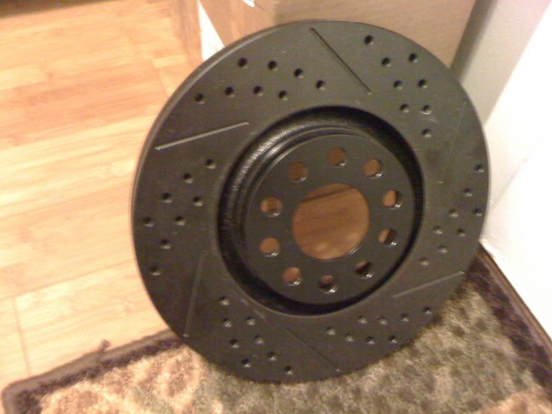

he's some of our customer delivery photos:
