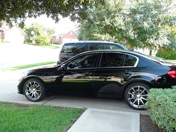

I'm interested in dropping my G37 but i know NOTHING about dropping other than it lowers the car and makes you slow down to 1mph to drive over a dime. Can somebody describe the process, the cost, the pros and the cons of dropping/lowering your g37? Id like to know how much it costs, how long it takes to get done, if it affects the performance of the car,and how does it affect my warranty?
Thanks guys.
