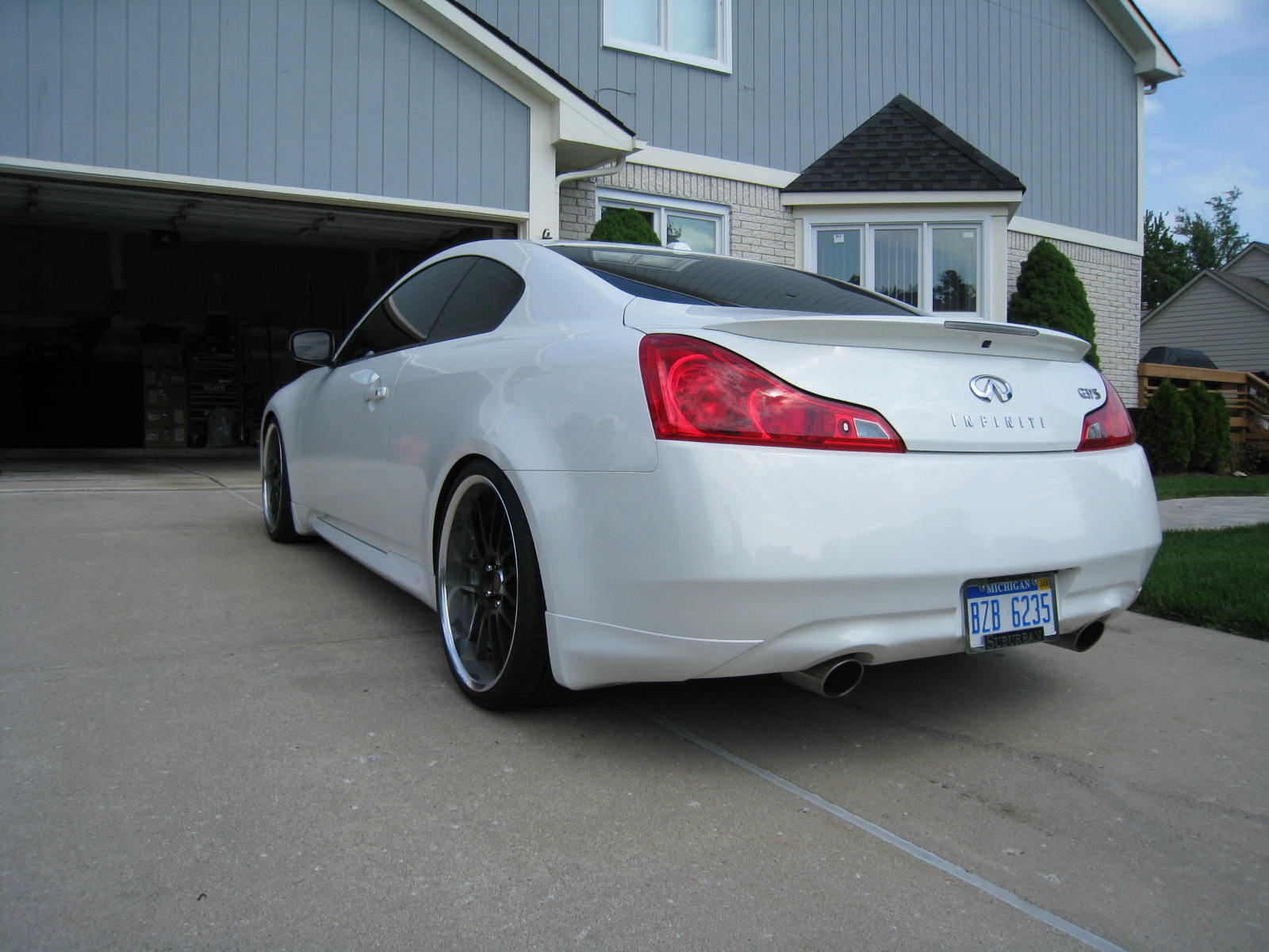

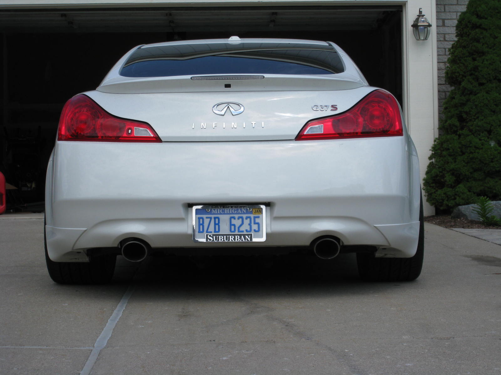

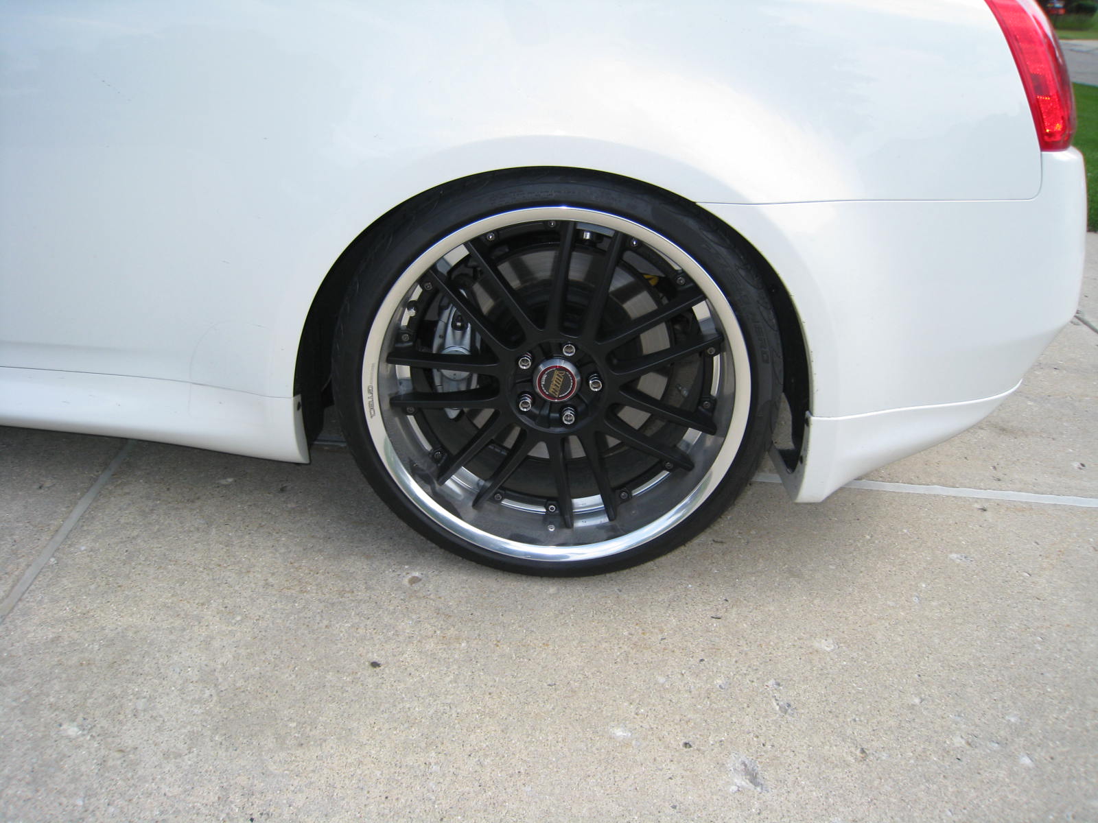

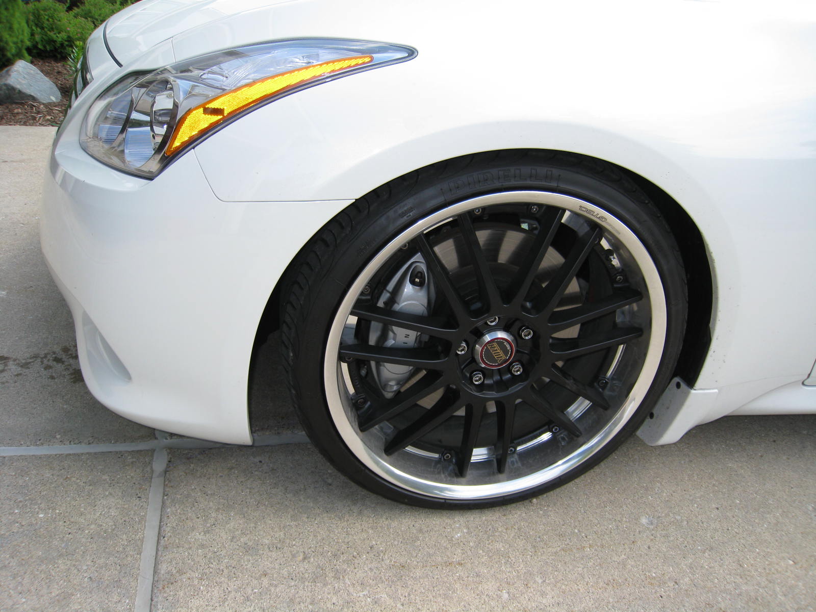

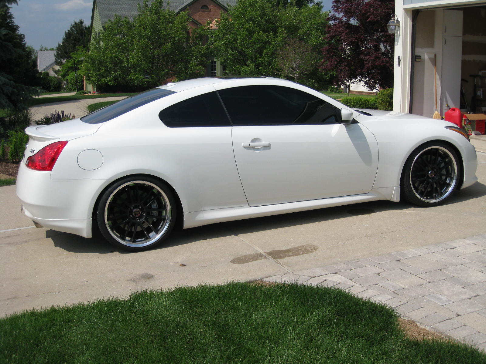

Just picked my '09 Coupe from MRT in Plymouth, MI. Chris took care of me great and Josh did a sweet job working on my vehicle. Highly recommended if you're in the area. PFizzle refered me.
Anyways, you read it right... GT30's 20x10.5 +37mm offset w/ 305/25/20 Pirelli PZero Nero Tires dropped on KWv3's (about 2" front/1.5" rear) w/ SPC rear camber kit and alignment done. Looks sick, rides great, and NO RUB. I am definitely going to get the SPC front A-arms now because the front now appears sunken in compared to the rear stance.
Tell me what you think...

Can you please post your alignment specs? Thanks.
Congrats on getting it to work!

What size is your front tire ??

Originally Posted by pfizzle
So damn nice. Josh is the man. How do you like the ride?
Specs:
Front: Left
Actual: Before: Specified Range:
Camber -1.8 -1.9 -1.2 to 0.3
Caster 5.5 5.5 4.1 to 5.6
Toe 0.04 0.03 0.00 to 0.08
SAI 8.5 8.5 6.7 to 8.2
Included Angle 6.6 6.6 5.5 to 8.5
Turning Angle Diff. ----- ----- -----
Front: Right
Camber: -2.2 -2.1 -1.2 to 0.3
Caster: 5.4 5.4 4.1 to 5.6
Toe: 0.04 0.05 0.00 to 0.08
SAI: 8.9 8.9 6.7 to 8.2
Included Angle: 6.8 6.8 5.5 to 8.5
Turning Angle Diff.:----- ----- -----
Front:
Cross Camber: 0.3 0.2 -0.6 to 0.6
Cross Caster: 0.1 0.1 -0.7 to 0.7
Cross SAI: -0.5 -0.4 -----
Total Toe: 0.08 -0.02 0.00 to 0.16
Cross Turn Diff.: --- --- -----
Rear: Left
Camber: -1.5 -1.5 -1.8 to -0.8
Toe: 0.14 0.95 0.00 to 0.22
Rear: Right
Camber: -1.8 -2.3 -1.8 to -0.8
Toe: 0.14 0.29 0.00 to 0.22
Rear:
Cross Camber: 0.3 0.8 ---
Total Toe: 0.29 1.24 0.00 to 0.44
Thrust Angle: 0.00 0.33 ---
255/30/20. *Needs SPC Front Upper A-Arm camber kit.

Have you tried a full tank of gas and a medium to large road bump a speed? Perhaps the KW coils don't compress as much as stock suspension and makes the difference then. Hoping for the same effect with Tanabes.
