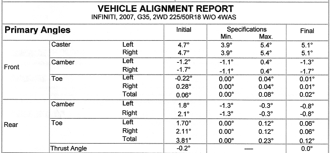

Final Results
I've been a little slow at posting final results, but here they are.
Front: 26 3/4. No change from first install.
Rear: 26 7/8. Initially 27.
Note per my other post, the right rear side was and still is about 1/4" higher than the left rear. A couple of others have reported this as well.
Had alignment done at PTuning in Manassas, VA and I attached the results. Notice that they used specs for 2007 G35 with 18". I am not an alignment expert so anyone know if that is a problem?
Front camber is out of spec, but nothing I can do until SPC releases a front camber kit which is supposedly in the works.
I really like the ride so far.
Attached Thumbnails Eibach Pro-Kit Results....Close-Up Pictures of Results-alignment-g37.jpg

Here's the specs for the G37S. Someone complained once about uneven tire ware, according to the guy I talked to at this High Performance alignment shop, inner tire ware is normal on this car, if you'll notice negative camber is a specification and desgin element of this car. It's too be expected.

Thanks for the specs. Looks like specs between G35 and G37 are only slightly different. Good news is that I compared my results against your specs and it appears I am still in tolerance except for front camber.
