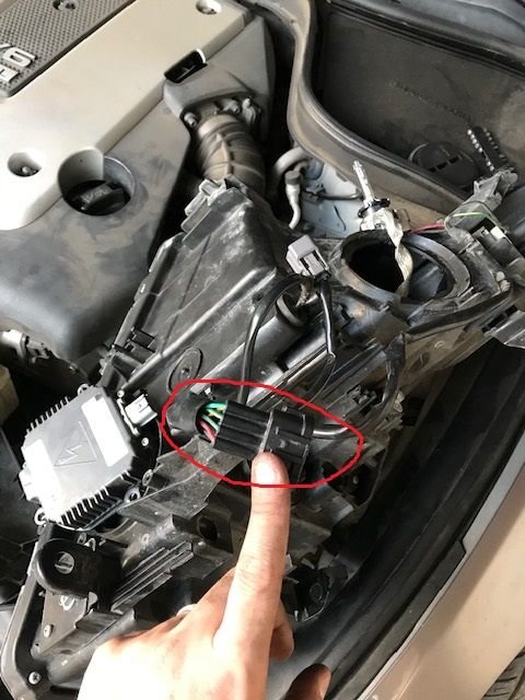

The third time I decided to see if this part in the bottom was causing the headlight to not work.
So i decided to plug this in the left headlight cord, photo shown:
When i turned the headlights on, the right headlight worked so clearly the passenger headlight assembly was fully functional.

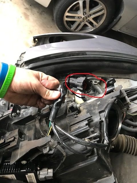

Then i tested the left headlight plug shown below:

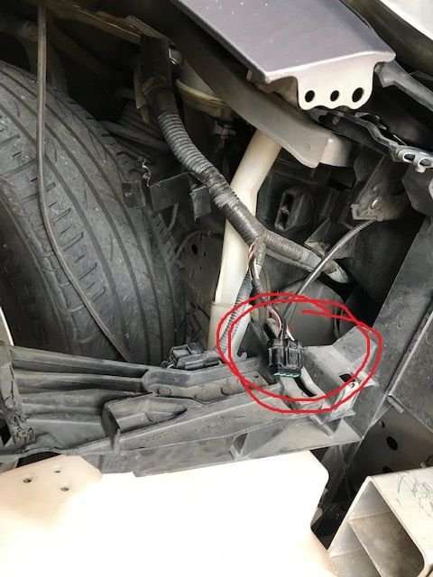

On to the passenger headlight plug:
THE HEADLIGHT DID NOT WORK! The fog and blinker does work however!
My guess is this plug shown above is what seems to be the issue to not turn on my right assembly headlight.

I hate to ask the obvious but did you check the fuses and relay before you undertook this endeavor? I have not checked in our cars but some cars I've worked on had independent fuses for each lowbeam headlight as well as each highbeam. It just seems odd that the part you have identified is faulty. You may want to multimeter or powerprobe test the part before concluding it has gone bad but I would check fuses and relay if you haven't done so.

No I did not, and even my wife said to check the fuses lol. Ofc, I never checked fuses on cars before so I was just naive to check this one. Now that I decided to look at diagrams and how fuses and relays work I checked the fuses and sure enough the H/Lamp Low Right was actually blown. I replaced it and now the headlight is working. This is why i decided to join the forums to learn about what to do if my car has issues.
