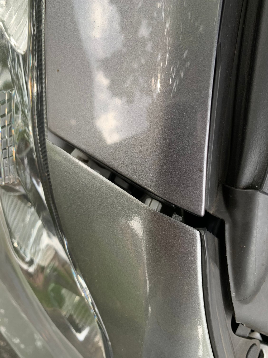

Hey guys, so I’ve recently bought a new front bumper for my 2014 Q60 because my old bumper got damaged and these clips/tabs or whatever you want to call them isn’t fitting right and into the holes that holds it in place for it to be flush with the car, this is for both sides. I've zipped tied one of the sides but it shows a gap which looks bad so I simply just didn't want to do it for the other side which is shown in the picture. If anyone knows how I could fix this that would be much appreciated. Its not that big of a deal but it just bothers me because it looks ugly af. Thanks in advance guys!

There should be bolt right there to make that sit flush iirc

There's a bracket that you should be able to take from your old bumper or just zip tie it.

Does anyone know what that bracket's called or have the part # for it? I've got one on mine with the line up pins broken off.

I did the same conversion on mine and everything fits perfect. when took off the bumper to install my intakes. i broke the bracket so it looked like that for a while. i ask my wife and her tiny hands to help me threat a screw and nut from the bumper to the fender. that fixed it and i feel its holding even better than before. if you have the original bracket maybe you are not lining up all the parts right. double check your work. its a tight fit so it misaligned easily.
