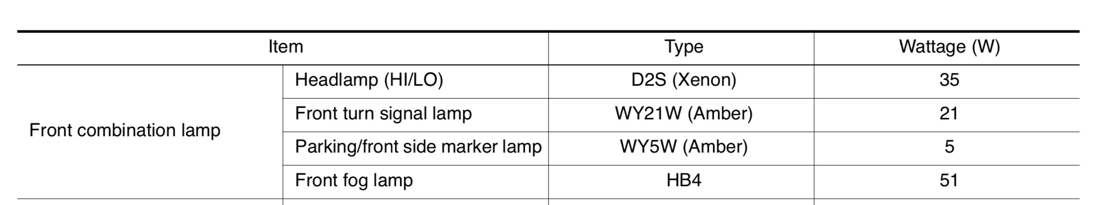

These are the bulbs for your '09. The fog light is an HB4 halogen (which I think is also called a 9006?) but the main headlamp (hi and low beam) is a D2S xenon.
The fog lights will only operate with the low beams and will shut off if you switch to high beams. It sounds like you may have some crossed connections going on...
