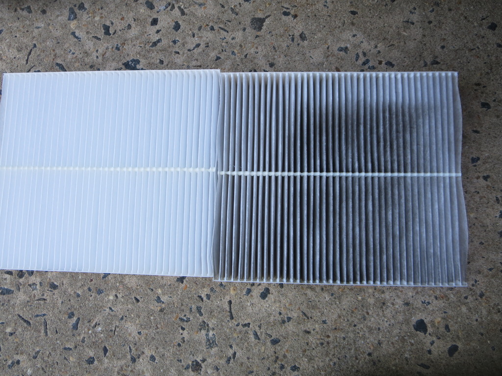

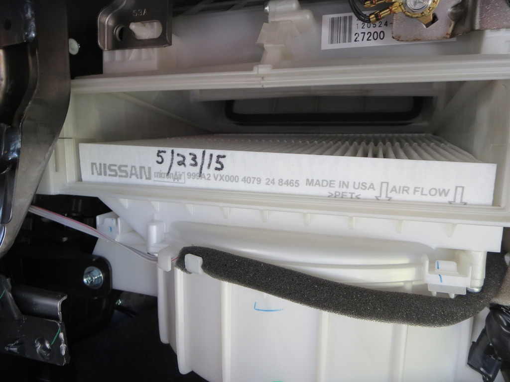

I have to wonder when the last time the op changed his?
I change mine once a year.
Easy to do. Takes about 15 minutes
