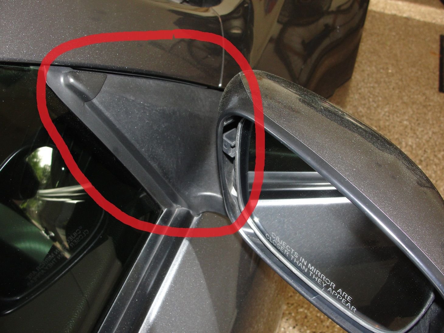

This area of mine is a bit beat....trying to restore to new but is this some kind of plastic or is it painted? Anyone have this problem...? Searched could not find ....thanks everyone!

Mother's Back-To-Black will get all the oxidation off.

Cool so its plastic...I will try out the back to black...my past experience with it was it removed light oxidation but then faded after a couple of washes.
I remember using this too...worked great. Its like a chemical so it does not fade.
I think I will hit the area with a magic eraser to get some of that oxidation and than try both.....
Stay tuned I will post up some pics of the results...
i use it to get all the funk off, then follow up with a good protectant.
the key to using B-to-B is doing it in the shade (part should be cool). do it in the sun, and its streak-city.

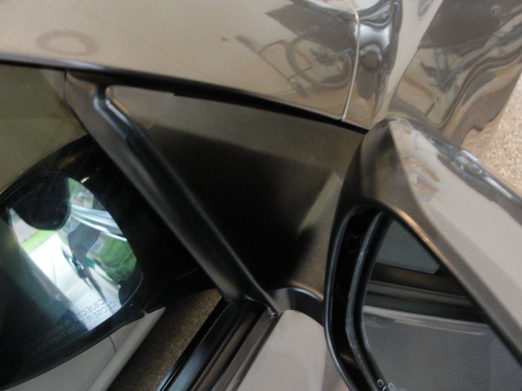

Just used wipe new....this stuff is no joke! Its like a chemical coating and it works! I will follow this up with some 303 or back to black but I scrubbed it with a magic eraser, cleaned with alcohol and then the wipe new. This does not fade it is more like a chemical that is rubbed in and is like a clear coat....
